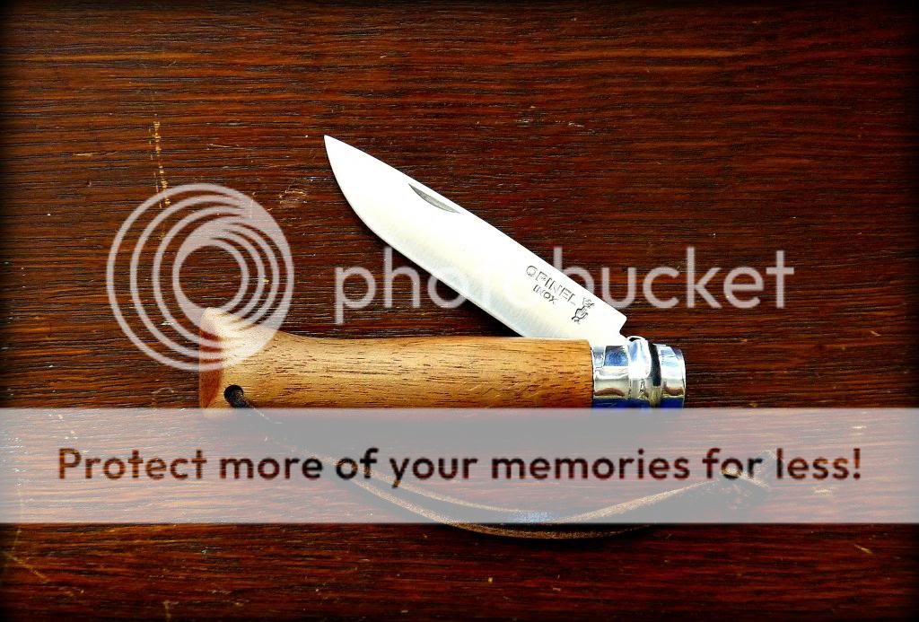

That all depends on which one you like more. You can easily patina a carbon blade with an apple or something, but not an inox. But then the inoxs don't rust very easily. Also its fun to drop point the blade. I think they look pretty good that way. Heres one i gave away a little while ago.
