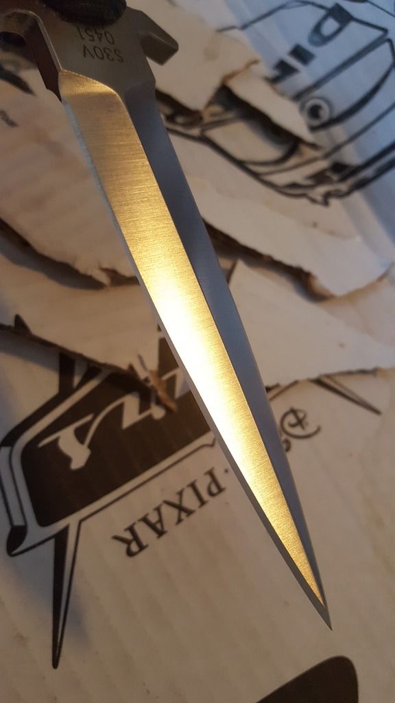

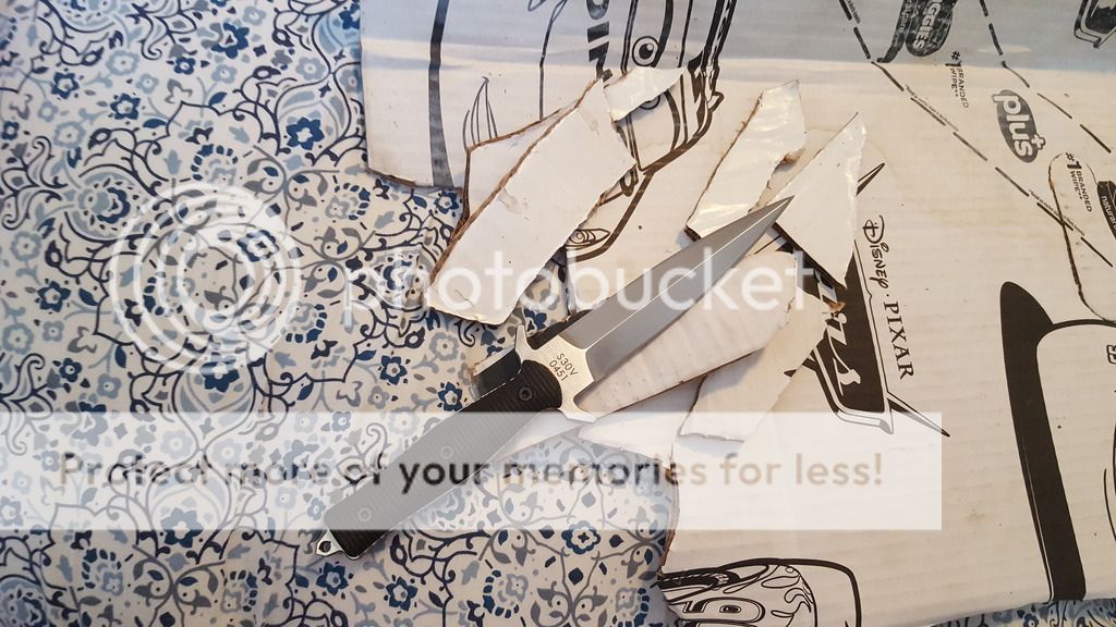

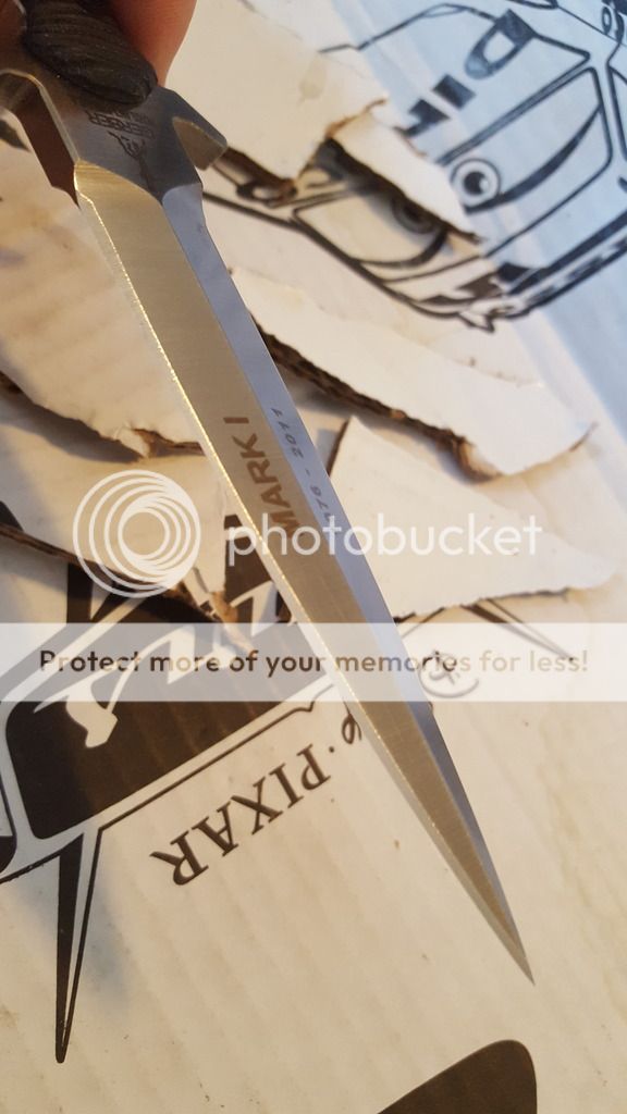

I don't see what's wrong with S30V. I just did a few slices into carboard and I don't see any blade damage. Either you got a defective piece or Gerber stepped up their game when my commemorative dagger was made.
Gaston is trolling. Or he doesn't know how to properly sharpen CPM steels and blames the steel.:rolleyes:
Pay him no mind!:poop:
