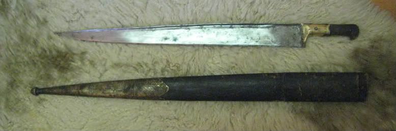

The "butcher-knife of the Khyberee" is a sort of overgrown Forest Bowie, with a point designed to split the links of a mail shirt. In the Khyber pass, Mr. Atkins also learned more than he wanted to know about them.
I have no idea what Indian “Act” Mookerjee and Hla-oo and Singe invoked.
The Khyber knife is also known as a pesh-kabz or a choora. Some examples:
These pictures show the ridge along the spine. It adds the extra stiffness that helps spread ring mail armor. Something Jim Bowie never had to worry about.
I though the choora was the smaller, but similarly shaped, companion dagger. Am I mistaken?
As I understand it "choora" is sorta a catch-all term for that specific design, ranging from the size of a small dagger to a short sword.
