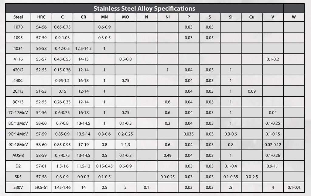

I know you pay attention, but for some reason you have an agenda to smear for some reason, brands you don't like based on emotion. I've already shown you the Schrade 1095 has a heat treat of 57-59 HRC. That's not unknown. I can even verify the information I provide with the information sent to me by them.
So what's so unknown about that? 1095 is 1095 and it looks like your unknown heat treat claim just went up in smoke. How do I know their 1095 at 57-59 HRC because my knife didn't come out of the box looking like this.
notice a difference between your posts and mine? That unknown (to you because of a lack of research on your part) heat treat is now known, just like the last time I showed you to the masses.
your next post will need to concentrate on something else now. Forget your debunked heat treat claims. Maybe go after fit and finish like the scales don't match up perfectly and my SCHF37 had a bit of a uneven grind for 1/16" right at the tip that I easily fixed and the powder coat is the worst powder coat I've seen on any blade. While evenly applied the powder is junk. The steel though, it's real 1095 at 57-59 HRC and it performs like any other knife in 1095 at 57-59 HRC. The SCHF26 had a perfect grind out of the box but the scales fit is a tad less aligned than the F37 the coating on the F26 is so much better though and they are ditching the powder coat on their next new designs.

So posting an Hrc number for a steel shows the proper heat treat was done.....
You know, the part of the Rockwell C hardness that involves little things like normalizing, annealing, hardening and tempering etc. :foot:
