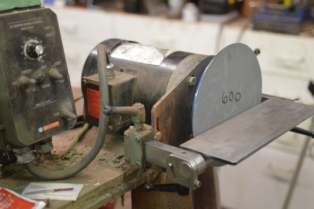

Why do I need VS disc sander?
Well that's interesting Josh, "you will get a (very small) hollow using a beveled disc"! How's that happen? To be honest I mostly always make smallish hunting knives anyhow with the exception of some larger kitchen knifes.
The bevel disc is designed so that you don't catch a large blade on the opposite side of center where the disc is spinning in the opposite direction. It does create a micro hollow grind which Rob of Beamont Metals calculated to have a .0005" concave depth over a 1.5" surface. It's not at all noticeable. I lot of makers say they have no problem using a flat disc, but I like the 1° bevel just fine.

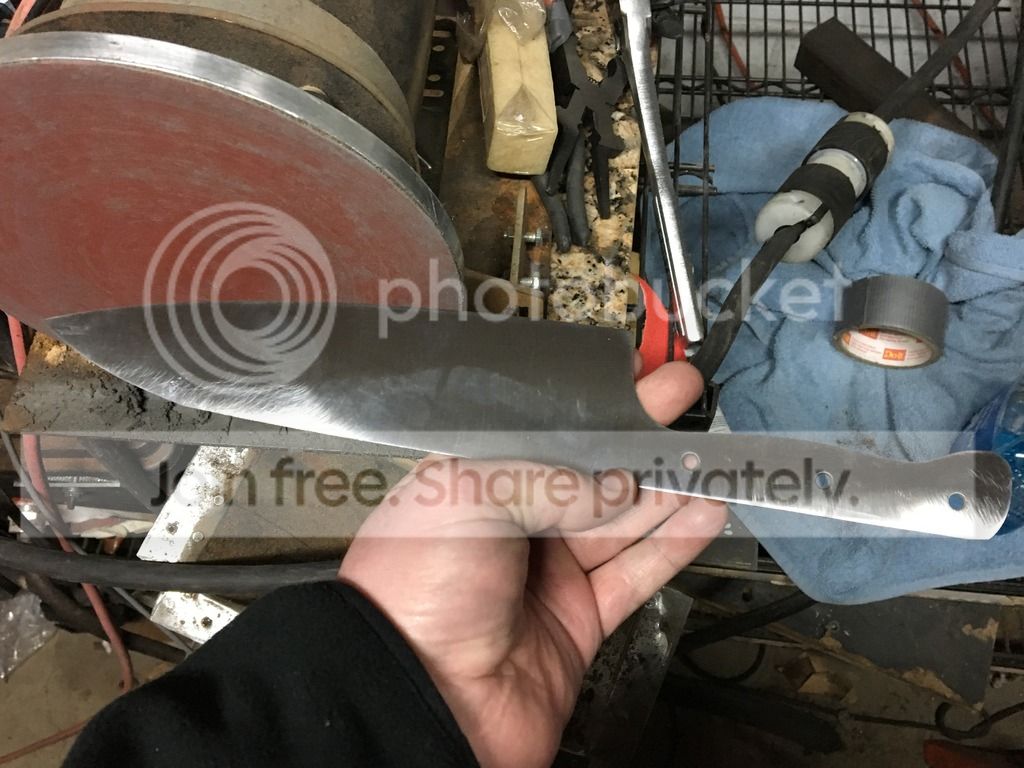

The disc is a cone. Even with a 1 degree taper, it's still noticeable. Not too hard to hand sand out and less evident if you rock the blade, but I wanted to be more efficient at sanding so it only made sense to me to get a flat disc. If you paint the blade with dykem after you grind with the disc, then hand sand, you'll see the dykem in the middle of the blade. I ended up trading mine to a member here. I was working on a chef knife today and once you practice a little, you won't worry about it crossing center. Keep your pressure on the side you're working on.

Flattening the bevels on a disc after the belt just makes hand sanding faster. If your not going to hand sand, there's not much point.
I'm still confused why a 1 degree bevel causes a "hollow" ground on a flat disc. I'm close to ordering but would like some more input of why?
Think about if it had a 30 degree bevel and you'll get it.
I started out with a flat disc but later kept hearing the benefits of a 1 degree taper disc and so I bought one and used it for about six months. I did not like it and felt that I had less area to use for flattening. I sold it and put the flat disc back on. Later I bought the Rod Neilsen interchangeable disc system and have both the original and the newer thinner discs. I use my disc grinder on every knife at some point and I like the flat disc best. Other knife makers like the 1 degree discs so it depends on your own experience but I would suggest the flat disc first. Just my opinion based on my own experience. Larry
If you have a tiny bit of distal taper on your longer blades the tapered disc is not necessary.
The point of the knife isn't on the disc past the center point.
I use a flat disc and find no reason for a tapered disc.
The little bit on bevel sanding I do on my disc is usually done across 10 o clock and 2 o clock or a bit higher so flat works best for me as well.
Even grinding on a flat disc can produce a slight hollow if you're grinding on the outside edge of the disc and not holding the blade parallel to the disc. The benefits of a variable speed disc are tremendous in my opinion. I use my disc more than my belt anymore. I use it to dovetail bolsters and handle material, flatten blades, smooth blades after surface grinding, flatten scales, square guards, square spines, just about everything that needs flattening or shaping that isn't a tight radius. The biggest thing that has helped on the disc for me is purchasing a rubber backer from K&G. I haven't taken it off since I glued it on.
For me, the disc is a great shortcut for finishing non-ferrous stuff, and a safe way to shape wood. It doesn't go too fast, and it gets me from rasp and file marks to flat and ready to hand sand. Long sheaths, handles, etc.
Also, when a knife has metal bolsters, the disc keeps the metal and wood in the same plane. You can get them both to 400 grit on the machine, and then take the wood to 600 or 800 and not remove enough to screw up the transition. Going up through each grit by hand on both, it is so easy to screw up the transition and take too much wood.
