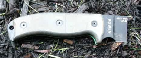

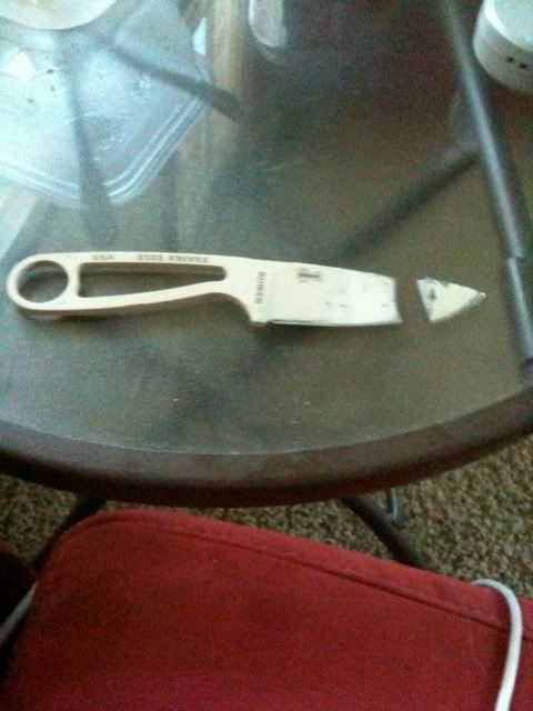

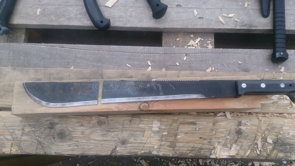

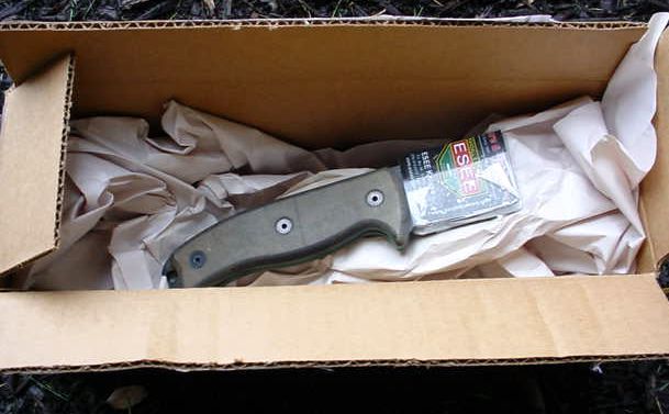

I think I get what you're saying. You want something visceral, personal and ultimately meaningless:
My personal favorite:
When reason fails, we always have anecdotes and emotion.
Did esee replace all of those?
This means zero.
It's steel, it can fail.
Whether is was used beyond it's limits or there was a manufacturing issue with these examples, it happens to everything we make, not just knife steels.
Out of context pictures with no story behind them do not account for a negative, especially when you take into account how many knives out there are made using 1095.
