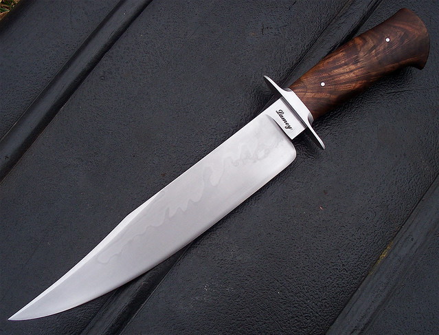

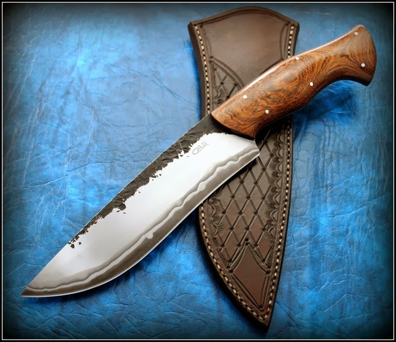

Yes, you're right....
A more expensive steel should be used like O1
These 1095 blades are terrible knives.
Clearly an expensive knife such as that one (and this one) deserves a better steel than 1095. Don't those knifemakers know that a better steel should be used?
Neither of those are "Art knives".
Just because they're artistically made doesn't mean they're art knives.
And by attacking a steel, you attack all those who use the steel as a basis.
I never said it wasn't tough. Just that 1095 is tougher. I still think that. Part of the reason for that is that it can be differentially heat treated easier.
You still haven't told anyone why one alloy is "Better" than the other one.
And if you qoute me. Please qoute me properly instead of trolling by swapping the pictures. I'd do you that courtesy I'd expect the same from you.
It's not actually. You're telling everyone who makes knives in that steel that they're cheaping out.
And this thread was pretty stupid to begin with.
