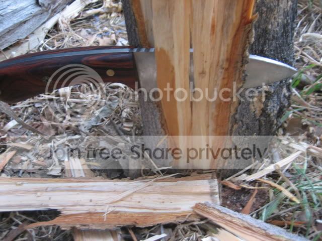

Okay - I got the spoon on the head tonight.....So I made this poor excuse for one with this log....
1) Wood that is wet on the outside may be dry on the inside. Batonning/splitting wood reveals the dry interior.
2) Splitting wood x2 creates a sharp edge (a wedge in cross-section) with more access to O2. Easier to get split wood to light and burn.
3) Round logs often don't burn efficiently, but sort of smolder. Split the same log and it will burn hotter. (because of reason #2)
I usually collect the "small stuff" and it will burn okay--but when I am starting a fire, I'll even split/baton some small stuff to get those sharp edges. These split twigs catch more easily and burn hotter.
Fire good. :D
