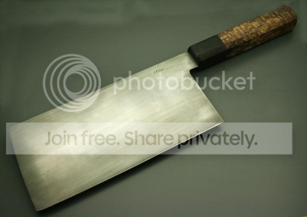

I agree forging is fun and has some bennefits with regard to being able to use larger stock, which is also usually alot cheaper. I have paid one dollar per pound for w2, l6 and o1. I also really like the dramatic change of form that is possible. Here is an example:
The cleaver is less than 1/8 inche thick at the spine.
