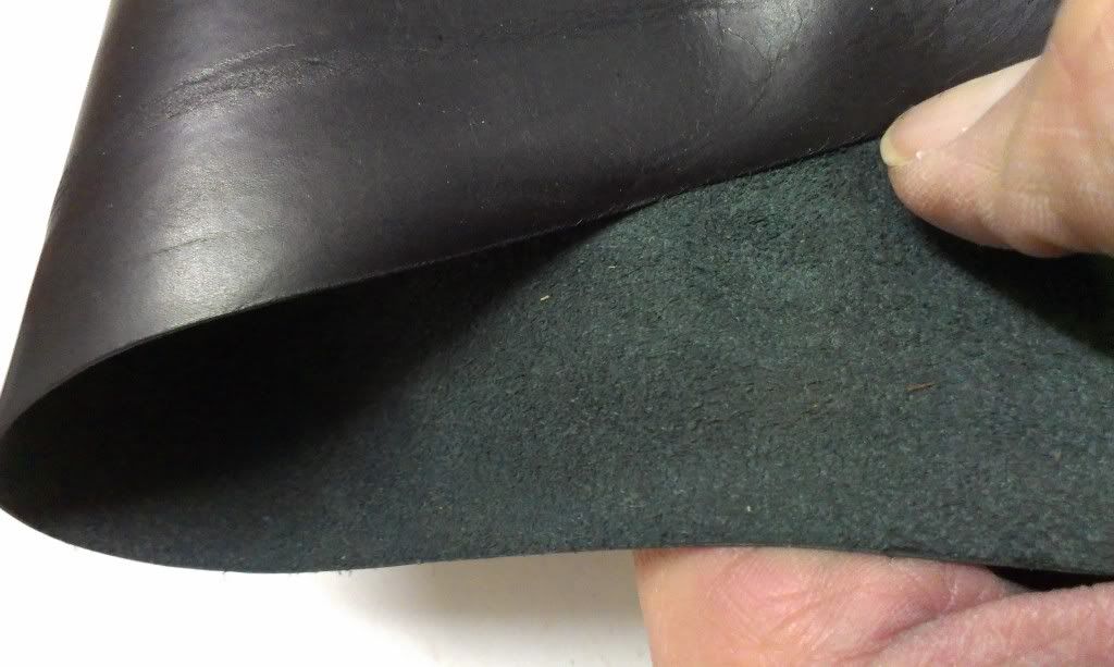

It is black. Well sort of... More like a very dark green.

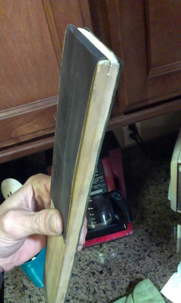

David, I'm sure you've seen this pic, but I really like the slot that I cut at the top of my strop. It makes holding the sandpaper easier.
Looks like it would hold it nicely. :thumbup:

I think the colored leather won't actually be veg-tanned (probably chrome-tanned). Veg-tanning, as the name implies, uses natural tannins (vegetable or bark) in the process, and will leave the leather 'tan' in color, or some variation of a more natural brown. Having said that, when used with compound, it often won't make a significant difference anyway. The nap and softness/firmness is what matters, and the compound will be doing all the polishing. The chrome-tanning process is known for stripping much of the natural silicates (abrasives) from leather, and so it'll make a difference on strops used bare (without compound), rendering them much less effective. Veg-tanning leaves the silicates in place, so strops made this way will be more useful if used without compound.

Oh it's definitely leather.
Veg tanned comes in black too. Actually you can get it in several colors. I need to grab a scrap to burn. The ash tells all... Green = chrome while Grey = veg.
It better be veg though. That's how it was labeled, and I spoke with them specifically for this reason since I bought it to make my sheaths. Well, parts of my sheaths, obviously it's too thin for a knife sheath. I bought this hide, and others at a local Tandy leather store.
Unless you work with a lot of leather often, that's a common misconception too. You can purchase vat-dyed vegetable tanned leather in almost any color and thickness. It's more stable (color-wise) when doing intricate tooling. Stamped or compressed leather often doesn't accept dye as smoothly as uncompressed leather so people needing a tooling leather with a very even coloring will often buy pre-dyed hides.
Kinda looks like Pleather :D
It's quite possibly a top-grain split. Imagine if the leather were an inch thick... The grain side has a very tight cell structure, is strongest, and smoothest. If you slice off the top 1/4" of the hide, you have a top-grain split. Using the rest would be a split-grain. But if you sliced off the bottom 1/4" and buffed both sides smooth, you'd have suede. Not very strong. Not very water resistant, but soft as butter. Now, scale all that down to a hide that is 1/4" to begin with. Slice of that top-grain split and it would look like what's in that photo.
