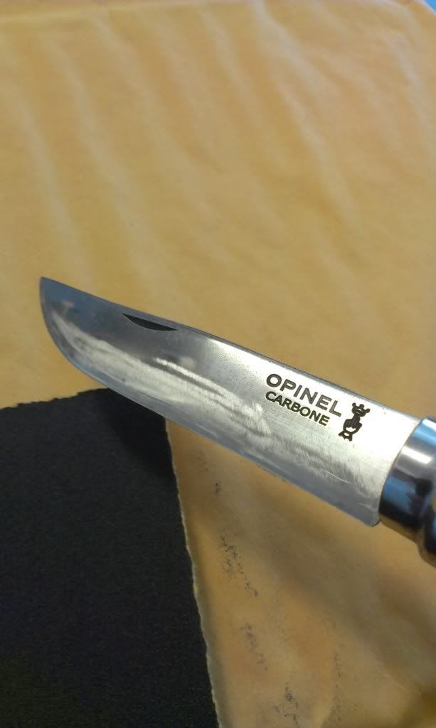

Rather than start a new thread I'm just going to report a new finding here...
And that is, once you get a bevel down to the teens (inclusive) the whole shebang gets wacky!
I took my No. 8 as far as I can realistically go in terms of edge accuteness. I can only guess as to what the angle is. I know that each side is well below 10.
I ended up taking a few really random pics.
The "project" has been an ongoing process for a while now, as I'm trying to pass a successful HHT.

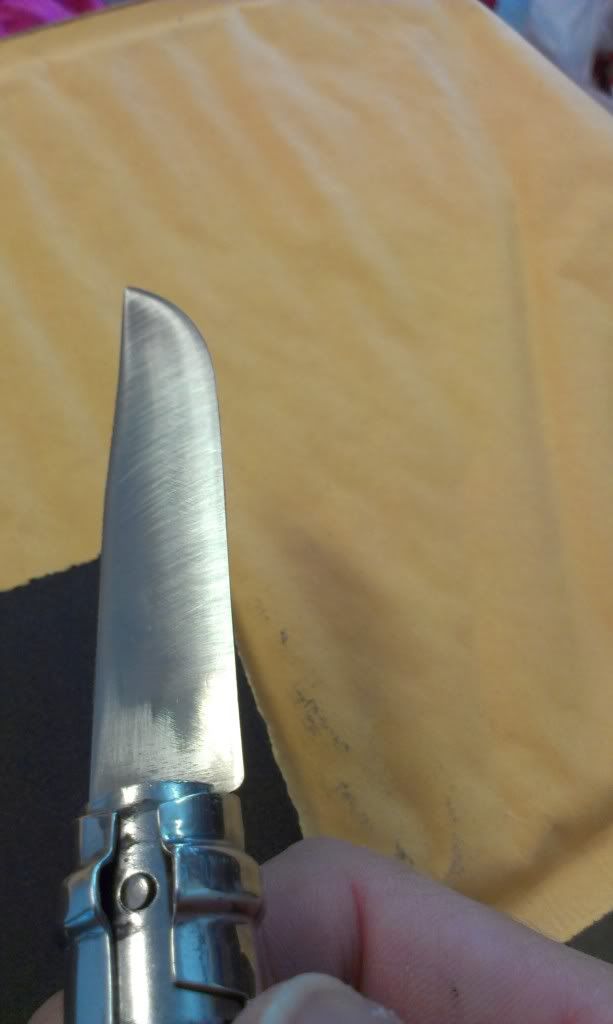

After much blade work I got tired of the ugly look to the thing and polished it pretty nicely. After this latest round of thinning, not only the edge, but the whole blade, it was looking pretty ugly again.
Thank goodness Opinel puts their mark deep into the blade!

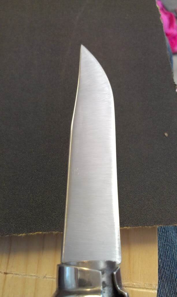

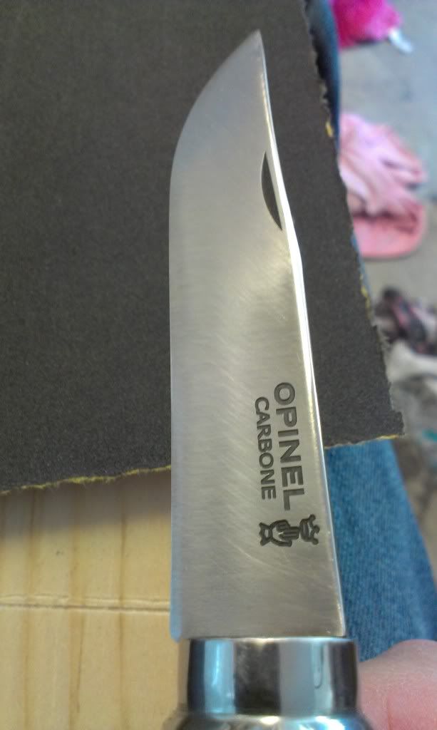

Dry (manual) grinding the blade on w/d SiC 220 grit...
Then a quick progression through 400 wet.
I actually liked the look at that point, but I knew that would pass. I continued to 800 wet.
Then got distracted and stopped taking pics. :p
Doesn't matter, it wasn't about the pics, OR the finish, or even for posting on the forums for that matter. Nope, I've still got my eyes on the prize.
In case you're wondering, I'm no closer now than I was yesterday to a passing test. I have a lot of refining to do, but I thought one thing was really interesting at this thin of an edge... I noticed that when I use a light stropping (edge trailing) draw on medium grit paper (3M 1k SiC), that I can easily see a burr appear almost immediately. That is, within an inch or two of pulling back on the blade.
I've got some thinking to do on this. On one hand, I don't want to remove too much metal, but on the other I'm concerned about the frailty of the edge. I don't mean that I plan on edc'ing the knife, but I'd like it to resist folding by pressing on it with my finger tip. Also, I'm beginning to think that I need to store it open. I can't tell, but I'm guessing that the edge contacts the interior.
Any thoughts on any of this?
I'm still not sure that this is the right blade (steel?) for this, but it's the best I've found that can readily be called a "knife".
It's getting very close to being a zero grind, but at this point it's convex, and I think I need to keep it as such, or risk material loss by accident, like when I'm trying to polish the blade. As it stands it's nearly flat when using my thin leather strop.
Comments and suggestions are welcome. I'm pretty much flying blind here. I've already invested more in sharpening stuff than many of these knives cost together, then there's the time involved. Of course that's the fun. ;)
