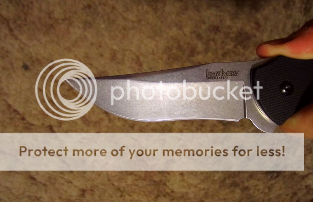

While I don't like a recurve blade on certain knives that do certain tasks (say a recurve whittler) I find the recurve shape useful. I like the extra cutting power and bite it give me in my work knives which I use every day. A couple of my favorites have gentle recurves and are the Kershaw Tremor and the Kershaw Blur. I don't have any use for the really heavily recurved knives (like the Cold Steel Rajah series) though as somewhere in the design equation that curve loses its efficiency for me.
The recurve works best for me on folding knives is about 3 to 4 inches long. For me this is an example of an excellent recurve on a work knife:
Image borrowed from another BF thread
