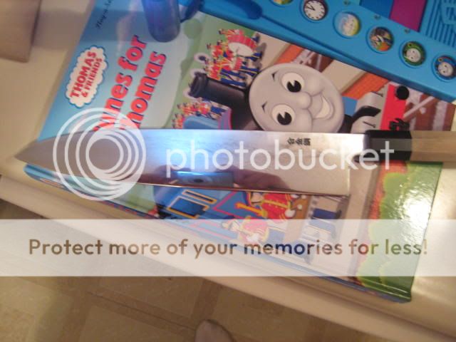

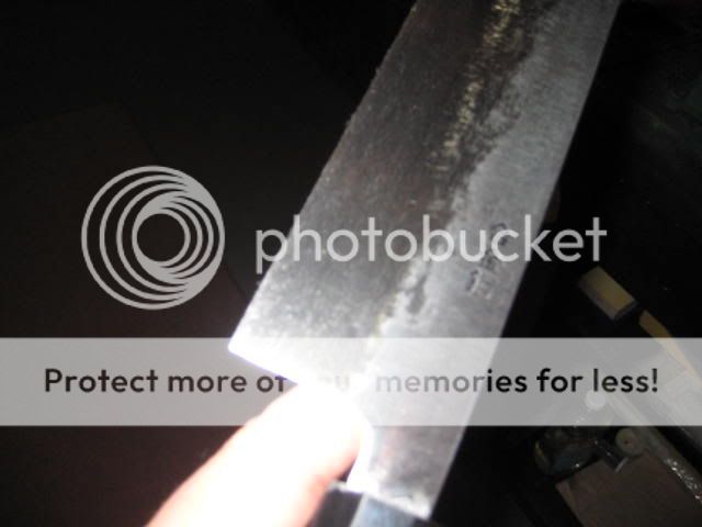

If you have free time, a variety pack of wet/dry from the automotive supply store, and some hubcap polish, you can take this:
And make it into this:
Danged thing ended up convex. :grumpy:

Thombrogan, could you possibly take a second to tell me how exactly you went about this? Do you start by laying the knife on the paper flat on its side, and then roll the edge as you do the stroke? Any time I lay my knife down on something, the side of the blade always shows little tiny scratches. (maybe because i use sand paper too rough?) If anyone could maybe post any links as to how to go about this and how high in grit to go to, could be great. I would really like to try this, but i don't have a sander or buffer, just 2 hands!

The first grind was on an 80 grit wet grinder (the knife was muy gordo), but the mirror-polishing process used wet/dry sandpaper in 220, 320, 400, 600, 800, and 1,000 grit followed by polishing paper (1,500 or 2,000 grit wet/dry would've worked better, but it wasn't here) and hubcap polish. The sandpaper was layed flat on a piece of glass (I used restickable gluestick to keep it in place and any hard and flat surface will work so don't think it's glass or nothing) and the blade was rubbed perpendicular to the edge and spine in sections. The natural arc of my elbows convexed the edge.
Once a uniform layer of 220 grit scratches covered one side of the blade, 320 was used to put a new layer of scratches and so on. After finishing with the polishing paper, a dab of hubcap polish (I used Meguiar's because it doesn't have an ammonia smell) was worked into the blade with a scrap of shop towel (a little of either goes a long, long way) and rinsed and repeated three or four times. Never do so when tired or your thumb will gash open and you'll have to wait until you've stopped bleeding to polish more.
After the third or fourth application of hubcap polish is done, you'll see the blade is shiny, but not quite mirrory. Simply repeat the process, but start with either the 320 grit or 400 grit depending on how mirrory the blade was or wasn't. And when that almost works, repeat with the next finer step and you'll have quite the reflective blade when you're finished.
And a few uses of that knife later and you may lose all interest in mirroring more than just the edge.
