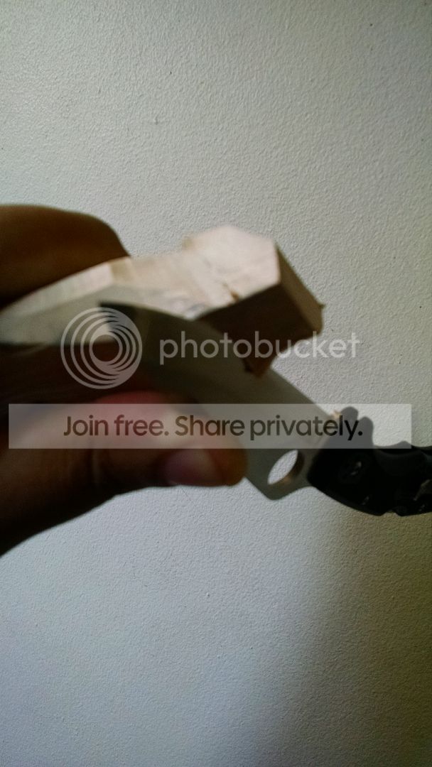

But now I have a question for you because I don't know the answer: what makes a hollow grind a poor wood knife? what part of it gets stuck in the wood? I can possibly see the scandi leveraging it's side against the wood and preventing it from being wedged as the edge moves forward,the wood being shaved away pushes out and is unable to "trap" the knife. I can see the hollow ground being able to cut into the wood unintentionally at a steeper angle and thereby getting wedged. The issue is interesting to me as I've never thought about this.
The edge on the hollow grind gets stuck, there is no steel on the sides to help spread the wood for the edge to continue cutting.
I don't have a science for it
Just anecdotal evidence

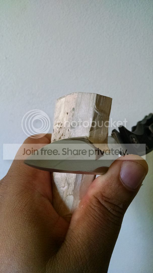

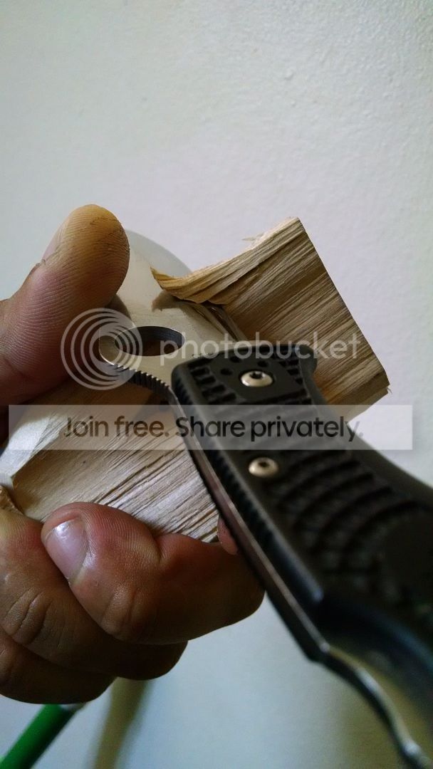

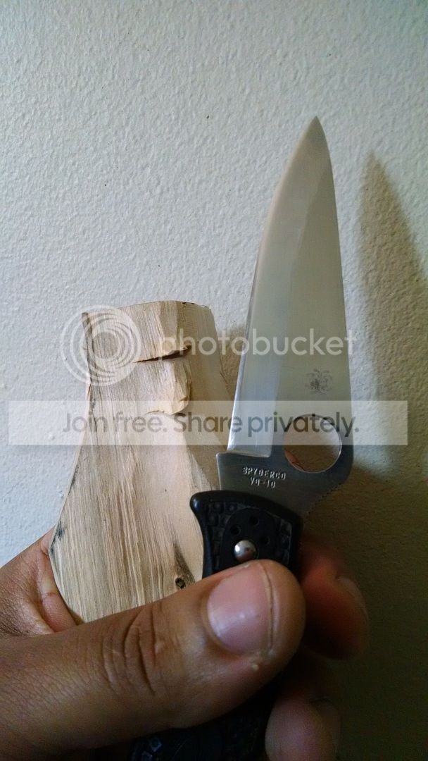

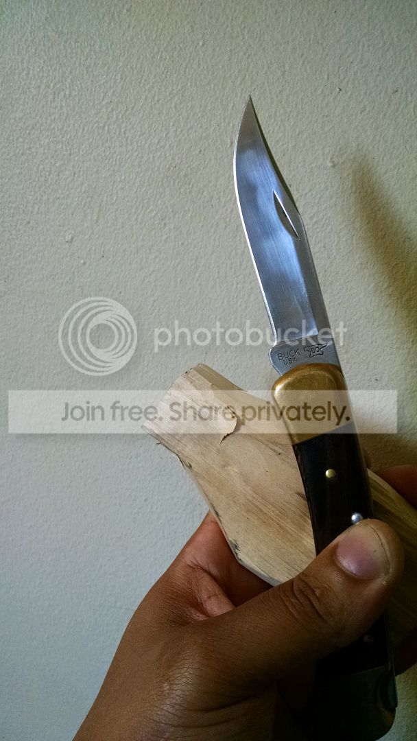

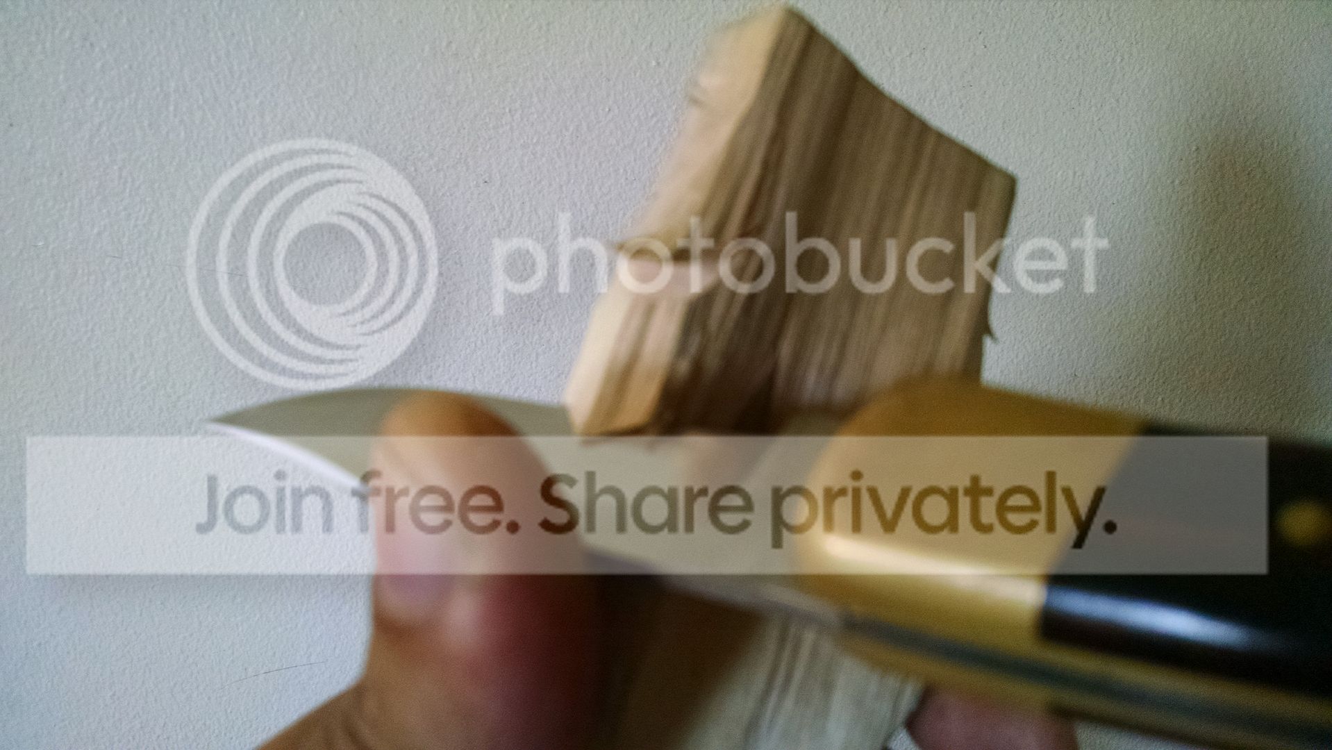

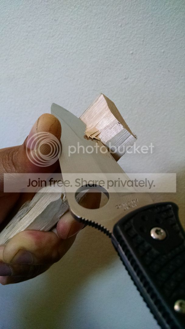

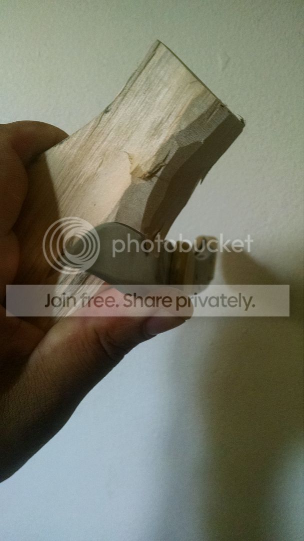

Buck 110 in birch
Spyderco Endura with Convex modification
Even at a steeper angle it bites deeper

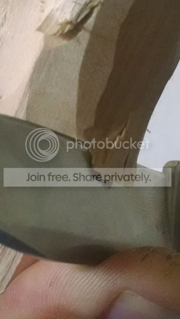

Here is another cut at a lower angle with all my strength
Same angle
The convex kept going the hollow grind got stuck
If I'm cutting soft things like tomatoes or meat it's the opposite effect.
Of course this is generalized and unscientific.
But I'm just a caveman bro
I pick up the knife that works best for what I'm doing.
If it's wood carving the hollow grind is dead last.

The Buck 110 is thicker behind the edge than an Endura. Neither blade cuts deep enough for the primary grind to matter.
It's not the type of grind that matters, there are many more details affecting performance.
:confused:
Do you have pictures?
:confused:
I am going by what I know of both models. I have owned both. But I don't know your knives. Why don't you just state what is the case for your knives?
In your example, none of the cuts went deep enough for the style of primary grind to make a difference. It is the thickness of steel behind the edge that is making a difference.
