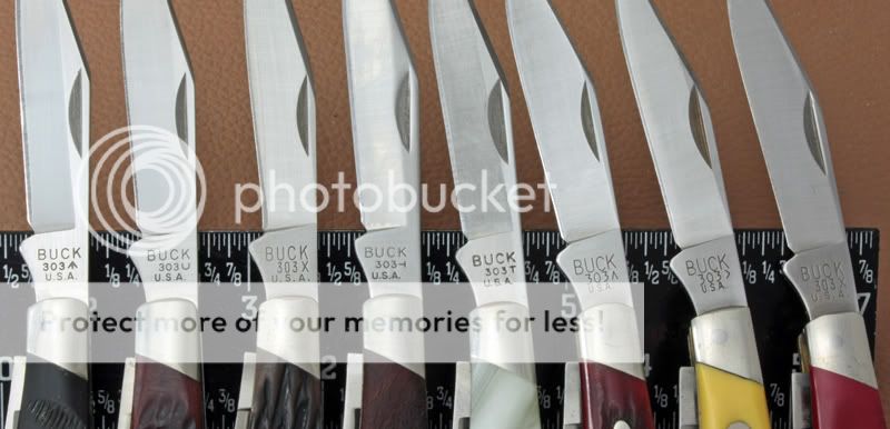

For me they are there to determine how much the edge has been sharpened, if I am lucky, in the dark, blurry, distant, wrong sided photos some folks post on web knife sales sites.....other than that I agree with Par.........300
Here is a quick grab sample of Buck made 303s from the 1980's to the 2000's. I can live with these. The third from the left has been sharpened some.
If I had been paying attention I would have sent the middle 309 back, that is just too much. But, in actuality I still could and I bet they would send me a new one.....I can accept a notch deep as the edge grind, but no more, especially in small folders. Might be different in a big straight knife.

Yeah, that's a great example of way too much. I had a knife like that for a little while, it went down the road. It annoyed me many times when cutting open a plastic bag it snare the plastic, or snare the fishing line, or grab someting. But my question is why have them. How many milliions of hard working Buck 110's and 112's have been made and used hard with no notch at all? I know that when I was in the army, the Buck 110 was THE go-to knife that everyone had on their belt. From chairborne supply clerks to career E8 NCO's like our first sergeant "Elmer the Bull" Wood. Certainly no knife in history has been as hard working a knife as the Buck 110. From soldiers to construction site workers, they were the first of the 'hard use' knife of modern times, except for the humble under estimated Opinel.
I guess the notch is like shields. I don't lie them, but I'll tolerate them for the sake of the knife, if I like other things about the knife. But I hope the knife makers keep them small. Very small.
