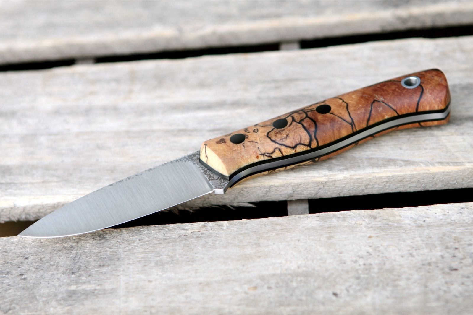

Jeff, I personally think there is a difference. Just in the method of making and grinding them both. But in the end having a choil or not, for me personally as a knife maker does not make it any easier to make the knife, just different. On my fixed blades I use thinner stock and I flat grind them. Overly thick blades and hollow grinds are another topic in and of themselves. I try to keep the plunge line radius really tight, thus eliminating that big area of radius. You can see that pretty well in this pic of one of my fixed blades. This knife has about a 3 1/4" blade and is a little less than 1/8" thick just for reference.
I also, like many other slip joint makers, try to angle the notch out toward the cutting edge so that if anything goes in there while cutting it will have a natural tendency to slide out to the cutting edge without getting caught.
