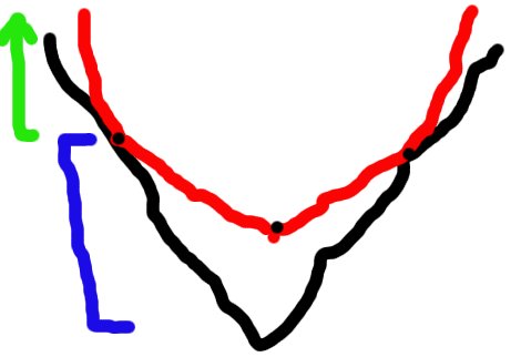

I don't think that's correct. When you convex a v-grind, you 'round off' the edge, changing the edge angle and putting more metal right behind the edge because you're moving the edge higher up into where the v-grind was thicker. Here's a picture of what I'm talking about. Please pardon the shakiness; I drew it with a touchpad on a laptop
Suppose the black is a true v grind. To get a convex (the red line), you round it off, moving the edge higher up as in the picture.
Now, I marked in the picture where the convex and v-grinds intersect in width. The mean value theorem from calculus requires it to be the case that it's thicker nearest the edge because of the difference in slopes between them. The edges will intersect somewhere, and where they do their slopes are equal. Every part of the convex before that point (marked with blue) has a higher slope, while for everything above it (marked in green), the rate of change is lower.
Returning to the "turning a convex into a v-grind and vice-versa", the other side of it looks like
Note how you shear the shoulders off, making it thinner behind the edge.
Sound reasonable?

Did you see my pictures right above your post? The edge has more material behind it without adding material but removing it :)

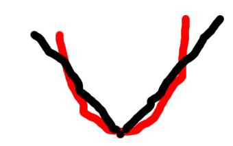

Nope there isn't more metal behind the edge over a V grind if the general starting angles are the same.
The only way for the Convex edge to have more meal behind the edge is to make the relative angle of the convex more obtuse than the V edge, or steeper so it would in effect cut less efficiently, or in effect like going from a 30 degree inclusive to a 50 degree inclusive.
If both edges are at the same relative angles the Convex will be thinner than the V edge, that makes it weaker.
There are no freebies here, to get one thing one has to give up something else.
Your picture is a example of your thought of convex.
Would you mind drawing or describing one that contradicts that a convex has more metal than a v?
The math seems to imply otherwise, so that's why I'm curious :)
Well, you kind of nailed it. The angles are not the same. I don't know which cuts more efficiently. But there is more metal behind the convex edge and the transition from edge to blade is smoother, which is why some people -- rightly or wrongly -- think the convex cuts better.
The drawing above is pretty close, except it shows the edge shoulder widths being different. Actually. The shoulder would be the same width. The V-edge makes a straight line to the shoulder. The convex edge makes a sweeping line, outside of the V-edge on its way to meet the shoulder. So you are correct that the angle is more obtuse by a slight amount. The edge sharpness won't change, but you will have balancing factors: a more obtuse edge angle and a more gradual transition to the blade. One helps cutting performance, one hurts. I don't know how it balances out.
