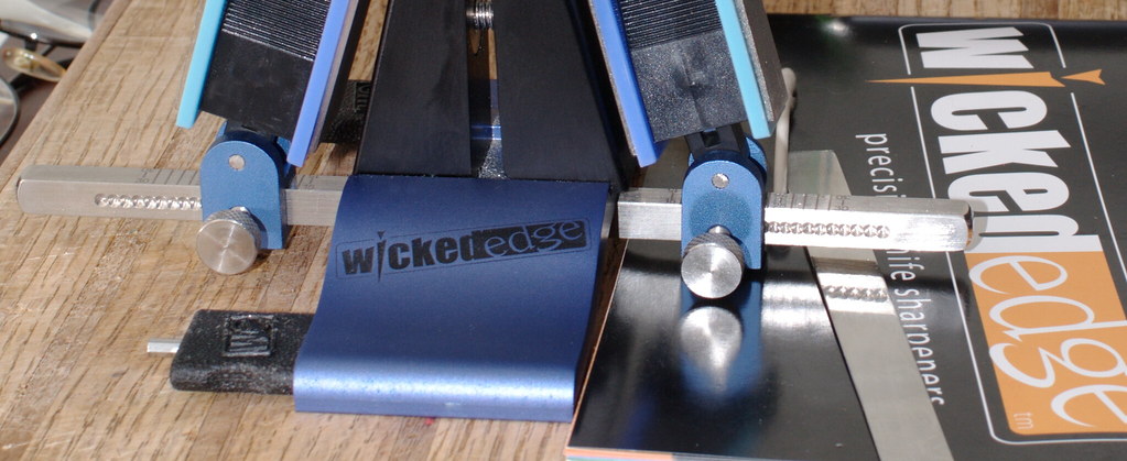

Here is a shot of the graduated angle setter. Whatever angle you set can be repeated again any time. It goes from 15 to 30 degrees but if you clamp the arms right up against the vise you can get 13 degrees and perhaps 12 if the blade of the knife rises .63 inches over the vise edge.
The whole rig is very solid and easy to use if you follow the prescribed work-flow carefully. I love this machine.
