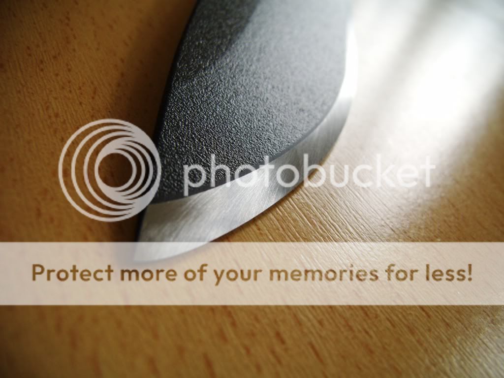

Here are a few close-ups of edges i achieved using the Wicked Edge (with the use of wet & dry SiC paper and cardboard with polishing compound)
(Click on the images to get a large picture, and again to see it extra-large)
- K9 Dingo CPM3V fixed blade to 40 degrees inclusive, and the second knife that i sharpened on the Wicked Edge
This one did not get the polishing treatment yet, but it can treetop hair.
It is at the moment my favourite outdoorknife.
- Spyderco Endura ZDP189 CE (Just the plain edge section) to 30 degrees inclusive
Can whittle hair now.
- Spyderco Military S30V SE (Just the chisel grind plain edge section near the tip)
Nice pictures and knives.
Nice looking bevels and finish too. I think there is one thing that would bother me a little with the bevels though.
It looks like the bevel angle is changing toward the tip and becoming more acute. I say that based on the impression that it looks like the bevel width becomes bigger, or wider, as you go out toward the tip. It might just be the angle from the pictures or the blade geometry (the primary bevel and taper toward the tip). If the blade is thicker out there that would explain it, but I would think it would be thinner near the tip or at worst the same.
It looks like you need to clamp further out on the blade (toward the tip), if you want the bevel angle and width to be constant, so the radius form the guide pivot to where the stone meets the edge is more the same from one end to the other. If the radius get longer on one part of the blade then another it will change the bevel angle.
It is a similar principle to how much you lift the handle when sharpening toward the tip with free hand to keep the same angle. The result is the same as if you didn't raise it enough.
Anyway, if it doesn't bother you, it is as least repeatable as long as you always clamp at the same location.
Gary, your completely spot-on with your entire post, but that is in essence how the Wicked Edge works because of the arc the diamond stones describe.
The sharpening angle gets more narrow the closer you get to the point, but not only does it happen nice and gradually, if you want you can diminish this effect by clamping the blade more towards the point.
It is however more noticable on longer blades.
Because of the exact repeatability of the system i can reclamp these blades at the exact same point when they need a touch-up, thus minimizing the loss of steel.
