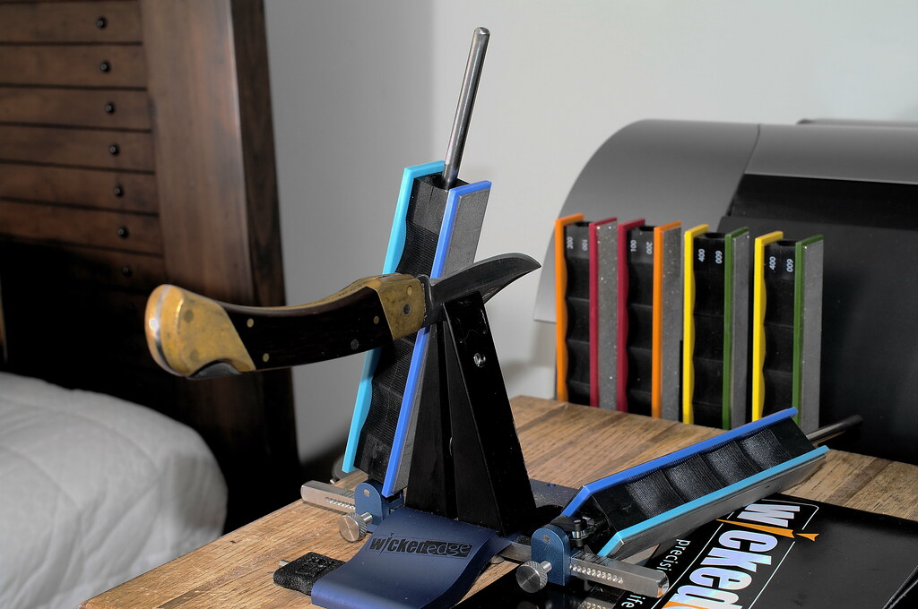

You tell me how narrow and I will try to find one around the house of that size and test it out. My Buck Model 110 blade at mid-blade is .74 inched wide and that is where you clamp in the WEPS vise, at mid-blade. There is a two position stop on the vise...the top stop is for narrow blades and the second lower stop for the widest blades. I keep a record of the knives I sharpen and note which position they are in according to depth and the knife point. With these two co-ordinates I can always put the knife back in the exact same attitude each time I sharpen so as to not disturb the profile during touch ups.
SO to answer your question as simply as possible, a .74 inch wide blsde was easy, no problem.
Leo
The first sto is not too deep so as you might be able to discern in this shot of my Schrade Bear Paw with also a .74 inch wide blade, there is a lot of blade sticking up clear so the hones can lap it quite nicely. The narrow profile of the vise itself gets it out of the path of those rods on their universal joints locked into the correct angle.
How do I get a preview of my picture on this thing. Please forgive me if the picture does not come out right.
