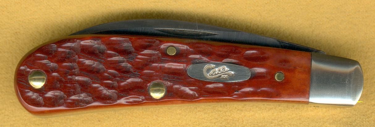

Witness the Swayback, at 3 1/5" long, a perfect watchpocket knife.
Equipped with much-loved CV steel, in a forever useful Wharcliffe blade and with an ubiquitous pen by its side (almost a mini-Zulu!), this knife is all the knife most people need in their daily lives. Cap it off with nicely jigged and dyed bone, the jig size scaled reasonably well to the knife, and you can even brag a little!

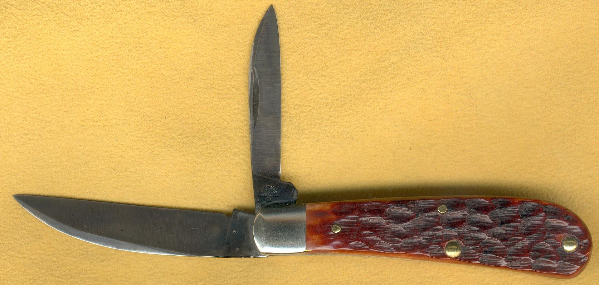

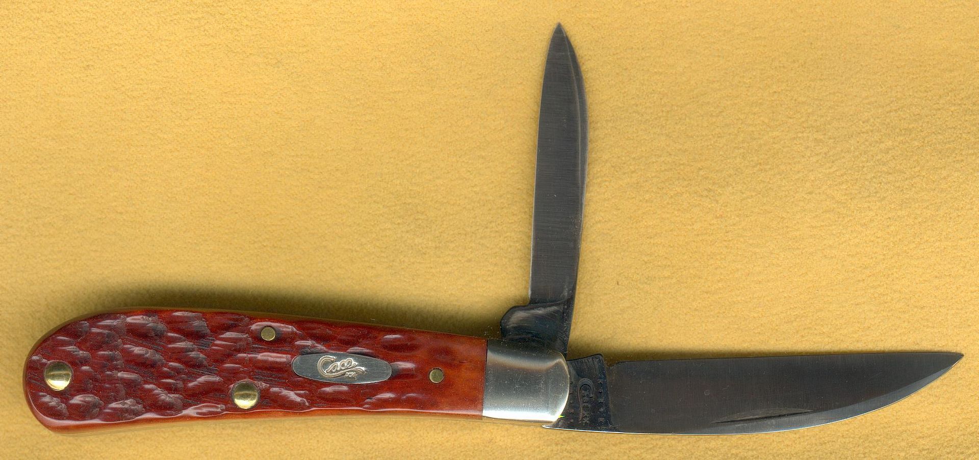

This knife left Case, with nice fit and finish, an appealing appearance if a bit "shiny", and workable edges but not very refined. Its journey brought it to Wilfred Indiana, where it got Worked a bit!!;)

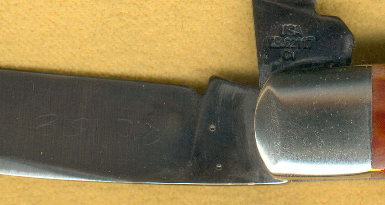

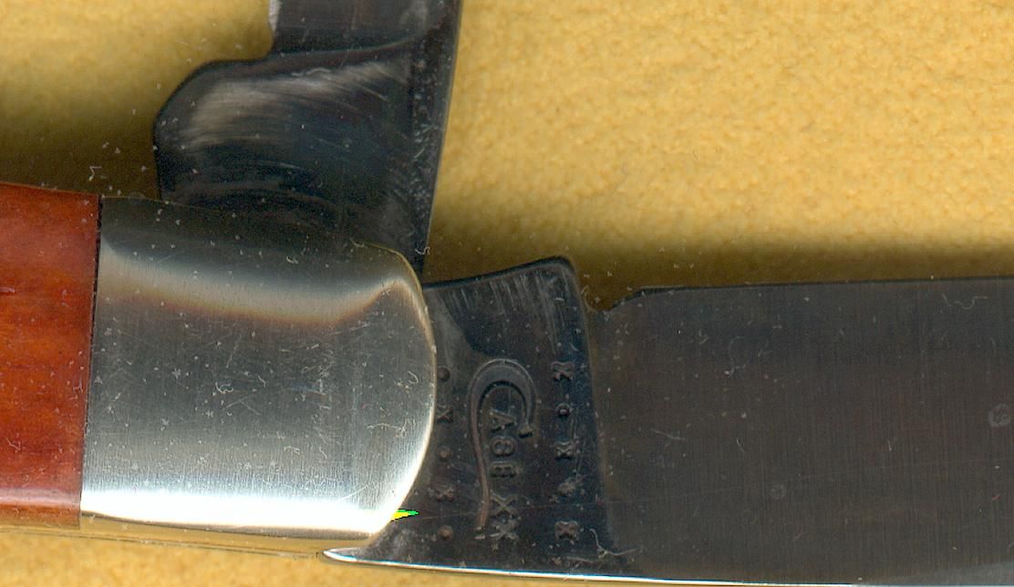

It now sports proof of the blade's heat treatment, being Rockwell tested at 58. The blades have been finish ground to a thinner slightly concave "near zero edge" profile on a 14" wheel. The swedges have been "crisped" up and improved, to get rid of the "tumbler" look.
And the bluing gives the CV a bit of corrosion resistance, and a purposeful appearance. Last but not least, they have a honed edge that will shave a housefly, and still allow it to hover!!:D
Now if Case could just incorporate a little more of this goodness in their knives, at a reasonable price . . . . .I hope they read this!!:rolleyes:
