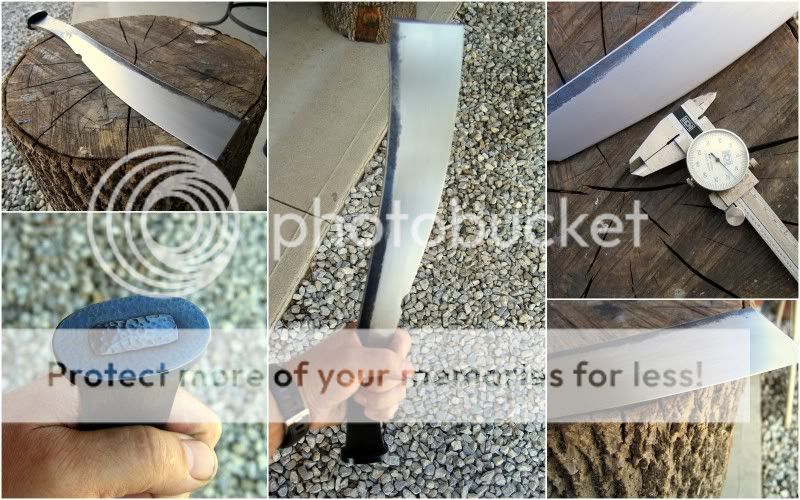

Handle is Agentine lignum vitae. Blade is 10 1/4", steel is 13/64" 5160.

Finished up the sheath today. This sheath was quite a challenge for me as my kydex press is only 8"x12" so I had to improvise with beach towels and 2"x10"'s. Also this is only my 2nd open-backed kydex sheath. It has a cross-draw attachment w/ Tek-lock, and a semi-drop-leg attachment, also w/ Tek-Lock. I was going to add a leather strap across the back and around the handle area for added security, but the retention from the kydex is pretty strong on its own. I tried to get the blade to fall out of the sheath but was unsuccessful. Whole package will be completely finished by the end of the week.
View attachment 283048View attachment 283049View attachment 283051View attachment 283052View attachment 283053
Both attachments are adapted for righty's. The pictures were taken in a mirror.
