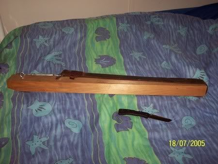

My strop A piece of 4x4 pine with a heavy belt nailed through the tounge run over the end abd back to an eye bolt then connected to a turnbuckle so I can tension it if I want. That is a Cold steel gunsite for size comparison.

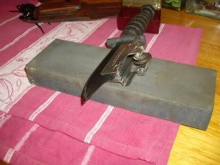

Buck 136 hone master. Probably the best edge guid I have used I can't understand why it is discontined, They do turn up on ebay ( search buck 136 honemaster) I think $AUD40 is fair. I haven't brought one from fleabay I have 3 ( no not interested in selling any they will wear out)

I have an old leather belt, Can I glue the outer face of the belt to a piece of pine and use that soft inner belt as a strope, or does the strope have to be free floating?
You can glue it, the give of the belt will be enough. I personally just use my regular belt that way I always have it with me.
Onado I now think glued is better but wen I made the strop I thought it was important to be able to have the leather curve as Shotgunner said the give of the belt is enough.
Lots of people talk about using mouse pads for convexing edges I think most mousepads are too thick and will let the wet&dry paper curl up and remove the dge thin mouse pads are ok but I have gluded a piece of vinyl to one side of te strop for that purpose (convexing) and find I works really well.
