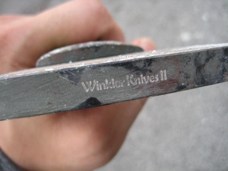

Because this axe is designed to be used for prying I did not want to weaken the lateral strength of the by cutting weight reduction holes in it. When an axe is used as a striking tool the skeletonizing does not affect the strength much like the framing of a wall. But to increase lateral strength the additional material without breaks improves prying strength when compared to a skeletonized handle. The amount of additional weight, about 4 oz., should also add to the power to the strike since with the tang taper it will still have the majority of weight still in the head. The Breaching axe as well as the Crash/Rescue axe are overall heavier than the axes designed primarily for combat. It’s just the nature of the beast.-M.S. Daniel Winkler
W.I.P pics:

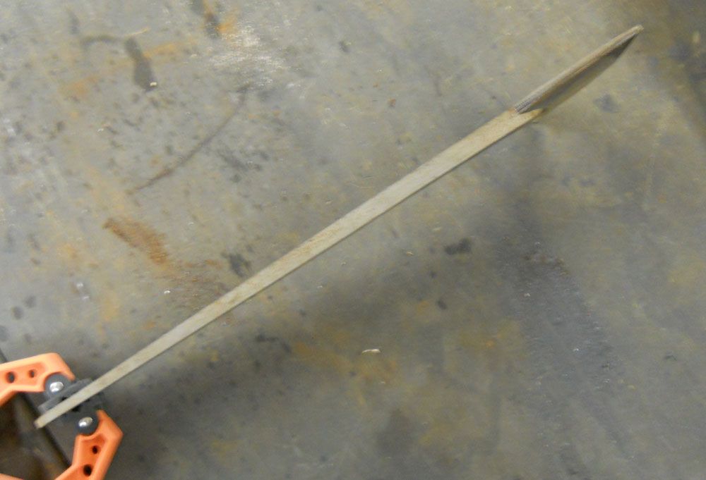

The bevel was ground convex; the pommel was machined convex on one side and concave on the other to provide better reach at prying.

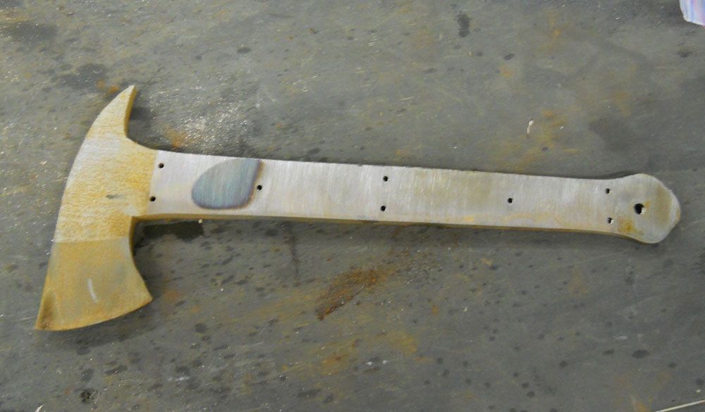

Tang tapered for head heavy chopping power:
Sandblasted and ready for HT:

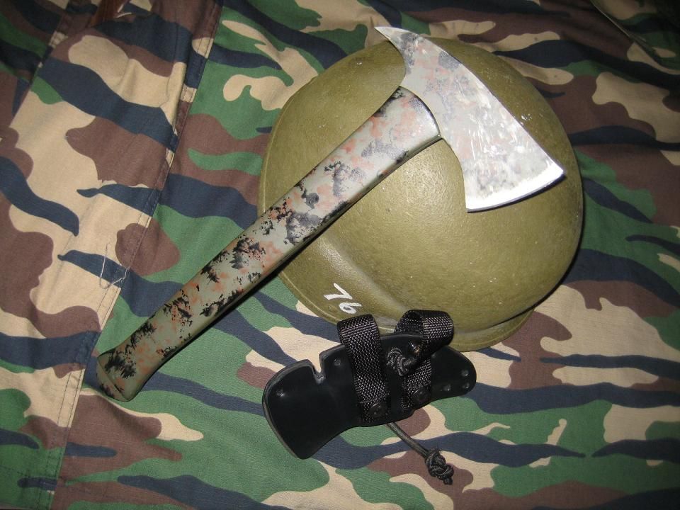

One day this came:
Just over the weekend I’ve decided to test out the design.

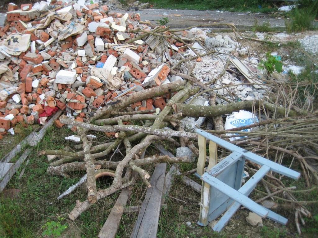

What about some dried branches, bricks, cinderblocks and some concretes?

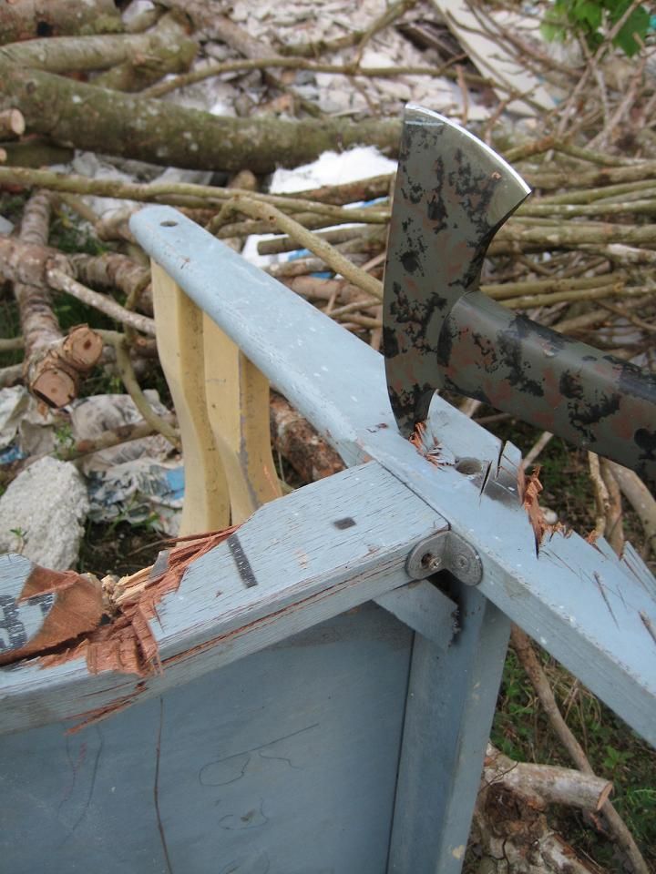

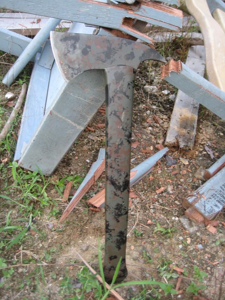

Started off with a broken school chair which upon initial chop it’s made of Cengal, a local hard wood:

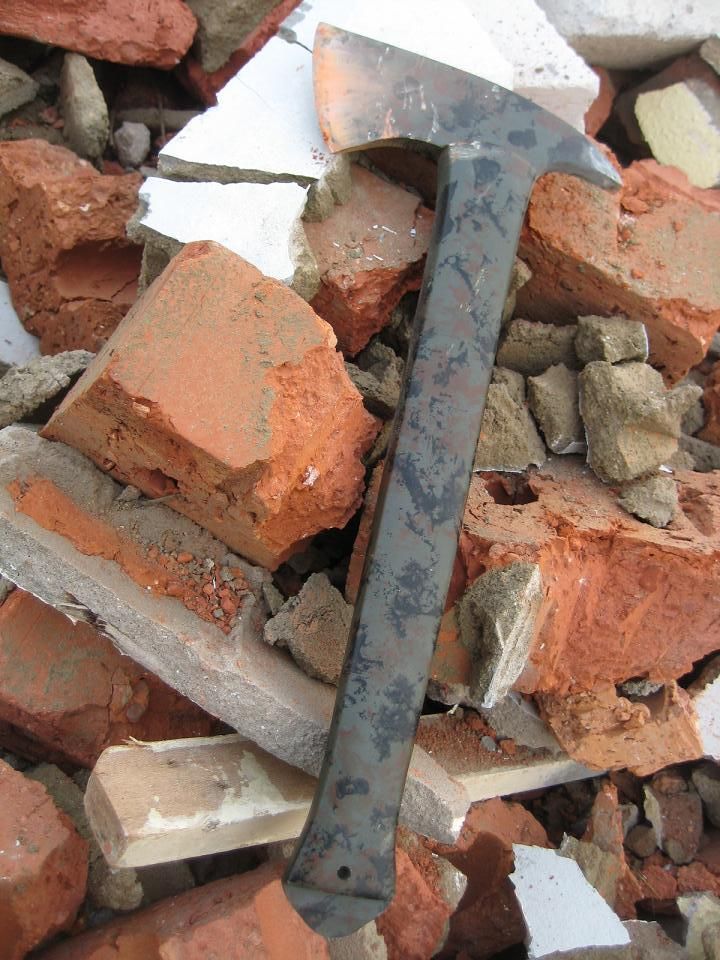

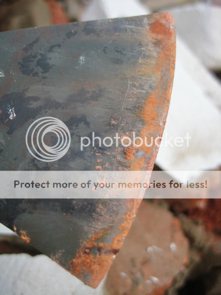

Next…. Can we have some bricks and cements?

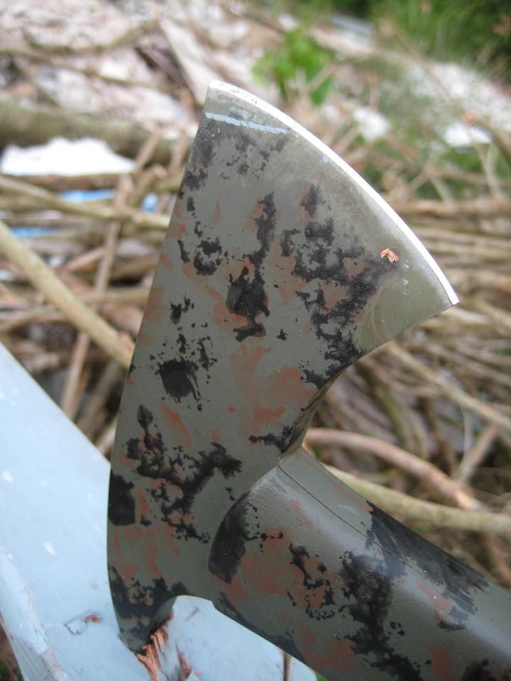

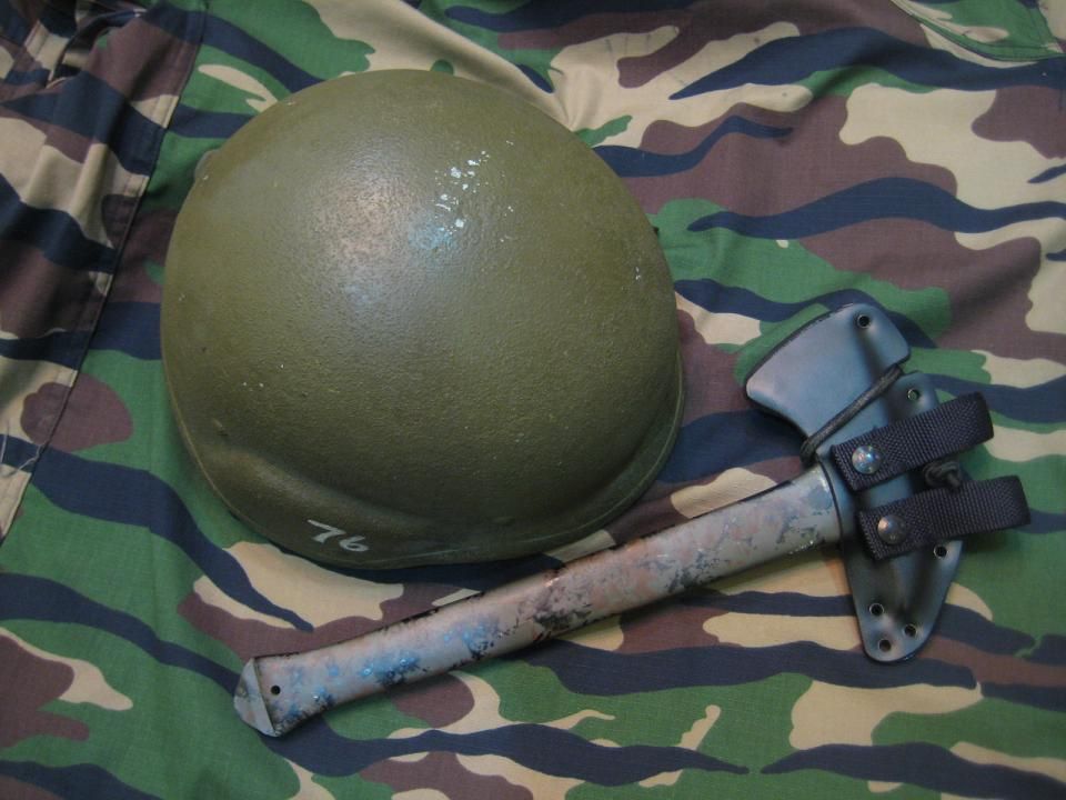

No edge chips. Minor dings expected:
Nothing on the spike:

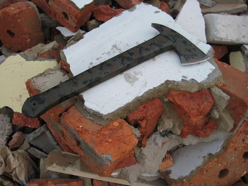

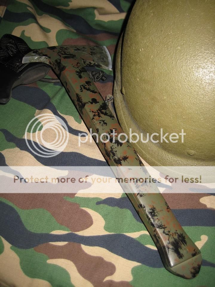

Here’s the graphic result:
Other than chipped off KG coating,some serious cleaning up to do on the handle and touch-up on the edge, this axe as I would say was built for breaching/combat application but my curiosity of chopping through concrete was solved. Although i might have abused the axe but i’m convinced that it exceeded what I expect.
