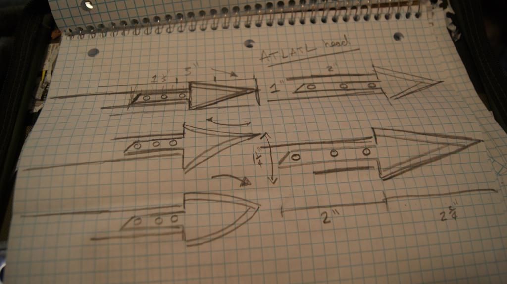

I braved a trip to my work building to gather up my graph paper and supplies this morning.
Not entries, but two I want to offer in the upcoming sale.
6 1/2" overall
3" blade
3/32" thick
3/4" tall
9" overall
4 1/2" blade
1/8" thick
1 1/4" tall

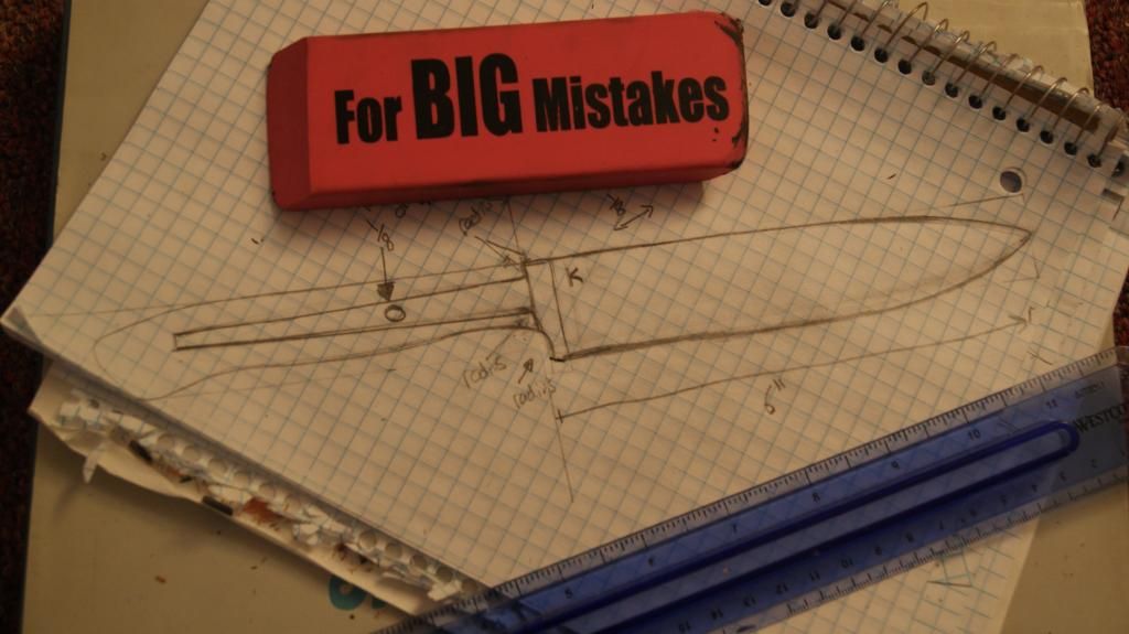

I've had that exact picture bouncing around in my head for about six months now. I'm still not 100% solid on Mr. Kiedaisch's pricing scale so I don't know how much it would cost but I really appreciate the opportunity.

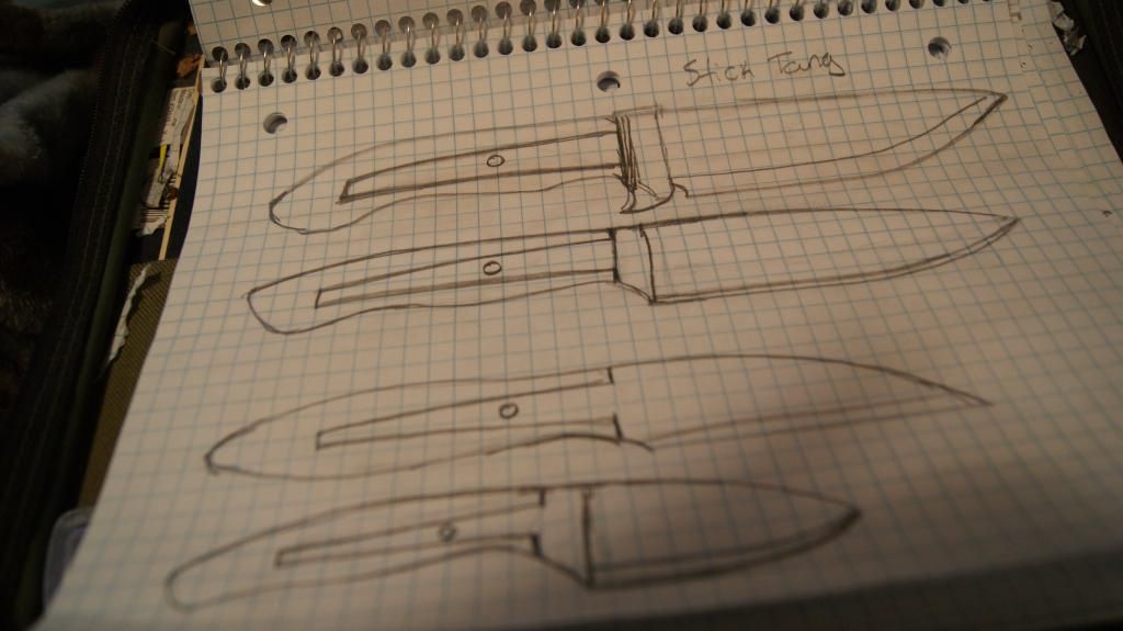

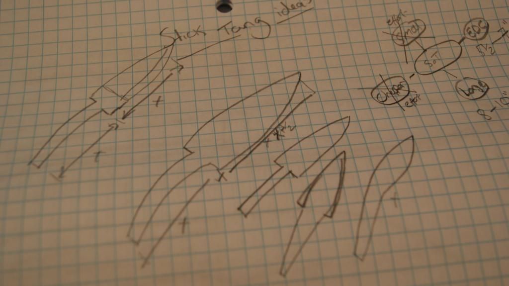

I kind of go another way with design, I have some ideas and end up drawing a lot of sketches instead of just one and tweek and adjust as I look at it
lots of ideas about different projects so far
working on how a stick tang works
Aplling some of it

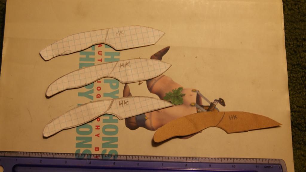

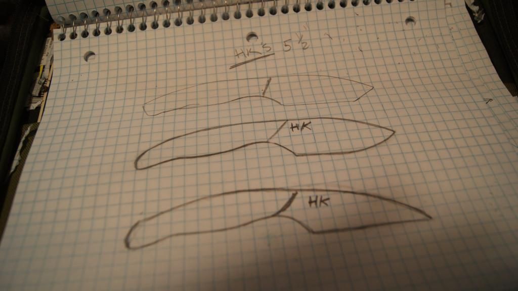

some HK ideas
ideas for a project of mine
Aplling some of it
some HK ideas
On a stick tang always put a radius where the tang meets the blade, avoid sharp corners.

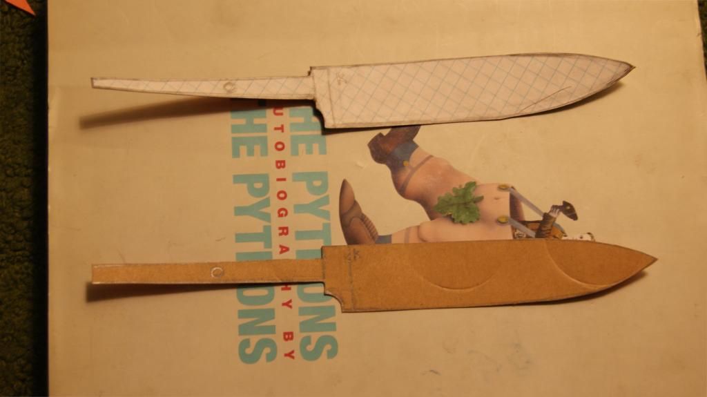

Having some second thoughts about how I'm designing this stick tangs...inspired by the crooked creek I up-sized the second picture in the collection I posted before by cutting out a blank and sketching and re-sketching around it. But I'm not sure I should plan for the top of the ricasso to meet the top of the handle so perfectly, seems destined to fail.

Got some cut out's going last night as well
