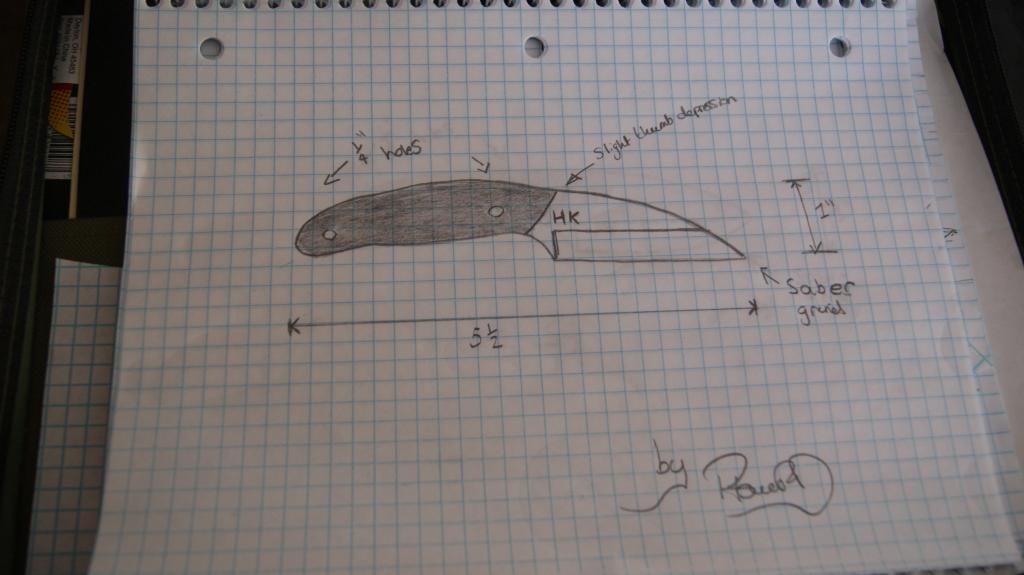

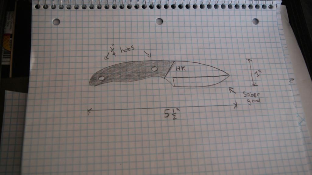

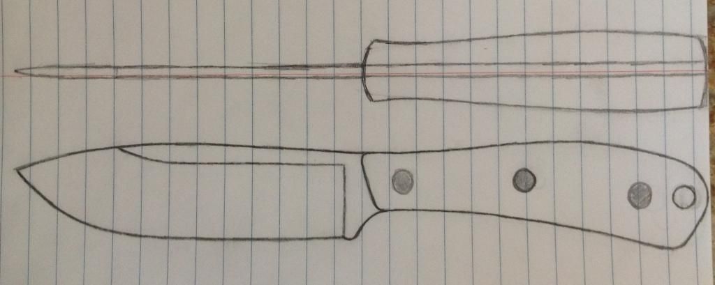

this was my entry in an earlier jk design contest. I held onto it thinking i would order one some
day. It's my vision of a jk puukko. The tang slightly extends the handle in case you would need to
tap on the knife. I keep going back and forth on the thickness but know john's heat treat can make
1/8" steel take some unbelievable hard use. I also thought about making it a straight back but dropped
the tip a little to get it closer to the center line of the knife.
This right here is pretty much my grail for EDC. Its blade is under 3 inches so no possible legal issues even if I need to cover the handle and sheath with my shirt in non knife friendly areas or where it may make people to uncomfortable. It has a full size handle with sufficient swell to be able to keep a good grip. A nonthreatening wharncliffe style blade, yet one that still has a tip for any piercing and a full flat grind for good slicing. Also it has micarta handles and brass hardware which over time takes on a personality of its own.

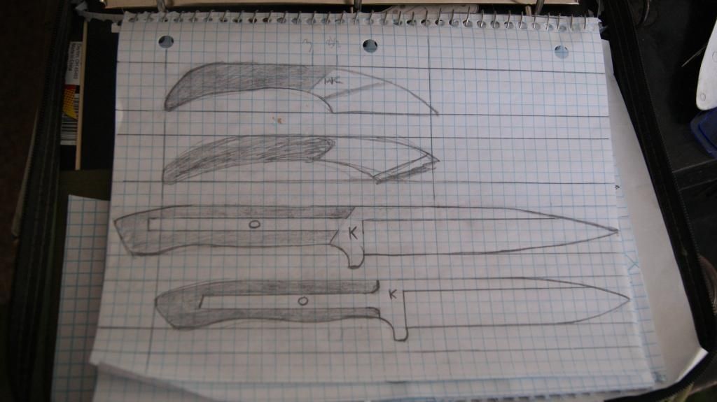

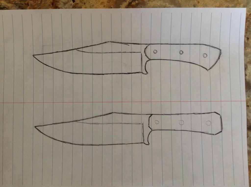

This is an awesome idea! Here are my two favorite designs that I have drawn recently... If I ever got to make my own knife, these are what they would look like.
This is a design inspired by a canadian belt knife. Roughly a 4 inch blade.

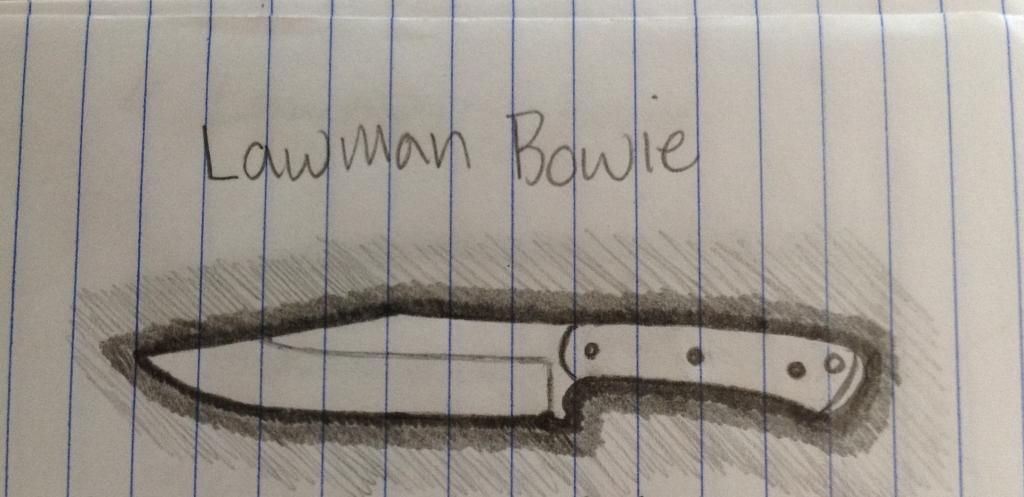

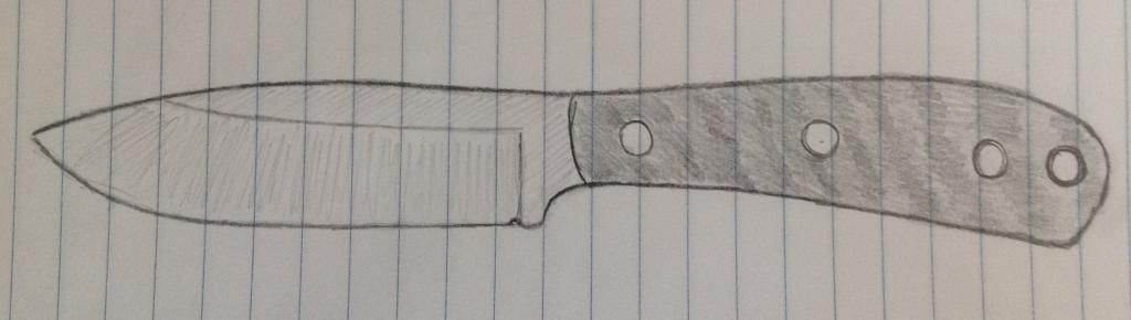

This knife is inspired by a knife that already exists. The one I have is very tactical, and I feel like it would make a awesome looking bowie if it was more traditional in apprearance. It looks good with a sabre style handle and with a coffin styled handle. I picture it in a leather scabbard tucked crossdraw behind the belt of an old west Lawman. The blade would be 7 to 8 inches long. The handle about 5. I tweaked some of the shape a little. I the first picture, I think the proportions are just right. In the bottom picture I think the height from the edge to the spine may be a little tall.

Very nice, what thickness do you invision? What purpose to the design? Skinner? Utility?
LIKE THIS, WOULD LOVE IT IF HOLLOW GROUND. Nice lines.
Any design/function/purpose notes?
sEEING QUITE A FEW WC AND SEMI WC BLADES LATELY. WONDER WHY? THIS IS A NICE LOOKING DESIGN.
