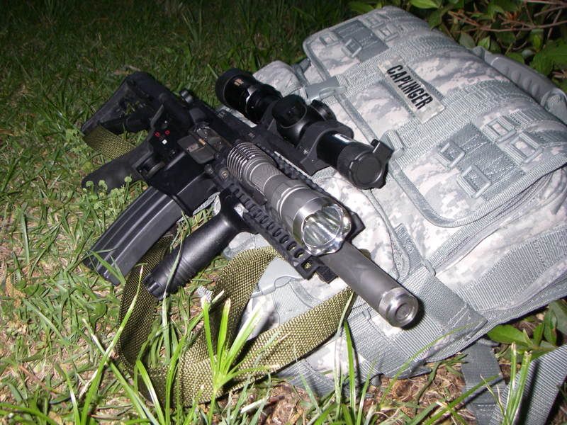

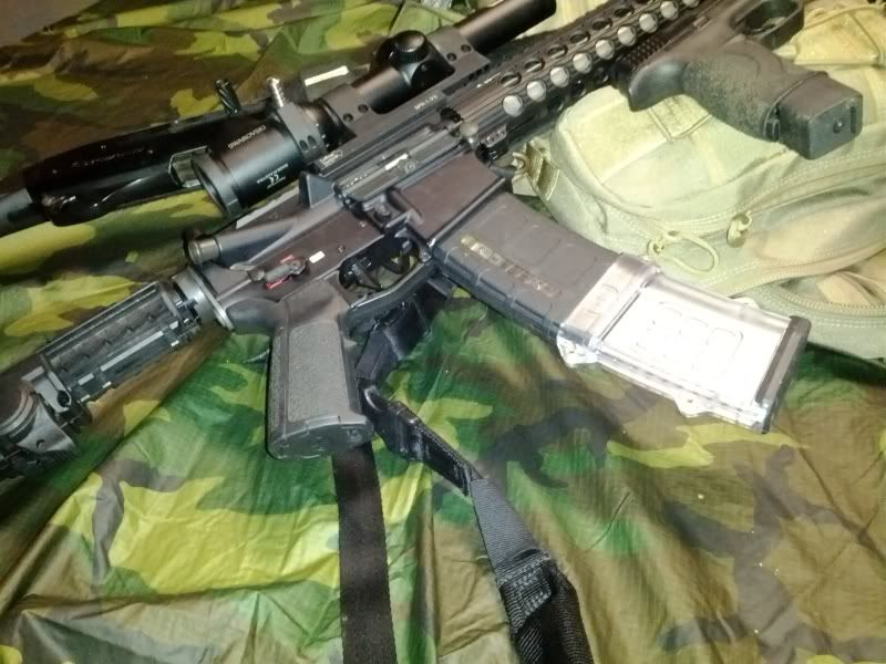

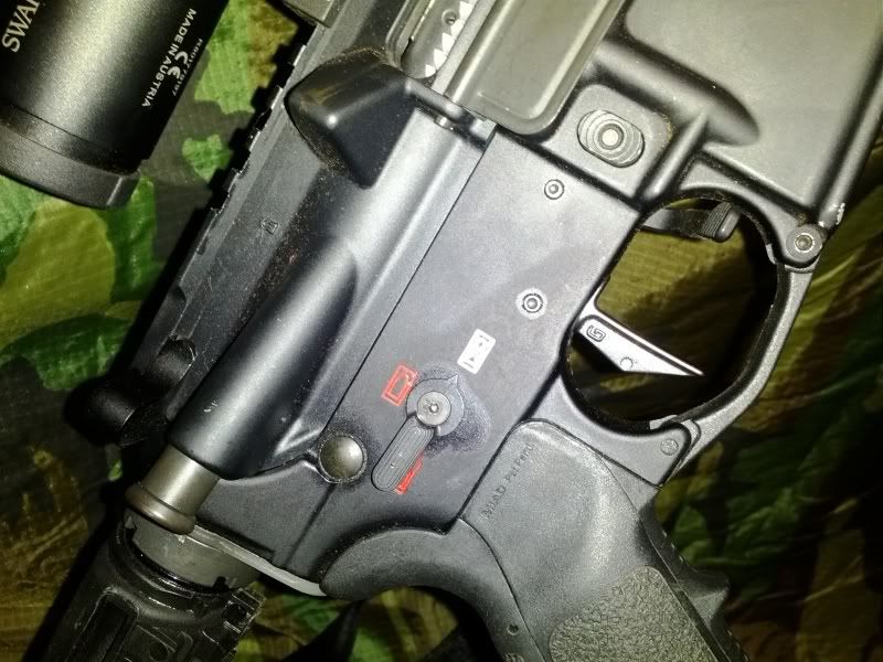

I've done "Tacti-cool" and quickly figured out that, for what I need, Light weight is the way to go, so, Here's a cheap lightweight thing i put together from some sweet deals i found, Magpul MOE all around, troy flip up rear (ok, that's not cheap)BCM Gunfighter charging handle. got a savvy sniper sling and the fail zero kit for christmas. the kit comes with nickel boron coated BCG and Hammer. the coated hammer actually makes for a smoother trigger pull with the stock trigger. but the headspacing was off, so i have to send the kit back. I've decided to send my old BCG and Hammer to Robar for NP3 coating.
I also have been planing a Coyote build using a VLTOR MUR upper White Oak 20" in .204 ruger with a JP enterprise handguard and trigger. and sooner or later a 50 Beowulf upper :D

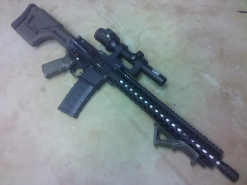

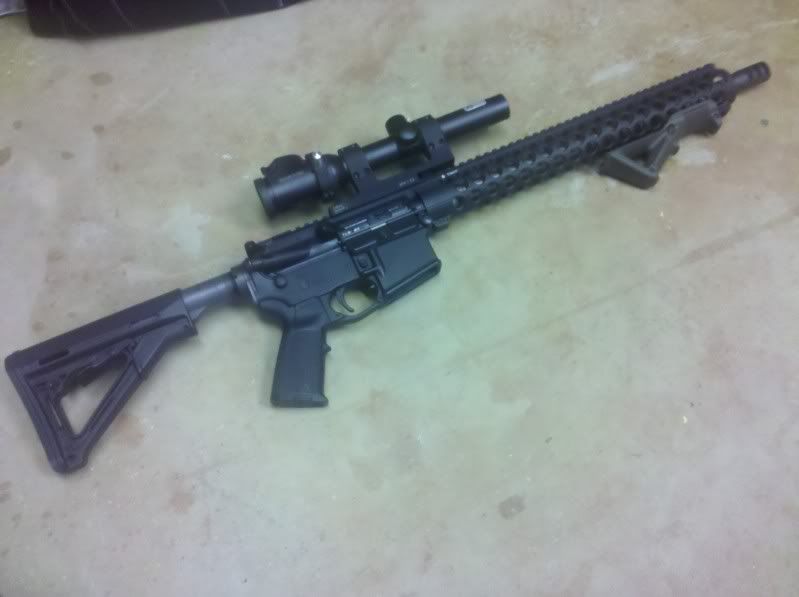

I put this in another thread, but I guess it goes here too. This is my 3-gun rifle I finally finished....I think.
I'm working on another build that will be very similar for general purposes. Biggest difference will be the optic. I can't afford another $2500 piece of glass.

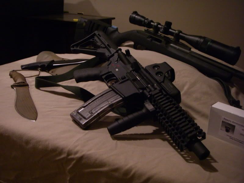

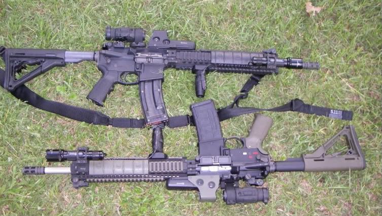

Other configurations of this rifle, and others I own/owned ( AR porn)

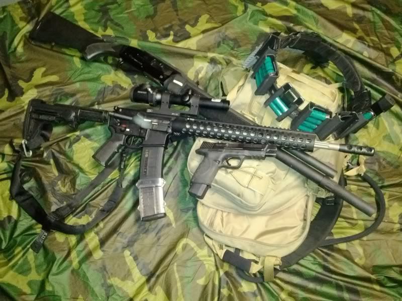

Suppressed 22LR
458 SOCOM

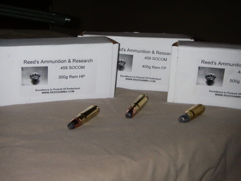

458 SOCM ammo
I had it for about a year and sold it. It was alright. I got mine when Marty first introduced the round to the public (before RRA started selling them). It shot well but wasn't real practical. I built it for hog hunting on Ft Stewart in Ga, but after a year of striking out every weekend I gave up on the SOCOM and hog hunting. The ammo was too expensive and hard to find for plinking and I never did get to kill a hog with it so it got sold. Honestly I would buy a Marlin SBL 45-70 before I did the SOCOM thing again. If I just had to have another big bore AR, I would go with a SOCOM again, though. It outshines all the other big calibers. If you decide to get one, keep in mind it was designed to be a short-barreled rifle. Marty designed the round to achieve full powder burn around 8.3" so even that 10.5" was longer than need be. If I was to do it again I would set it up like the suppressed 22 in the pictures above it. I would run a 8.5" barrel with a 12 or longer handgaurd and a suppressor that would fit inside the rail. That way I get the handling of a longer gun (which I like) and a suppressed sound signature(the big ammo is subsonic so it would work out well). Recoil wasn't bad either. One buddy got scope bite with it, but I'm convinced that was his fault, not the gun.

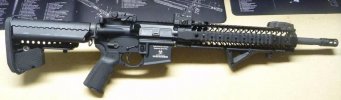

I'll play...

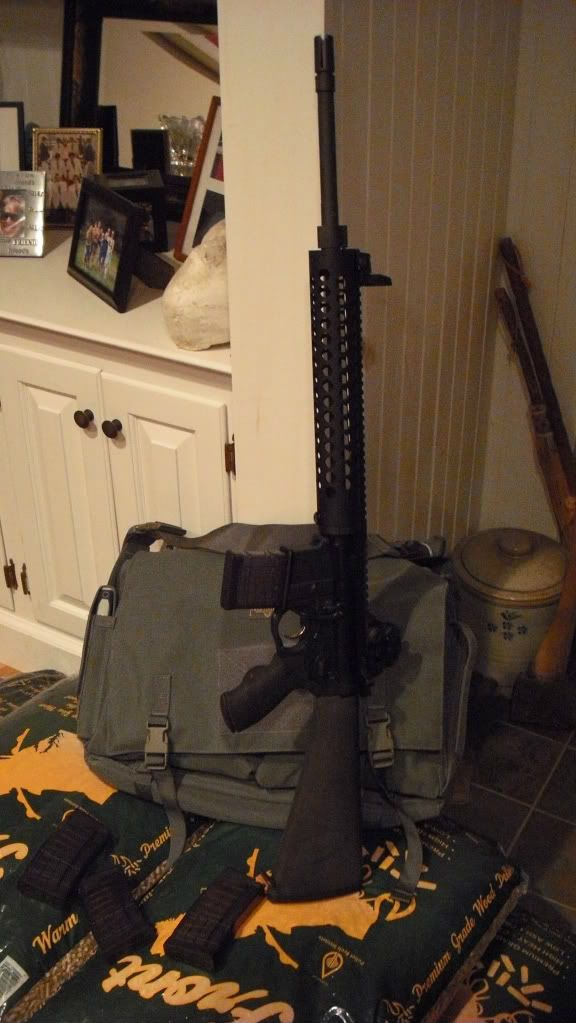

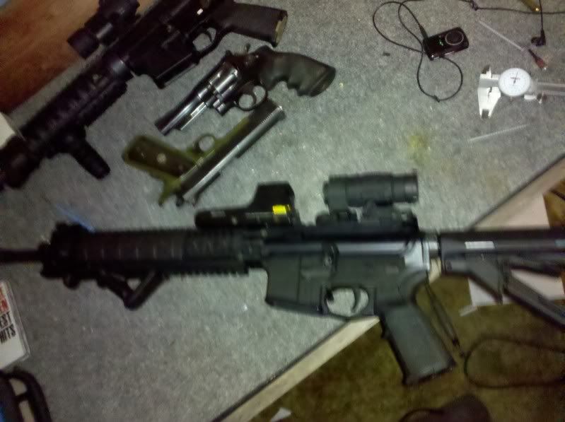

Spikes upper, Armadynamics charging handle, DD BCG, BCM barrel, Midwest Industries rail, CMMG lower, Spikes LPK, Lancer magazines, LMT rear sight, Magpul front, Smith Vortex FH. Stag A2 stock, YHM gas block, standard rifle-length gas system. Has since received a VTAC MK2 padded sling and A2 stock sling adapter as well as a front QD swivel. Will get a flashlight soon. Someday, I'll send it to ADCO, cut it to 18" and flute it heavily. The stock will someday be replaced with an ACE SOCOM, same time I get a light for it.
The bag is a Maxpedition Gleneagle if you were wondering. I heat with wood pellets.

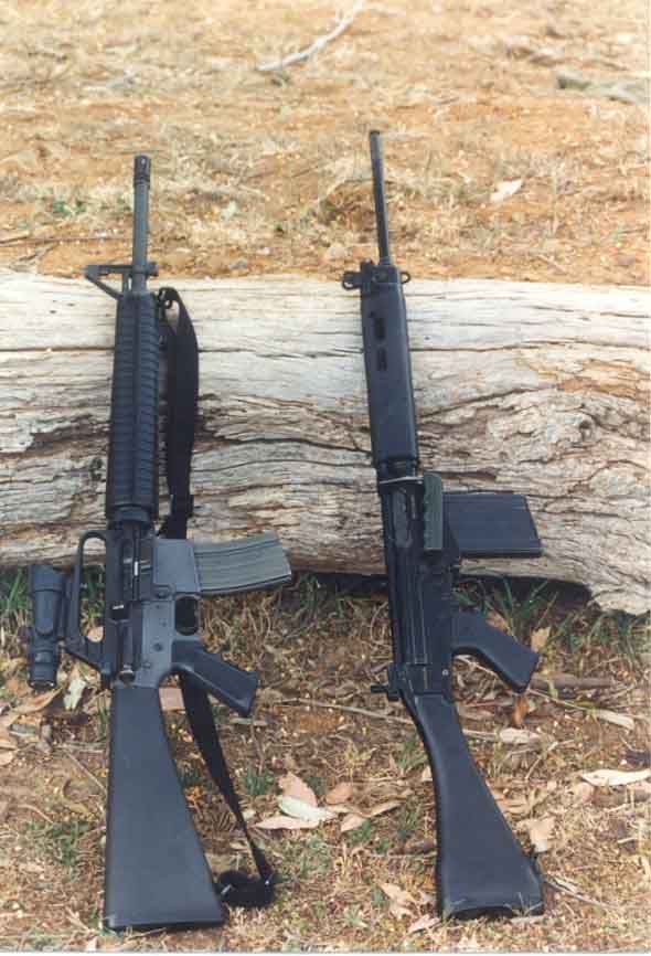

Many years ago I assembled (as I really don't think of ARs as something you actually build ;) ) the one on the left. Long gone now of course but it shot like a varmint rifle...!!!! Still, it is chambered for a varmint calibre... ;) ;) :eek: Not like the SLR... :)
