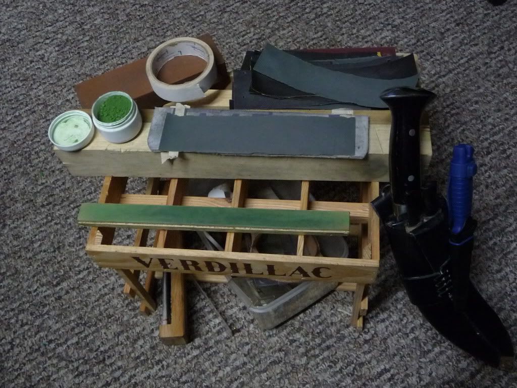

I personally convex my kukris by hand using a simple mousepad/sandpaper set up. This method is great for those new to sharpening and without large funds - a mousepad and tacks (or double sided tape) can easily be had for free and an assorted pack of wet/dry sandpaper can be had for ~$5 from a superstore or autobody shop. While it's definitely not necessary, I personally go to 2000 grit paper then finish off with a .3 micron chrom. oxide loaded strop leaving a shaving edge all throughout the khuk. I also tend to increase the angle at the sweet spot to make it more resilient to heavy impact while leaving the rest of the blade more acute. If you've ever read John Lofty Wiseman's "SAS Survival Handbook," he makes the suggestion of thick-spined parangs (fairly khuk-like IMO) as well as deferentially sharpening them to give different "working areas." I found this video where he vaguely explains the logic behind deferential sharpening as well as some other handy safety tips for large choppers. I'm a strong believer in this method for large knives, as it tends to prolong the edge and lengthen the time between sharpening sessions (it's even more apparent with kukris that are deferentially hardened).
Here's my convex sharpening rig: Strips of wet and dry sandpaper ranging from 120grit up to 2000, part of an old mousepad, some double sided tape, and a self made strop with .3micron chromium oxide powder. The latter part is certainly not necessary - you can get a shaving sharp edge simply going up to 2000grit sandpaper and then stropping on an old leather belt.
And like I said, with a bit of practice, a shaving sharp convex edge is quite doable on a thick kukri. Even after a decent bit of chopping, you only need to pass the khukri over 2000grit and strop to bring it back to this level of sharpness (about 5 minutes of work).

Posted up my sharpening rig and the results of a properly convexed edge. I might make a small picture tutorial as to the wrist-flick that should accompany a khukri chop for added momentum, but it seems pointless without being able to show the difference in depth of penetration on a tree limb. Maybe a fellow member can take care of this for me

Not to be a spoil-sport, but I should point out that, despite having made great progress with my own Convexer, and having access to 2000-grit sandpaper, I haven't been able to get ANY part of it up to shaving yet. I can get the recurve to cut paper smoothly, almost as well as my Rusty SD, but no shaving yet!
Hrrmmm - I ended up running into the same issue the first time I convexed a kukri, but since then I've been able to get them all shaving sharp. This problem tends to happen when I use too much pressure or too high an angle while sharpening - the final edge angle still cuts just fine, but it's simply too obtuse and with too much metal behind the edge to shave. Try laying a crummy old leather belt down flat on something and pushing the blade along it edge first. Start with the side of the knife flat against the belt then begin raising the angle as you go. It will eventually "bite" into the belt at a certain angle, and that will show you what the final edge angle is on your kukri. If it's more than 25-27ish degrees when it bites, you've probably been sharpening it at too high an angle. You want about a 40-42ish final angle on a kukri (20-22ish on each side) - the kukri is hardened well enough to not deform at this angle and will be sharp enough to shave and cut very well.

What I've long been doing is, to go at a very shallow angle, as if I were trying to shave the grit off the sandpaper. If anything, some experimenting today showed me that I might have it TOO shallow! But, I'll keep experimenting......
Wait - if the motion you're using is trying to shave the grit off the sandpaper, does that mean you're pushing the blade into it? :confused: Convexing is supposed to be done with a stropping motion i.e. leading with the spine
No, I'm leading with the spine. That's just describing the angle.
What I was worried was, that the angle STILL seems to be influenced by the steep microbevel that those people put on it, which it is too easy to simly polish to a high lustre. (The recurve, where it cuts best, is simply where I've done the best job of removing it.) But after checking my other HI knives (including he Bura Salyan, with was never "professionally" sharpened), I've realized that this is a red herring. "Shaving" sharp isn't a realistic goal; I'm just going to try to do a better job cutting paper.
