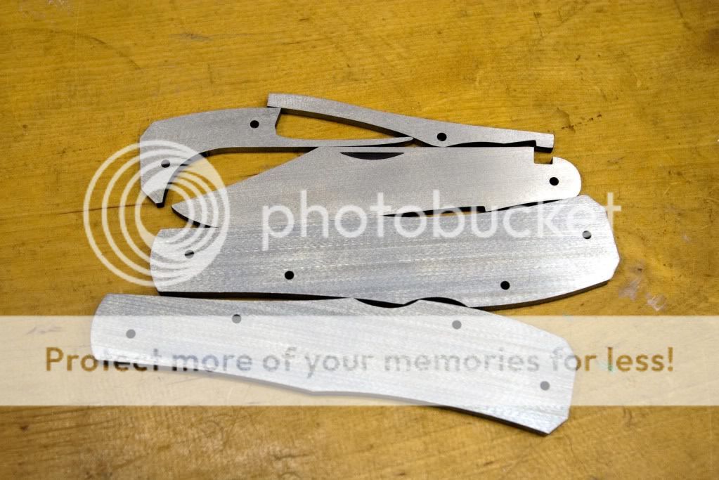

When Tony Bose sends out a pattern he scribes the parts on thin sheet stock.This picture shows the pattern parts after I have cut them out and drilled the holes for the pins.

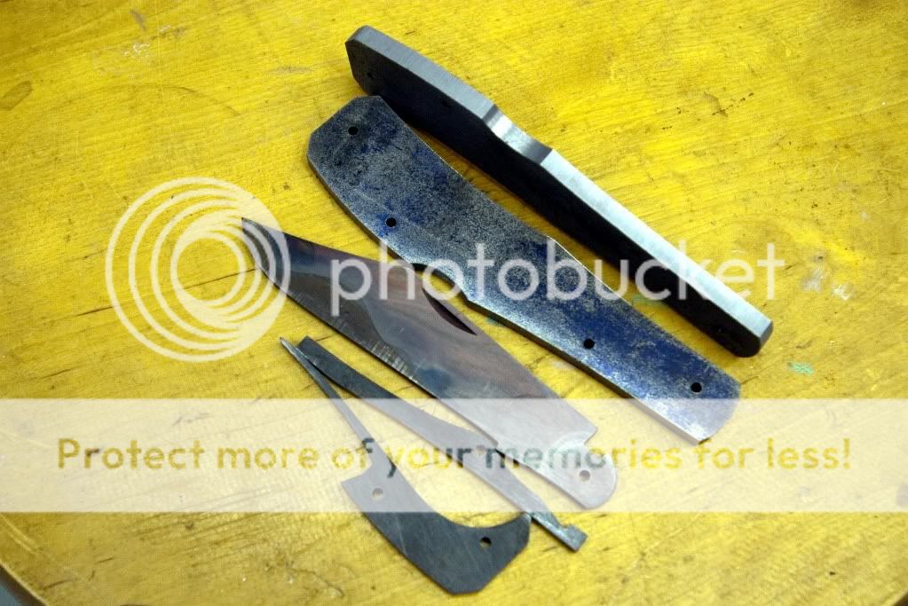

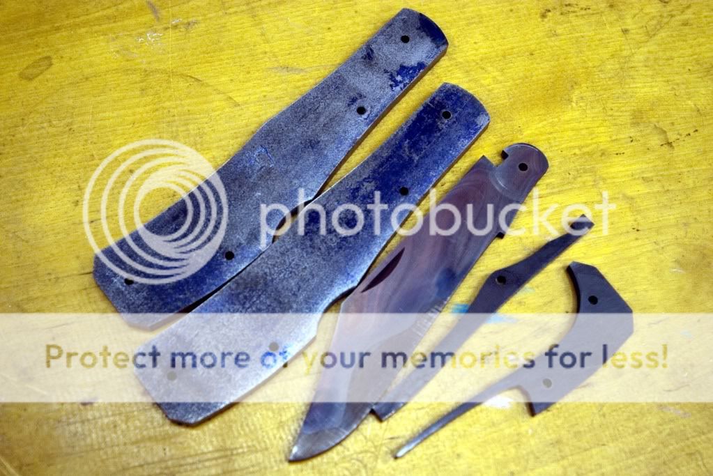

Here are the 5 major parts cut out and heat treated. Two 416 3/16 thick frames. One CPM154cm 1/8 oversize blade, one locking bar and one locking bar spring/frame filler. I have already cut the nail pull. When fly cutting pull's they need to be cut before the blade is hardened and tempered to 59-60RC
Sharp eyed formites (is that a word?) may noticed I have already played around pivoting the blade in the frame to get a feel for things. My next step on this knife is to surface grind the insides of the frames nice and flat with a decent finish. I do not do this on all knives at this point but I have found on large knives that this gives me a better foundation for fitting parts etc.

Ken, are the lines in the blade from oil quenching? Also, why did you heat treat the frames? Is that for surface grinding?
Steve
Oh wow!! I cant wait to see more. This is one of my all time favorite patterns!
Is there a reason for the liners being so thick!!?
Steve
Steve,
Good questions!
CPM154cm is a air quenched steel and must be wrapped in heat treat foil. As I open the package to plate quench(between my surface grinder chuck and heavy flat lapping plate) the steel will take on these colors.
I do not heat treat my 416 frames, what you are seeing is layout dye.

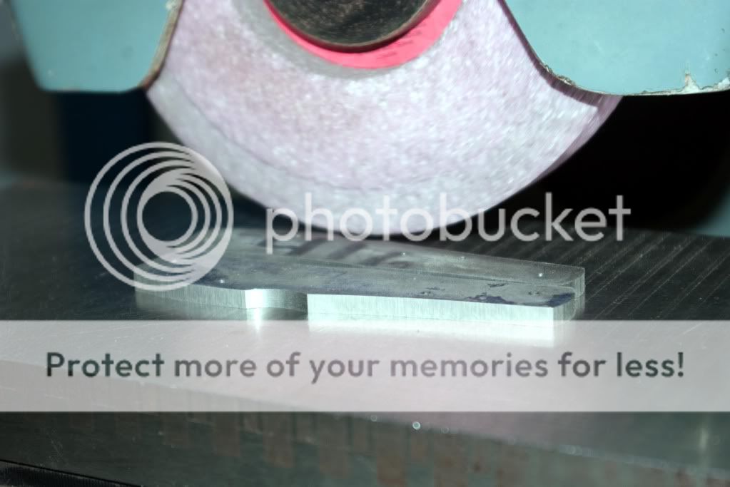

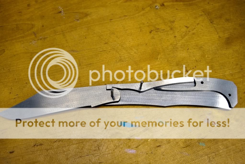

I have the two frame sides on my surface grinder ready to grind. I will clean up the inside then flip them over and grind to my desired thickness

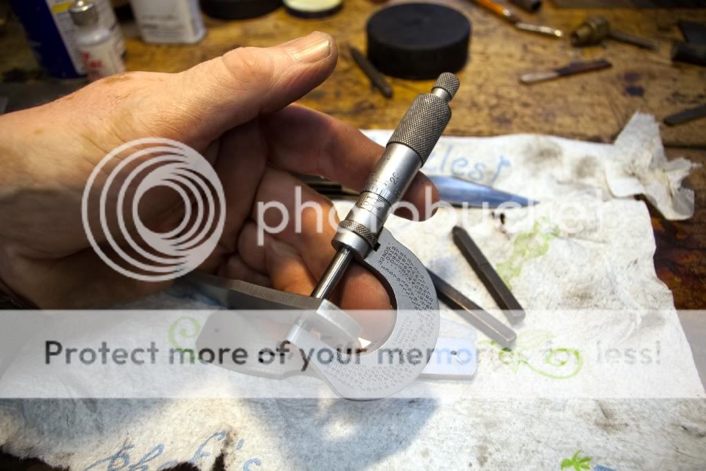

I use a micrometer to check my finished thickness. I want to insure on this knife that the overall thickness is the same as my working example

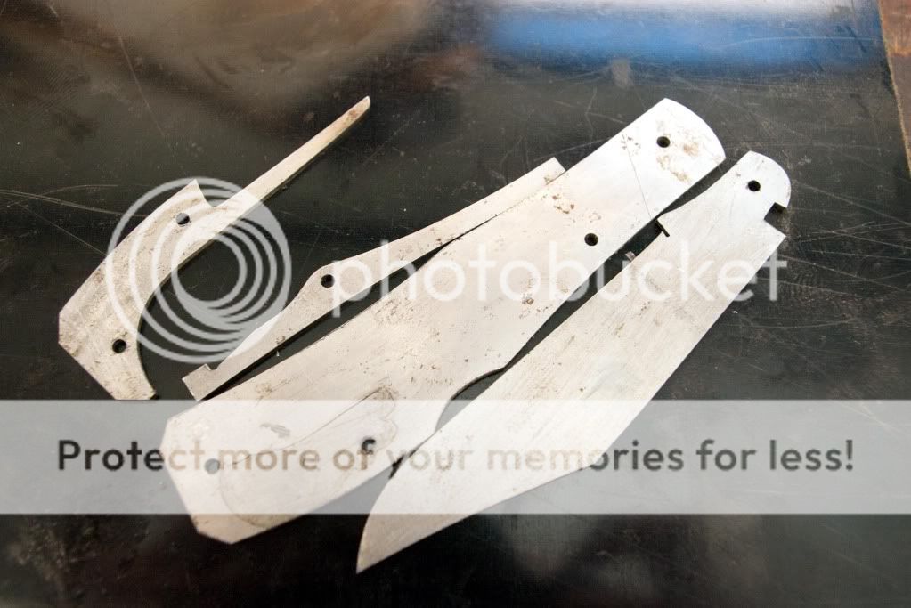

Here is a picture of all parts ground flat, parallel and same thickness as their corresponding part
This shows how the blade, locking bar and locking bar spring/frame filler interact with each other.
My next post will outline the fitting of the lockbar to insure it sits flush , both open and closed.
Ken
