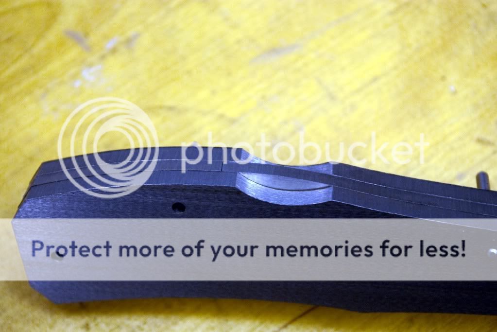

I have fit the locking bar locking tab into the notch in the top side of the tang. This assures that the blade has the right attitude when open. In other words, the tip of the blade not too low, nor to high in the open position. The next step was to make sure that when the blade was closed, (1) the tip was sunk into the frame, (2) the lock bar sits at the same level as when open.
These two pictures show how the rear most part of the lockbar sits lower in the frame when the blade is closed. This means that the lock bar must be lowered in front to raise the rear up. The first photo is with blade closed, the second with blade open.

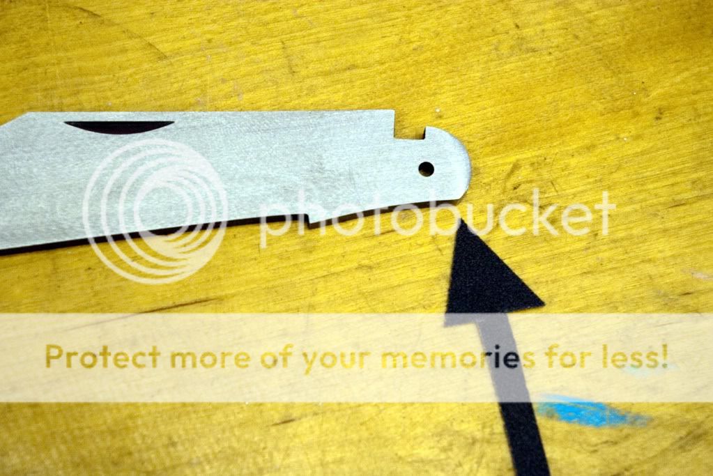

The arrow shows the point that I will remove a bit of material to let the lock bar sit lower in front and higher in the rear. A by product of removing material at the point alone is that the tip of the blade will raise slightly. Not a concern as I have the tip buried plenty low enough in the frame.

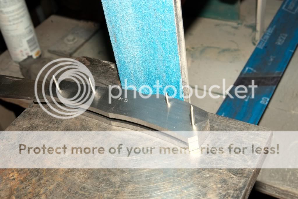

This is my home-built horizontal grinder that I use to remove metal in a radius while keeping things square
I am now removing material both from the frame,lock bar and the lock bar spring/filler keeping things square
