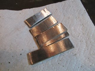

I start with a 1/4" piece of 410 SS, a 1/8" piece of 15N20, then a 1/4" piece of 01, then 15N20, and 410SS.
I grind the pieces clean, stack them up and use my wire welder to weld up all the seams.
Then I put the billet in my forge which is up and running and has reached over 2200 degree.
five pieces of steel, 410 SS, 15N20, 01, 15n20, 410 SS the pieces are 3" long and ground clean.

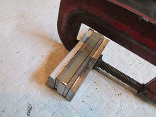

The pieces stacked up ready for welding. I use my wire welder to weld up all the seams. This is whats called a dry weld. No flux. The seams are all welded up so no oxygen can get in.
as soon as the billet is welded, it goes in the forge. The forge is already almost up to heat.

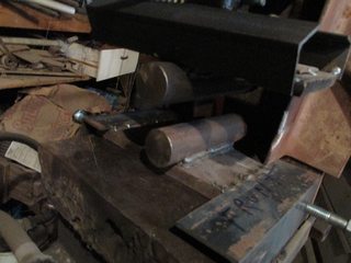

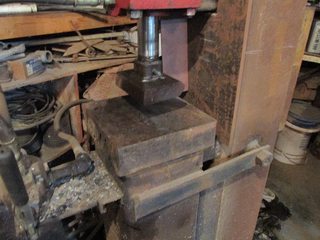

After the billet is up to heat it goes under the press for a quick press. I press both sides to keep the 01 centered.

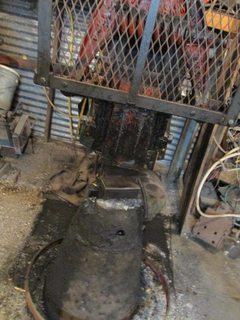

Next, after the billet gets up to temperature, it goes under a 100lb little Giant Power Hammer.
This is after the billet is drawn out with the power hammer. I hit the flats and also the edge of the billet. I try to get the billet to about 1/4" thick.

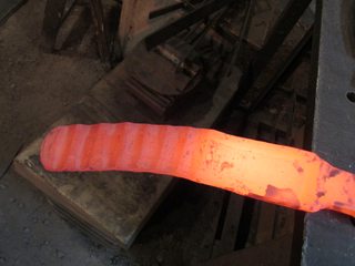

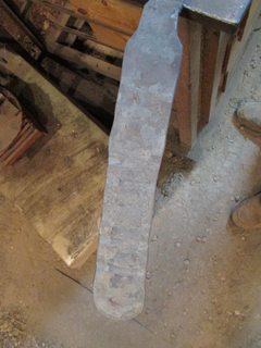

After another heat I go back to the press with these round dies. I want to put some ripples in the billet.

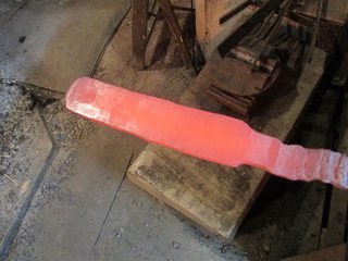

After the round dies in the press. I am making a full tang blade so I just use the round dies on the blade, not the tang.
Then after another heat I go back to the 100 lb little giant to smooth the billet out. After this I don't try to forge to shape. I want to keep the 01 centered. Also, I don't want to take a chance of the billet coming apart.

JT, I didn't build my press. I bought it used. It is not the best, but it came at a good price. I can take more pictures if that would help, but as far as the details, I don't know since I didn't build it.
Tom after you hit it with the round dies, you just flatten it back out with the power hammer? That doesn't just straighten the layers out? I was thinking I'd have to grind it closer to flat before flattening it out when I tried this again. But I would be flattening in a press if that makes any difference.
Kuraki, after I hit the billet with the round dies, I just flatten it back out. You would think that would take all the pattern out, but it doesn't. I know with a ladder pattern you grind off the high ridges before forging, but the way I am doing it will also leave a pattern. At least that's what I expect.
JT, I will try to post some pictures of my press. I think there are lots better designs, but mine came cheap and with my power hammers, I usualy just use the press to set the weld.
