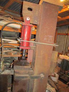

JT, this is a better picture of my press. I don't think it is a very good design and would not recommend anyone make one like it. As I have said, it didn't cost much and does what I want it to do.

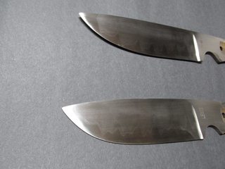

Today I profiled the blades. I am making two. I did stock removal because I wanted to grind off all the welding along the edge of the billet. After straightening the blades I put them in my Paragon oven at 1350 degrees for two hours. I also placed some large pieces of steel with the blades so they will cool slowly. I will let them cool all night. I have found this to be the best way to anneal the blades.
Tomorrow I hope to grind and heat treat the blades.

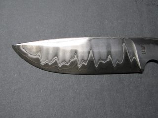

So far I have shaped the blades, heat treated, and hand sanded to 400 grit. I will go up to 1200 grit and then etch with FeCl. The picture is not very good, but maybe you can see the pattern. After etching it will be easy to see.
Today I went up to 1200 grit, then dipped in 3-1 FeCl for 30 seconds. Neutralized with windex and baking soda. This is what the finished blade looks like.
