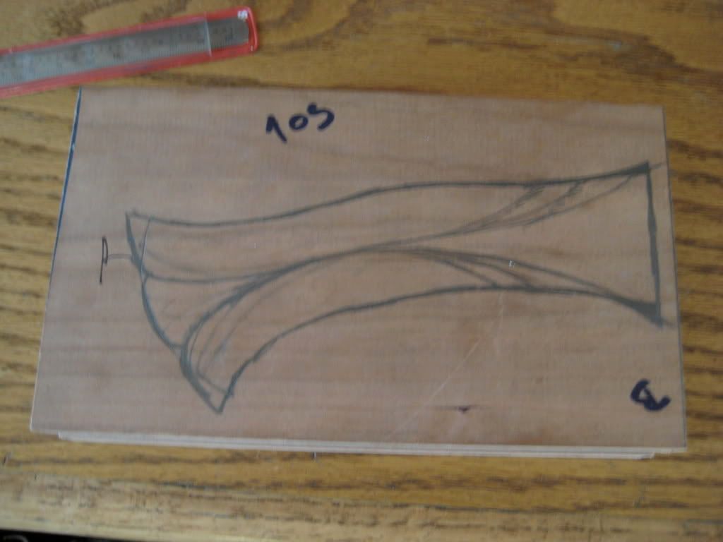

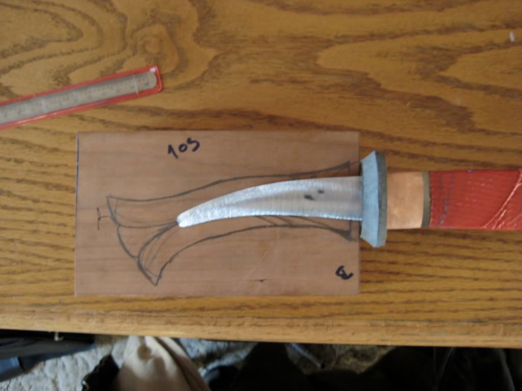

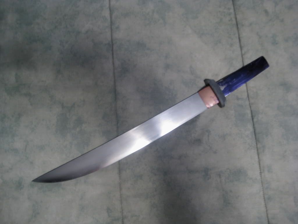

got out into the shop for the first time in several weeks and really the first time in over a month. i had a hard time deciding what do with this blade. it started out as a machete, then became a tanto blade (hence the habaki) then i thought it wasn't quite a tanto blade... so i decided to go more of a filipino style with it.
here is what i came up with.
i have never done carving like this before, so if you have some pointers they would be greatly appreciated! if you have any critiques, i haven't finished it yet.. so please let me know what you think!
the blade is 1095 micarta "tsuba" and the wood is cherry.
thanks!
~Chris

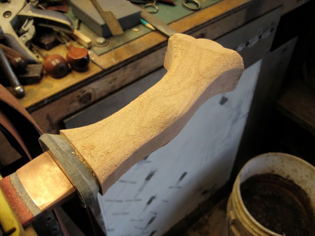

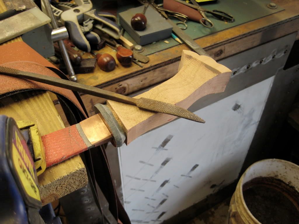

hey guys!
i am working on the handle, and have some pictures:
next step is to do the sheath, then polish the blade, then do the final carving. or that is what i am going to try anyway.
thanks for looking, i would appreciate any help you can give me.
thanks
~chris

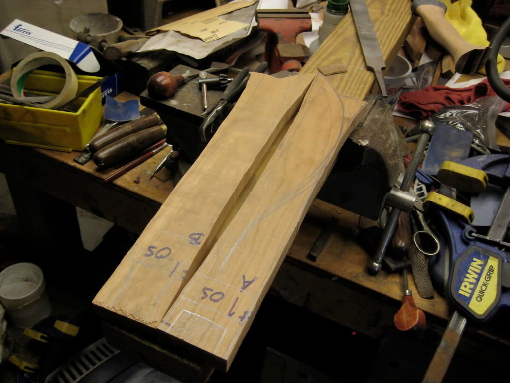

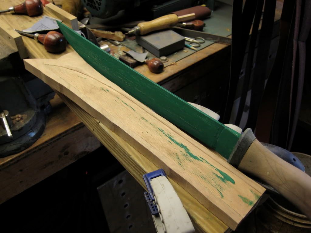

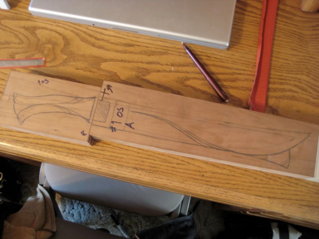

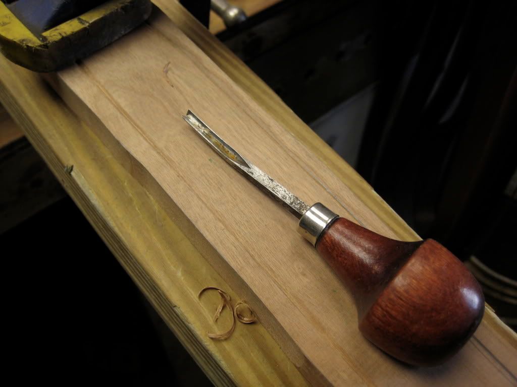

hey everybody!
more pictures! i did this yesterday. i love not having school or work, i can get SO MUCH DONE!!!

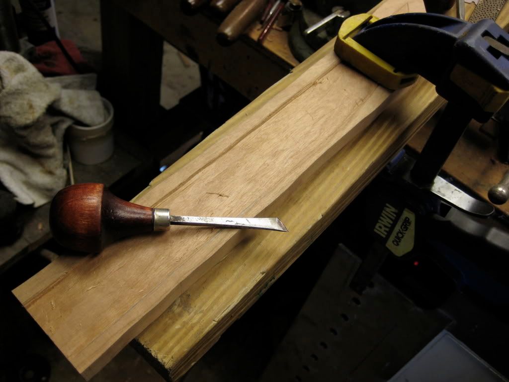

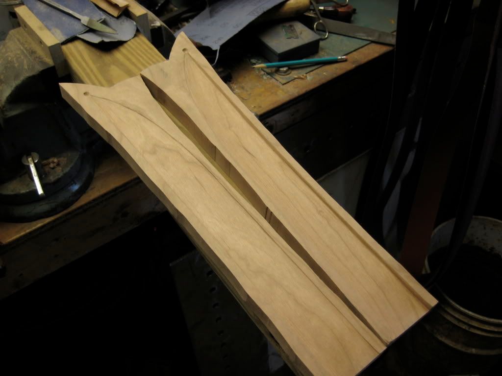

Sheath wood blanks
chiseling the rough shape
deepening the profile
using crayon to pick up the high spots (model-making trick)
all cleaned up and ready to be glued

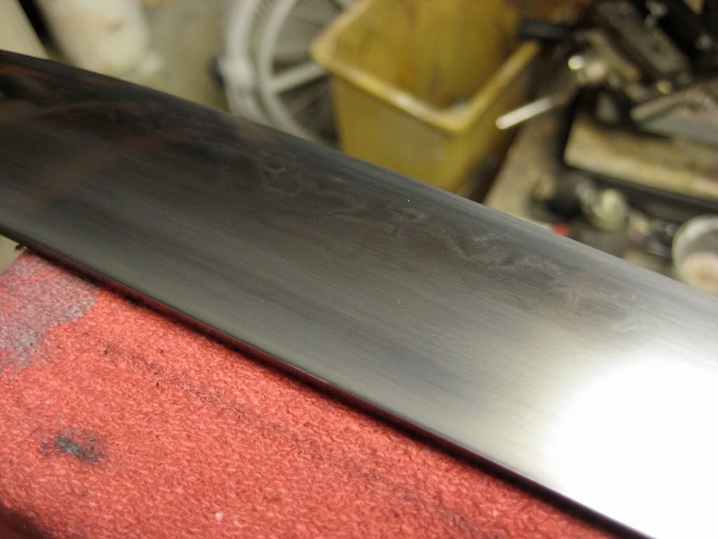

blade fresh out of etch.. wish i could get it to look like thats as a final product
hamon preview:
the sheath is gluing, i use a real strong but really slow epoxy, so it wont be ready fo a bit.
next step is to finish teh blade and components, attach the handle,then shape the sheath before starting the carving.
thanks for looking!
~Chris

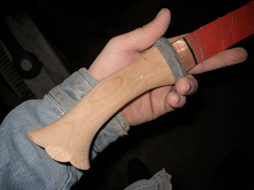

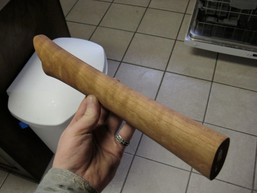

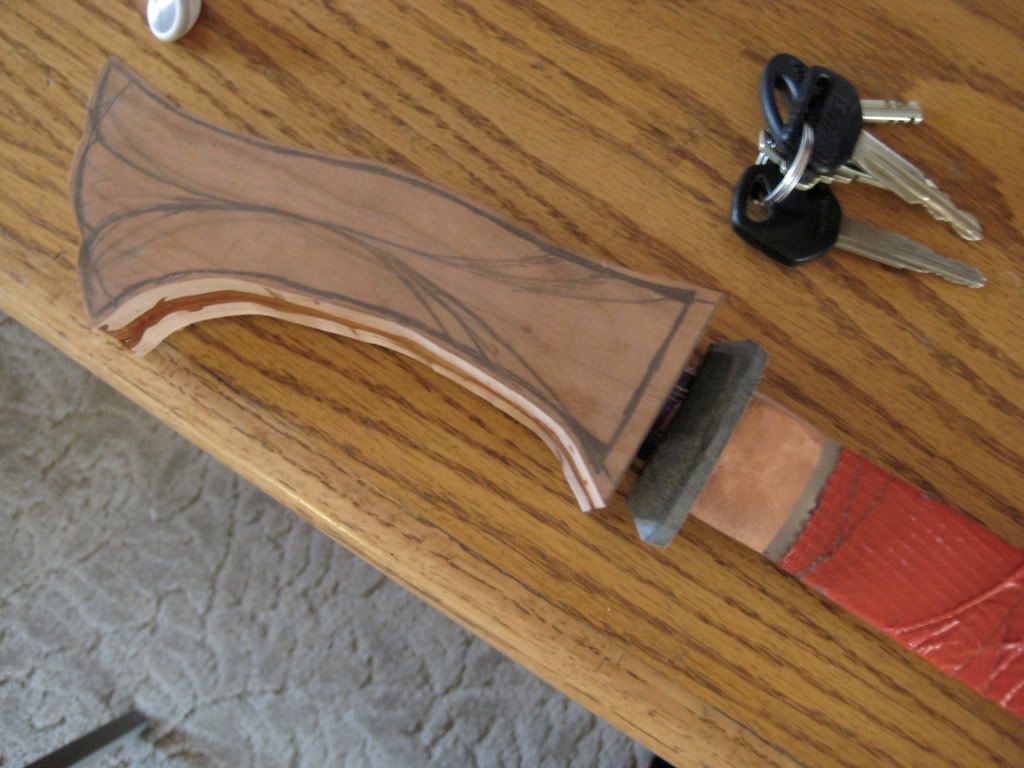

hey guys!

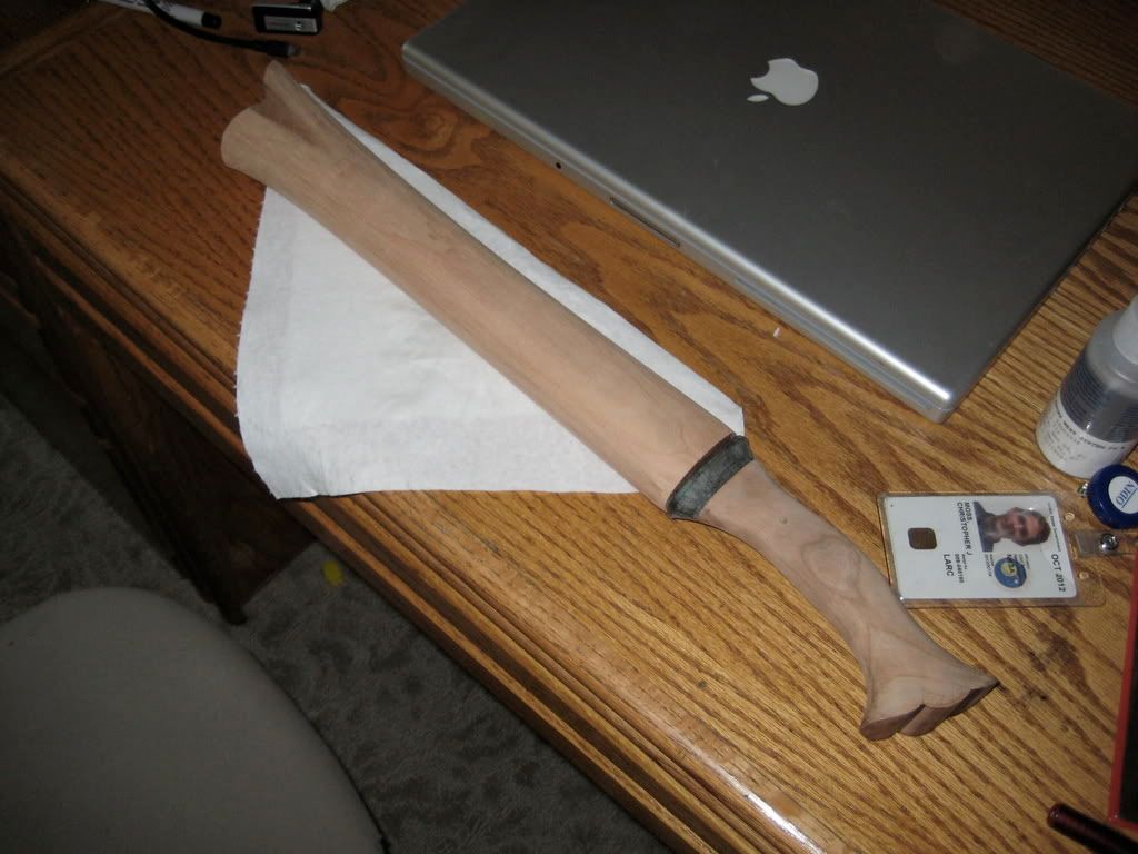

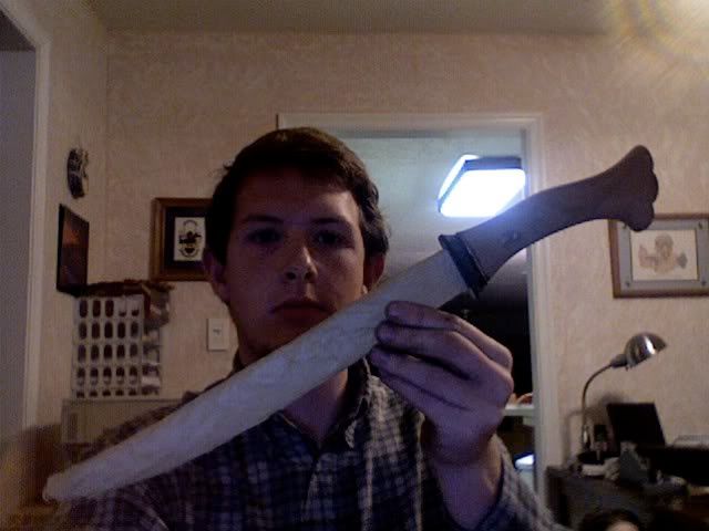

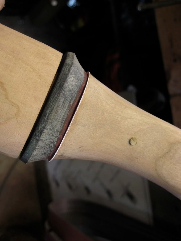

had a bunch of school to do, so didnt get very much done, however, the handle is all glued up so i can finish it, and the sheath is rough shaped.
i took a picture to try and show the "tiger" stripe in the cherry. i also put in the copper transition, to tie in the copper habaki.
gonna pencil in the carvings on the sheath and then on the handle after shaping.
and then a pic for size...
thanks guys!
~chris
