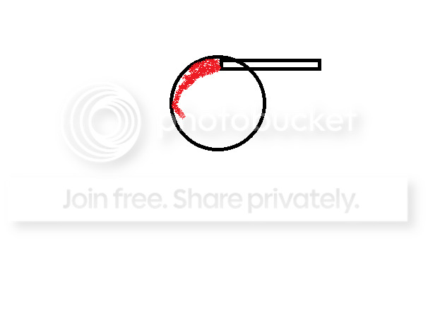

Okay - from the "Picture is worth a thousand words" department: I did this quick sketch - I think this is what you were describing, look right?
Scan
That's what I'm getting from what he said. I'll let him answer though.

That is more or less the setup.
The burner tube and flare will need to be run farther in than the sketch, though. Somewhere about the middle of the insulation layer works good. Play with it and you will find the sweet spot. You can usually hear when it is at the right spot.
Two sets of three clamping bolts are better than one. Place one set at the end of the guide tube and one set as close to the forge shell as is practical. This allows for better alignment and firmer clamping.

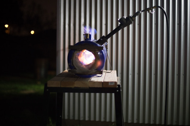

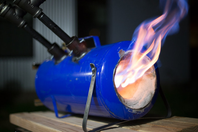

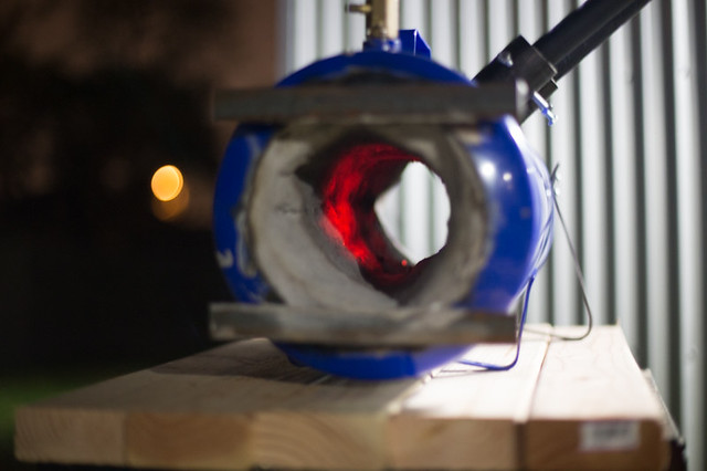

I fired it up briefly tonight to drive out the moisture from the satanite. A few pics. Need to figure out how to modulate the flame a bit - I was running 3 psi and played around with the choke plates I made a bit - it seems like even 3 psi was giving me lots of flame overflow.
