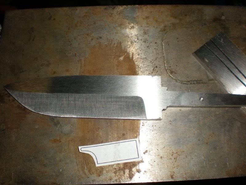

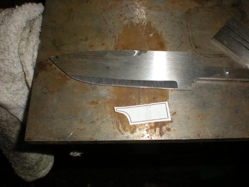

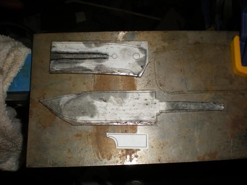

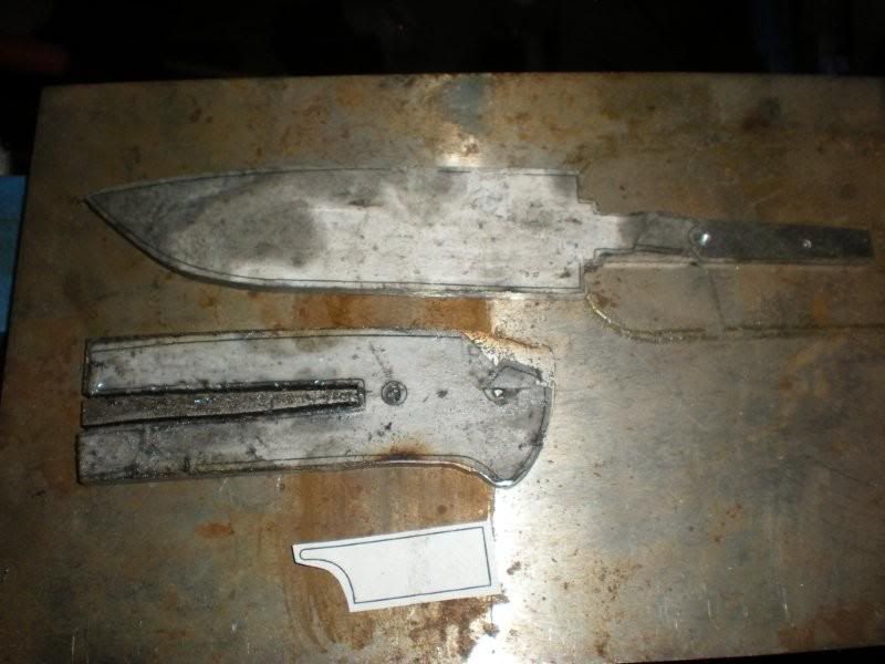

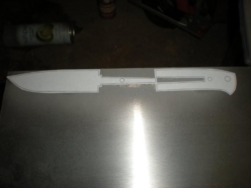

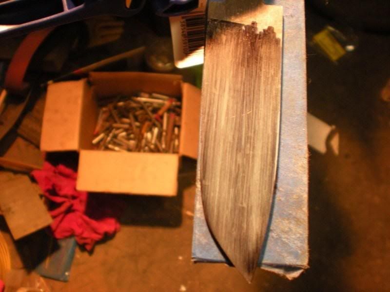

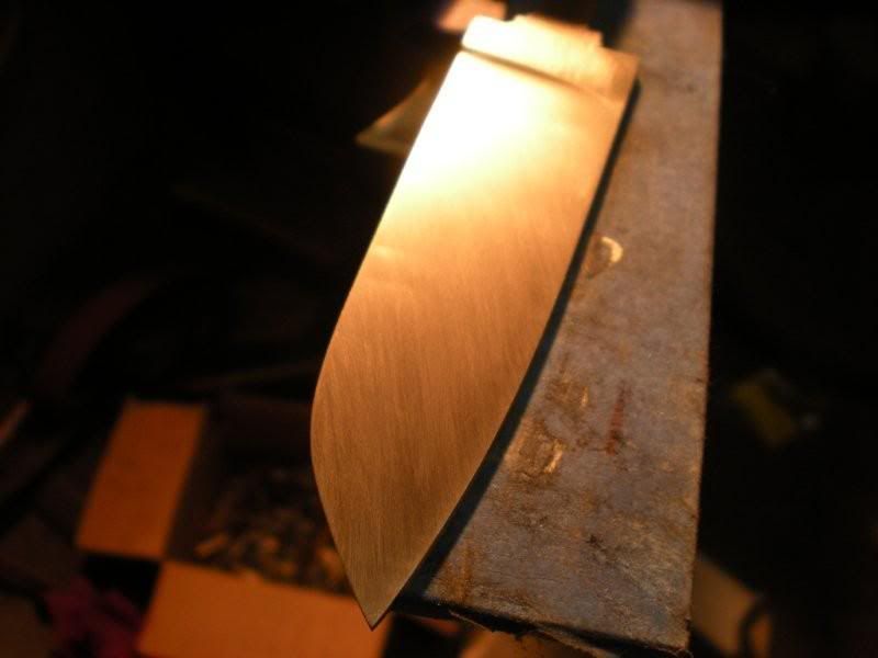

Well, I've been wanting to do a WIP so I figure I'd start one on one of my newest ventures...a Loveless style drop point. Now, since I've never seen how to actually build one, this is my best guess / effort. Let me know of any suggestions, etc.

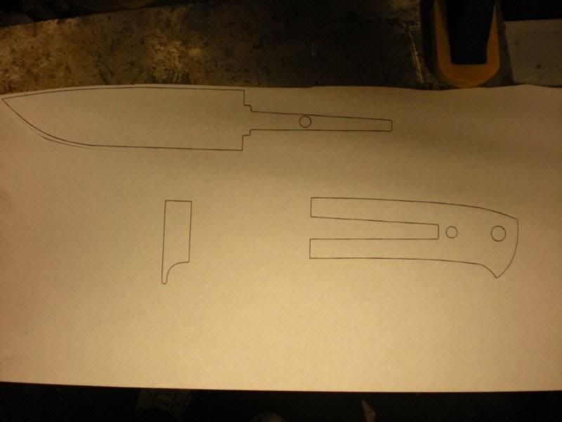

I started out with a plate of CPM-154 and my pattern. I can't draw worth a sh*t, so I design all my blade on the PC with CAD and then print out my templates.

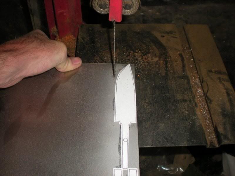

I cut out the template and size it up on the material and using 3m Super77 or HangTite, I paste the cut out on my steel

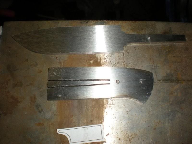

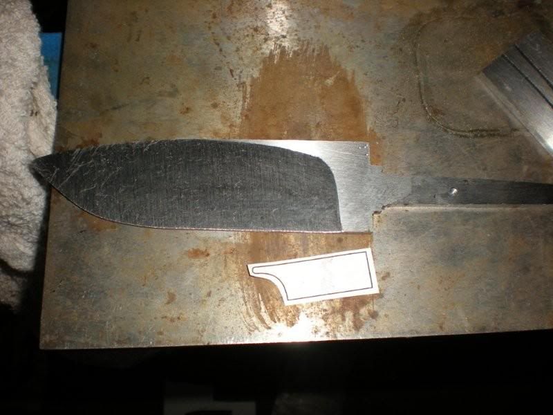

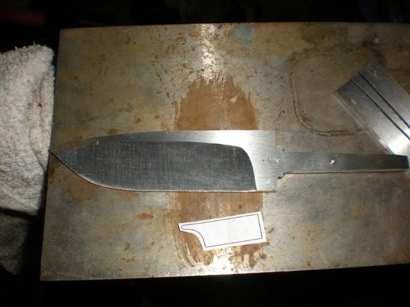

Then using my high tech (read Harbor Freight) bandsaw, I start roughing out my pieces. I usually Dykem the template first because the paper cut out doesn't hold up real well to oil and grinding but I ran out.

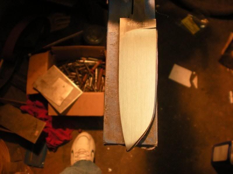

As you can see, the paper is almost toast but here they are roughed out.

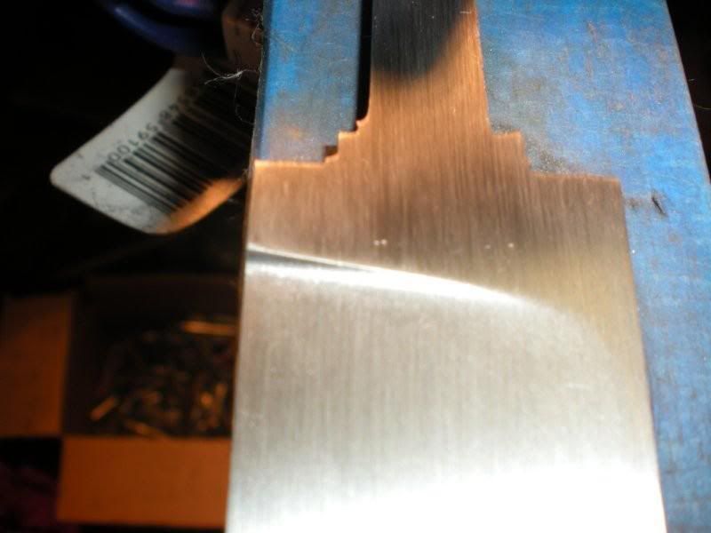

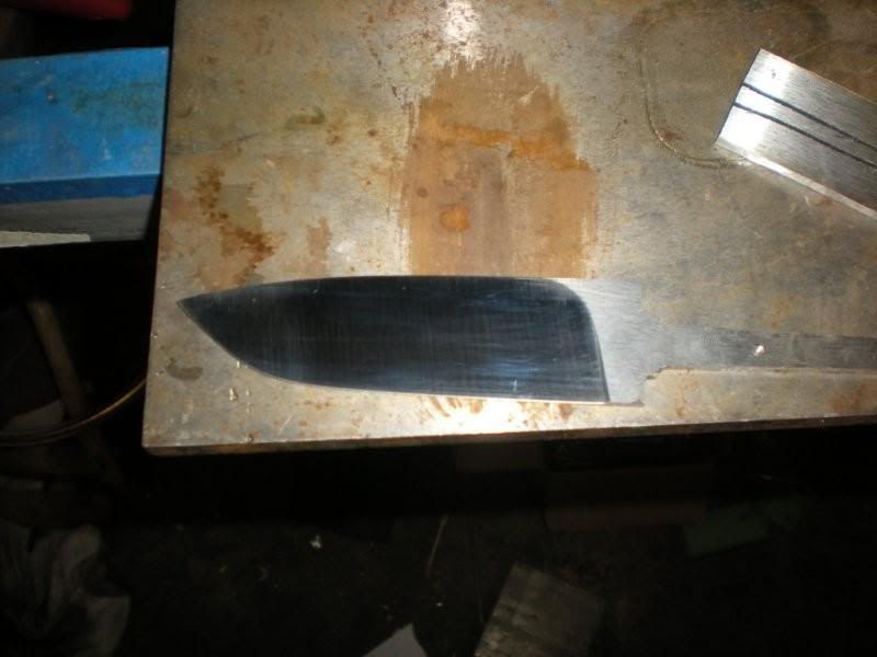

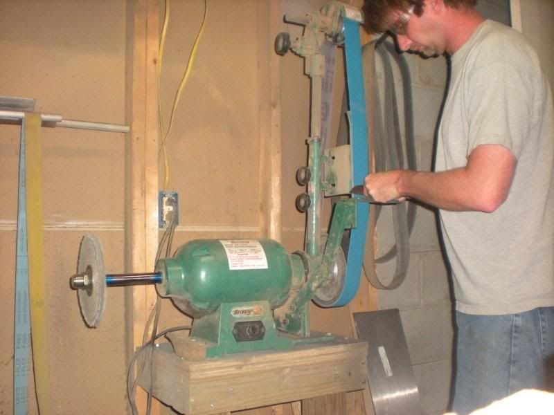

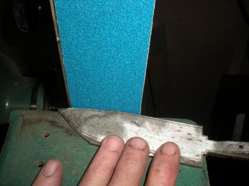

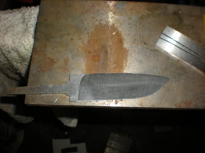

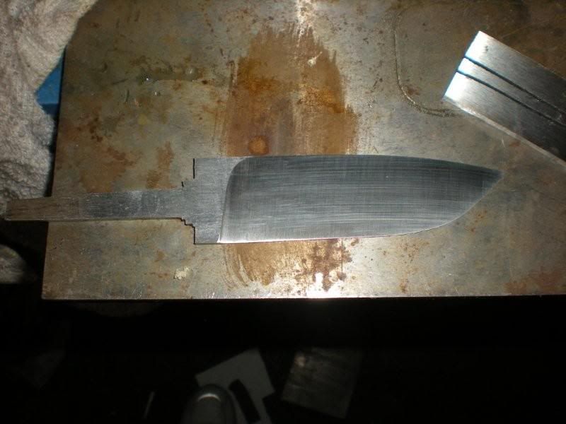

I strap up the Grizzly with a 60 grit and do my profiling
