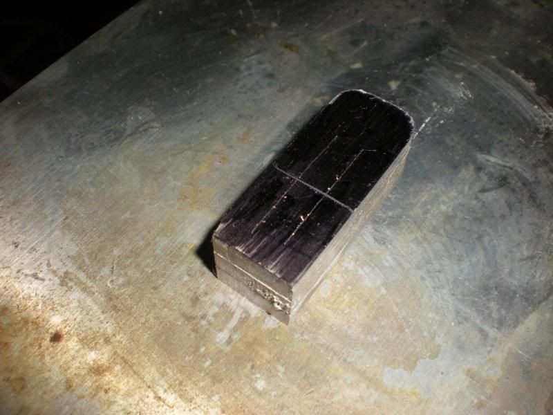

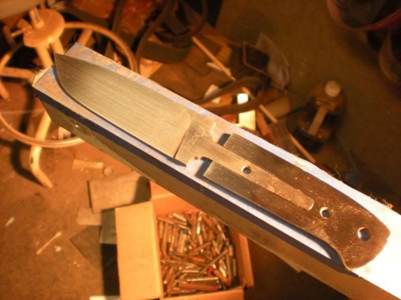

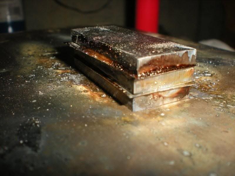

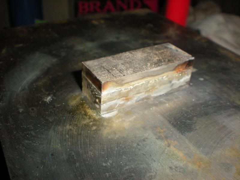

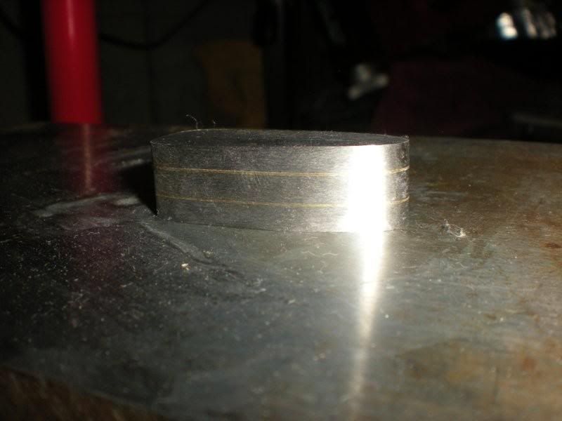

Then using my high tech (read Harbor Freight) bandsaw, I start roughing out my pieces. I usually Dykem the template first because the paper cut out doesn't hold up real well to oil and grinding but I ran out.
As you can see, the paper is almost toast but here they are roughed out.

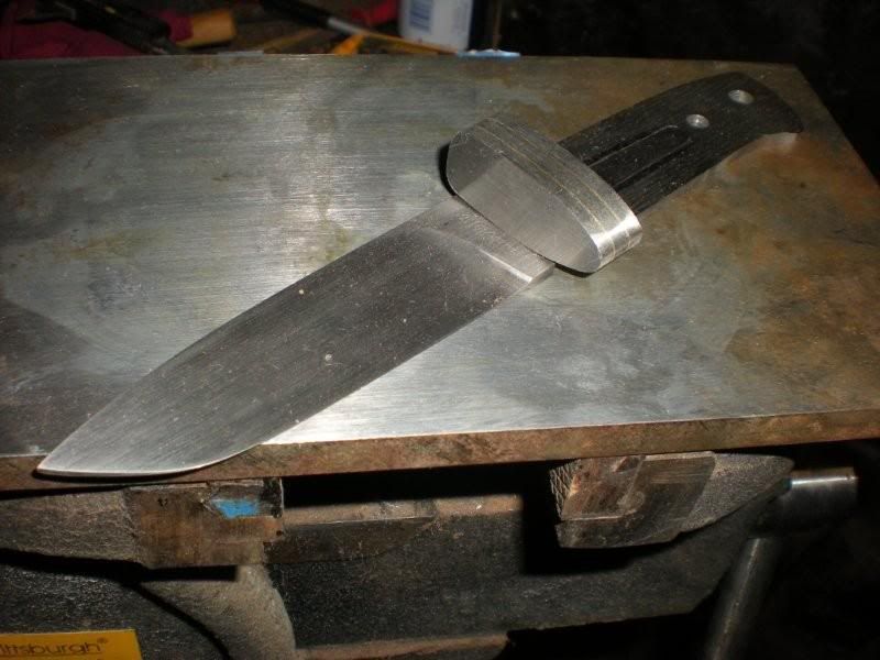

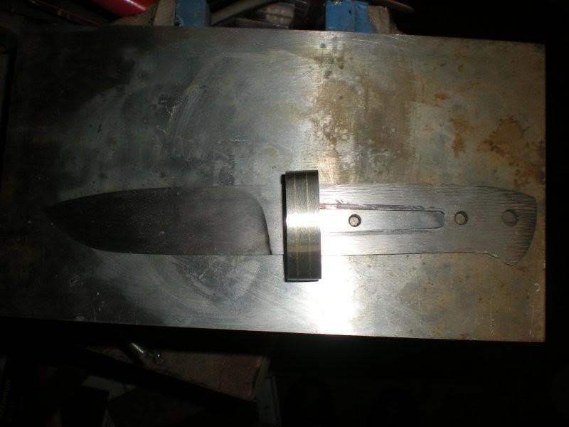

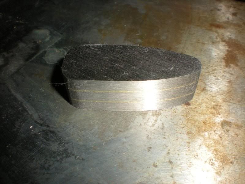

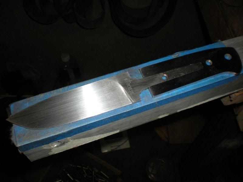

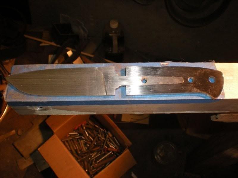

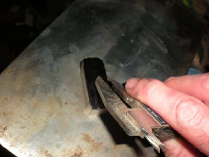

Basically in a framed tang design, you get the benefit of having a slide on guard over the stick tang and the option to use thinner slabs for the tang frame, thus giving you a full tang look. I could have done a mortise tang also, where you carve out the place for the tang between two slabs and then join them together as one, but that's for another threadI'm a knife newb here, so Ive got a dumb question.. Why did you make a separate piece to go around the tang??
If you take THIN CA glue to the paper template after it's set in place on the 3M-77 it will hold up MUCH better. You can even dip it in your cooling water and not destroy your layout lines.
The guard as opposed to bolsters
