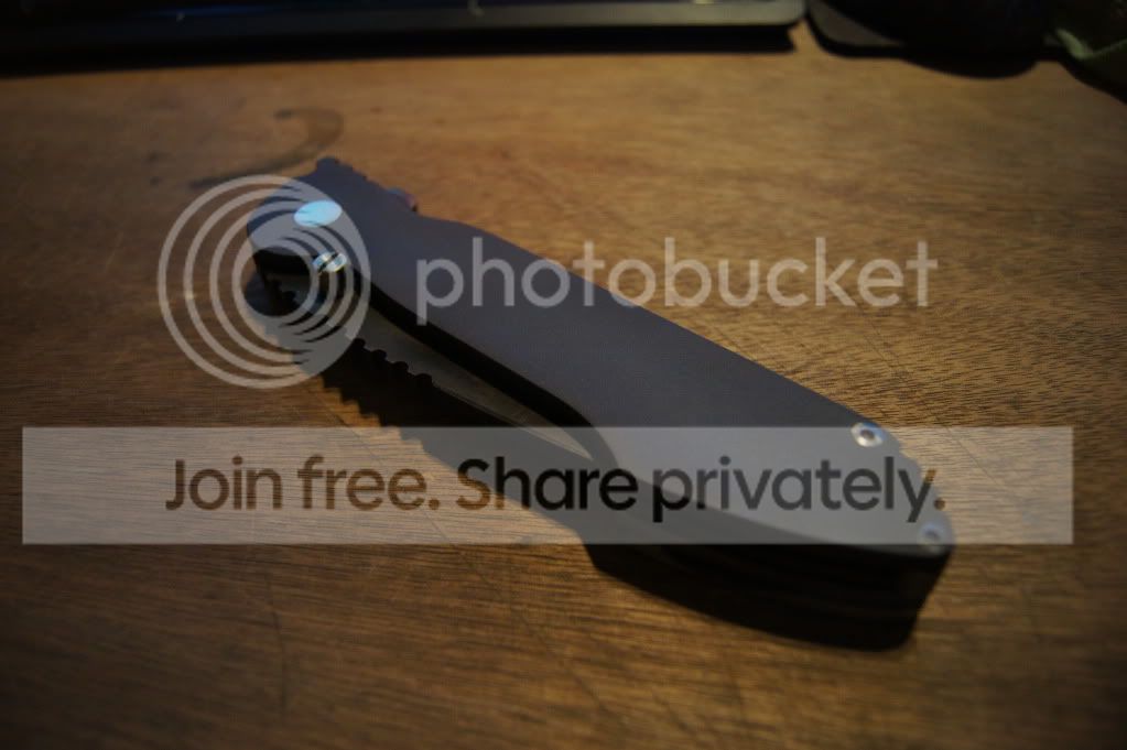

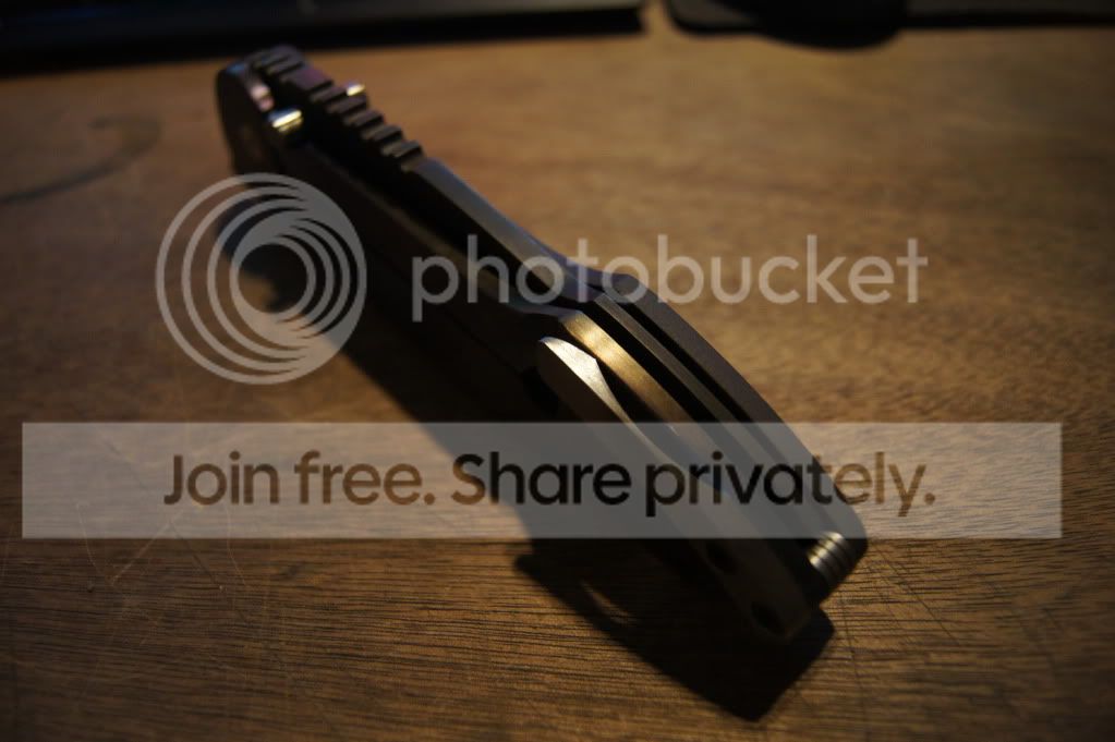

OK so update! If been playing with a few different finishes for the Ti slabs. Here is a bead blasted finish with a deep blue/purple heat anodize, it feels so smooth and grippy. I love it! Here also is the brushed finish with a flame job that is more varied from straw to purple. Also I finished and installed the pocket clip. The retention for the clip is very good, great for heavy duty fabrics and jeans. I don't think dress pants will work...lol It has been left unfinished for now. I must carbidize the locks, set the detent on blade, finish the thumb stud and of course put a razor edge on it.
I really need access to an accurate scale to give you a final weight. Hmmm.

Hell I'm holding them both right now and I'm torn over which I like better! The bead blasted finish is really growing on me. I even like it two tone with right and left scales having different finishes. This is a custom knife after all, no need to hide the fact that this knife is quite a bit different. lol

There will be 4 possible mounting locations for the clip all of them tip up. Left/right deep pocket carry and left/right shallow pocket carry. No tip down carry sorry. Fear not, the 3/32 detent is very positive and secure.

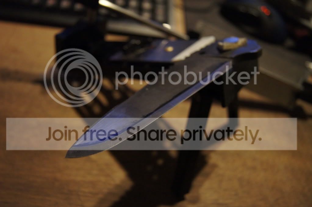

Just finished setting the final bevels at the edge at 100 grit. I'll step it up and put on a mirror finish with my chosera stones and snap some pics ASAP.
Used my Edge Pro to set the final bevels at the edge with 60 then 100 grit. Dykem layout blue helped track my progress and keep the grind consistent. I will take it up to a mirror polish, hand sand the blade, and force a dark patina on the steel with FeCl.
