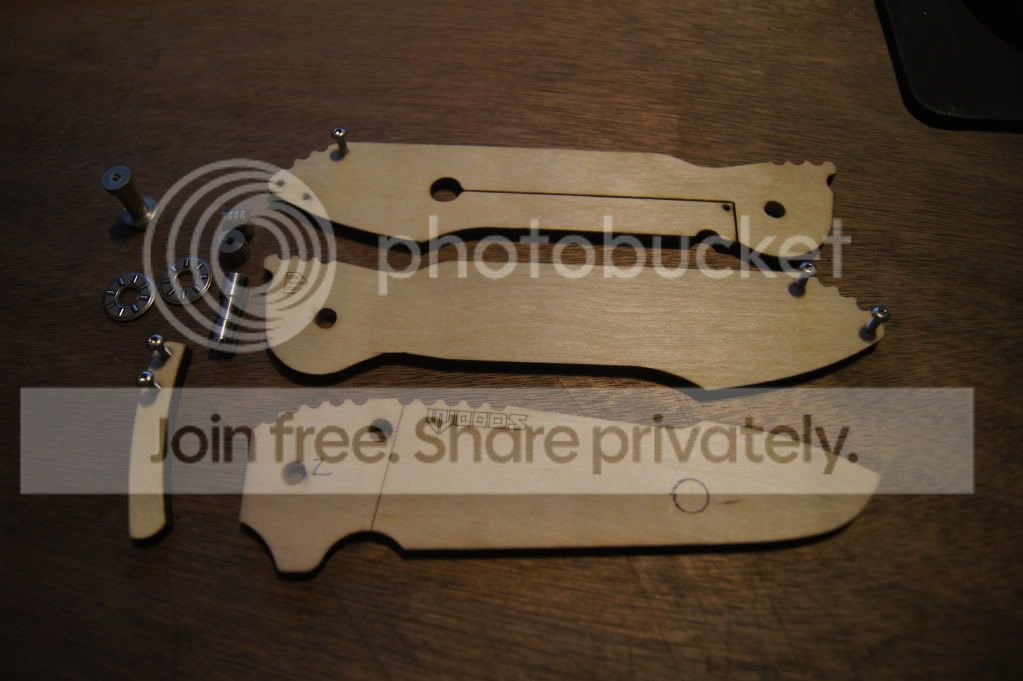

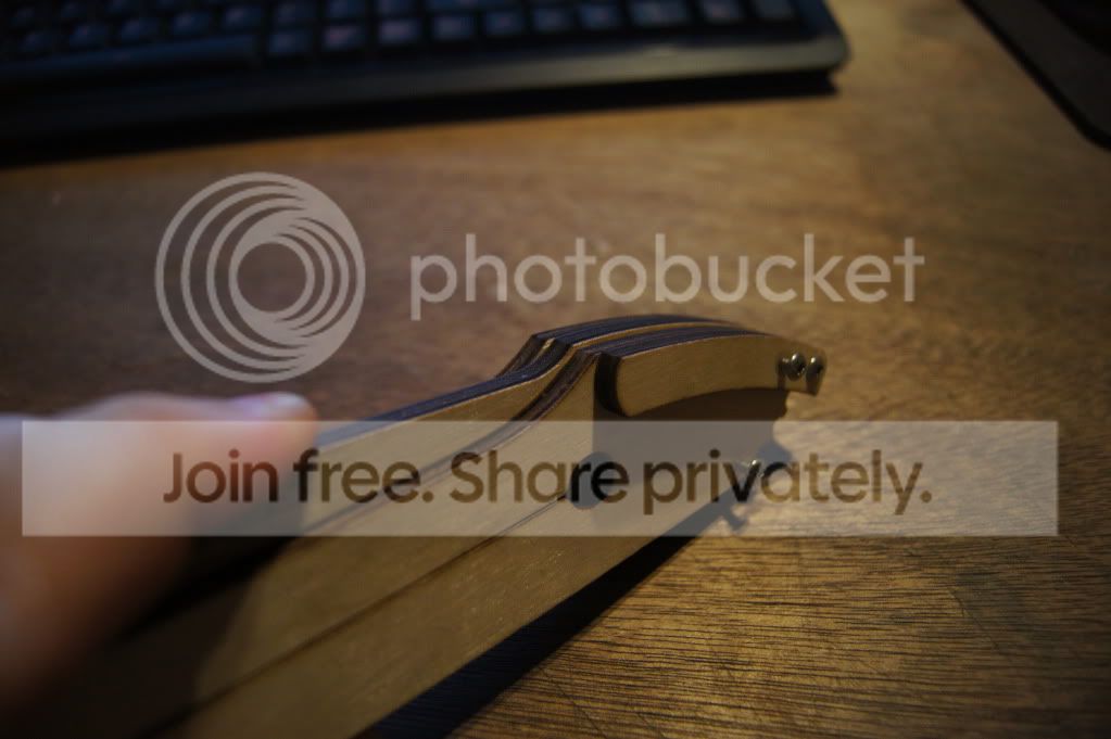

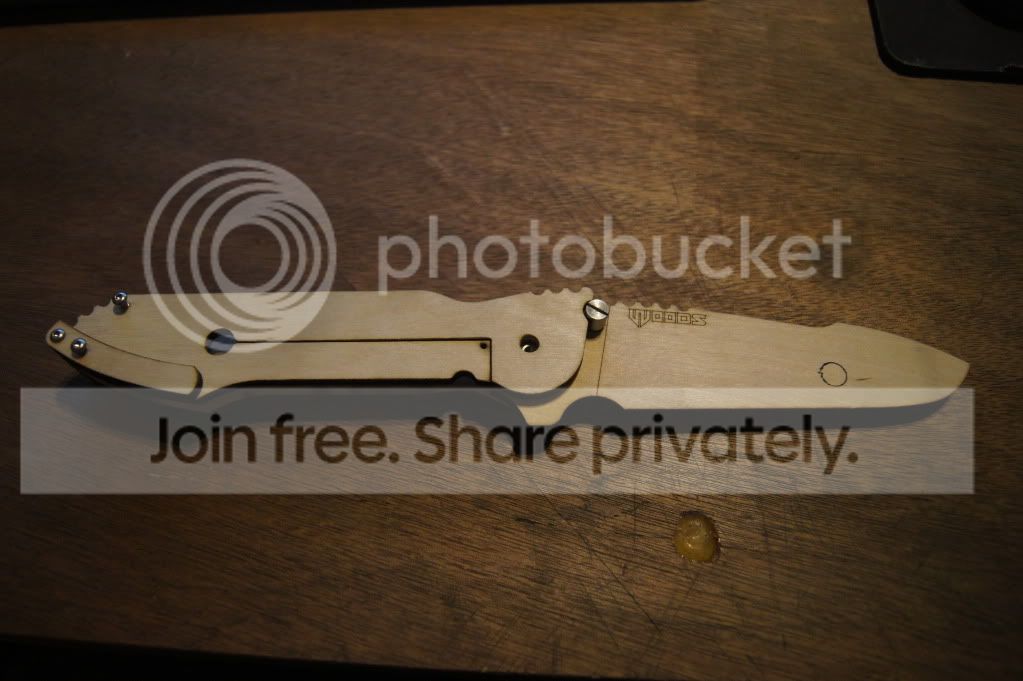

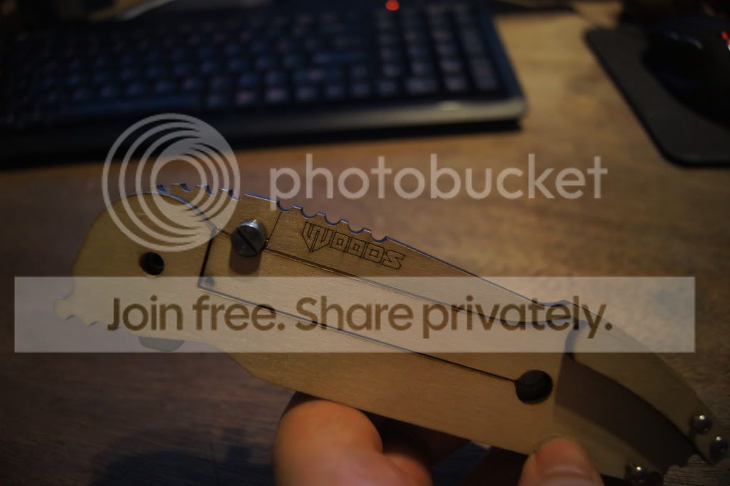

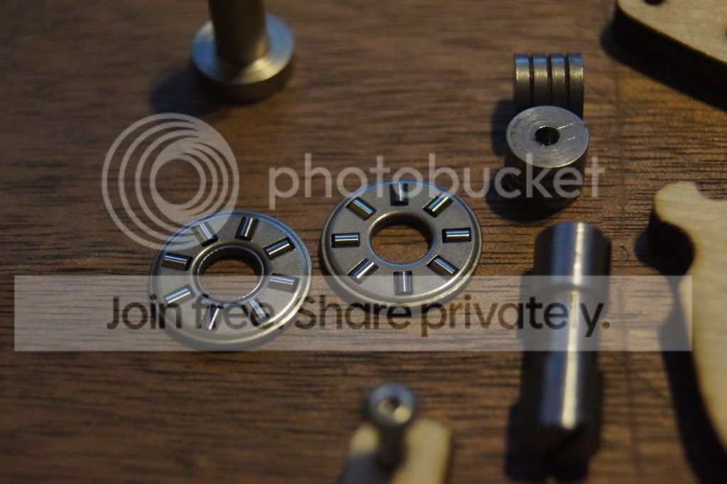

He are some components and laser cut plywood mockups I did to test grip, function, and fit.
Theres that ol saying.. "the proof is in the pudding" that is a nice one, and that plywood mock up is killer!!! Great job!! You must own the laser? and do use the solid works program?
I'm a product design graduate student at the Savannah College of Art and Design so my day job is running the digital technology lab at night. That means full access to a fleet of machines like laser cutters, 3D printers, CNC machines, and large format printers. The program I do all my 2D and 3D CAD work is Rhino3D but I am more than familiar with SolidWorks and a half dozen equivalents. My thesis is focused on entrepreneurship and edged tool design so i get to play around with designs like this in the middle of the night "on the job".
