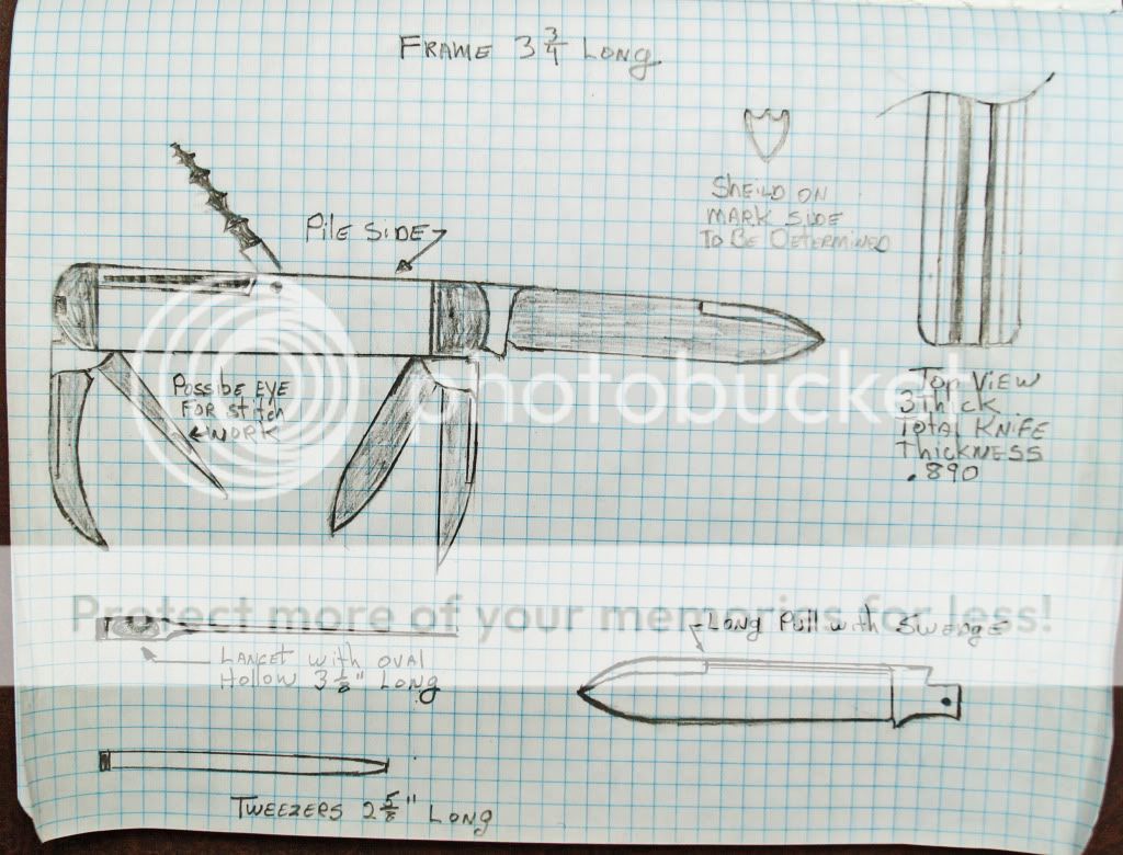

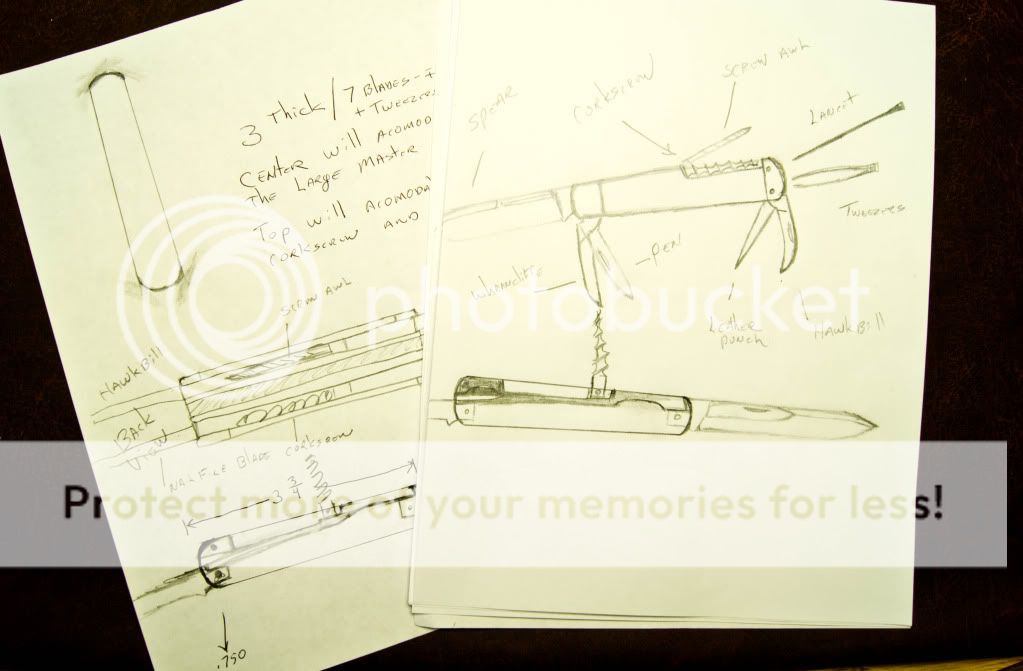

Well over a year and half ago or so I was asked by a member here if I would be interested in a sheffield styled lobster. I responded by saying "of course" and after much back and forth with ideas etc we have finalized a basic pattern. The knife is based on a scaled down sportsman's knife featured on page 202 and 203 of the Sheffield Exhibition Knives book authored by Claussen/Watts and McMickle. ( I am pretty sure I cannot take a photo of the page and post it here). Anyways the knife pictured in the book is large,5 1/4 and five thick. My customer and I have decided to scale down the project knife to 3 3/4 and three thick. This will leave seven (7) hinged blades/implements and two(2) removable ones. Since I have no pattern to go by to build this knife I will start by sketching out the knife, submitting it to my customer and making needed changes. This is a picture of my initial drawings. Keep in mind that things may change, including the selection of blades.
Here is a rundown of the blades/implements
hinged/
Spear master blade
small pen blade
small Wharncliffe blade
small hawkbill blade
three cornered leather punch
corkscrew
screw awl
removable/
tweezers
lancet
I have an extended time frame to finish this knife(Blade show in June) but I will update as I progress.
Here are my initial drawings

I had a chance to talk with my customer on this knife and made a few changes to the drawing. This drawing is much closer to scale than my first rough sketch. One of the things that we discussed is the lancet. He asked if I could incorporate a small powder scoop. My idea was to hollow out the one flat side to form this small scoop. My next step on this knife will be to make up a brass frame pattern , refine it and do the same with the blades.
I also double checked my math on the total thickness of the knife, should be closer to .660 not .890 :eek:

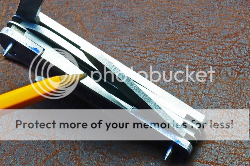

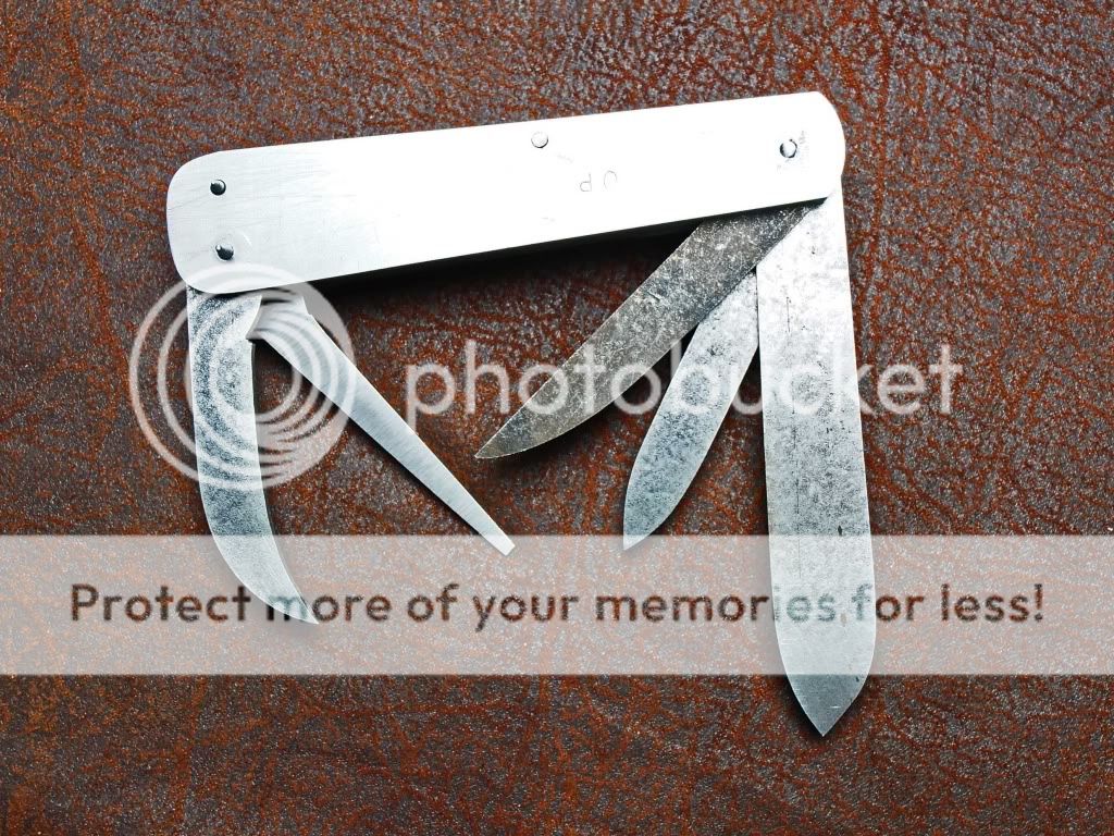

I had a chance to start cutting parts today for the sportsman's knife. Keep in mind these parts are very rough cut at this point and will require and receive much fine tuning and fitting. The major parts I do not have cut yet are the corkscrew,screw awl, lancet, tweezers and springs:eek:
Any questions and comments more than welcome!
Ken, that looks great! Quick question, it looks like the space between the two secondary blades on the side with the punch is smaller than the tang of the main blade, is this on purpose or just an artifact of the lighting/angle?
Vic,
Good eyes and question! There is nothing yet to keep the spacing correct. The backspring for the master blade will fill that gap and keep things even and parallel.

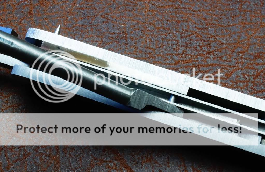

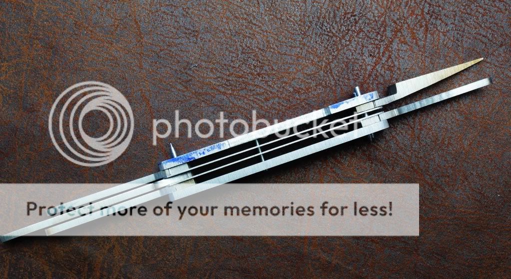

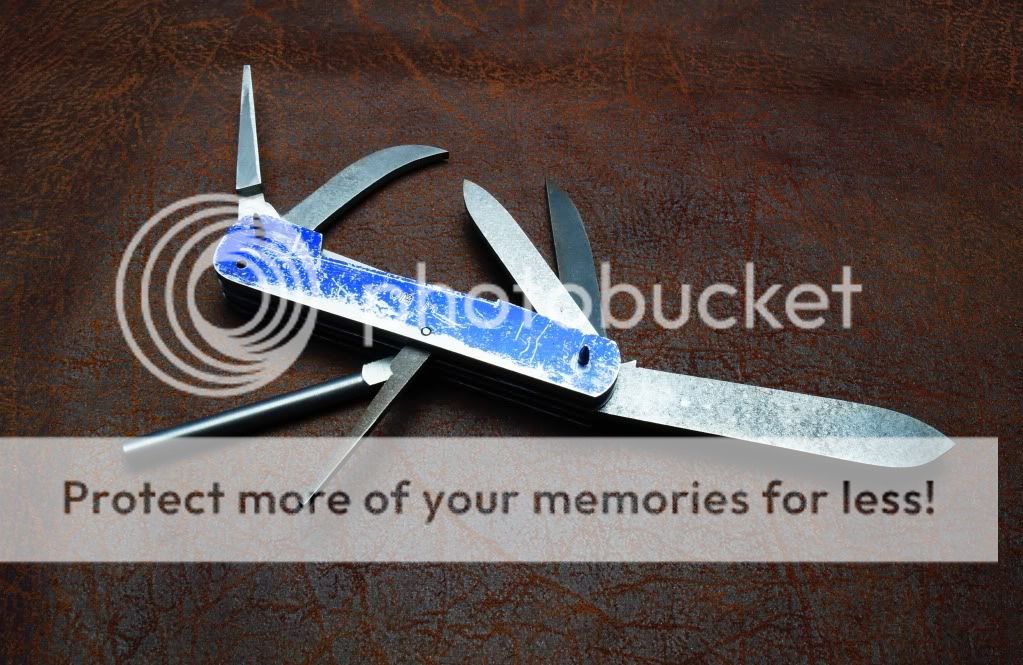

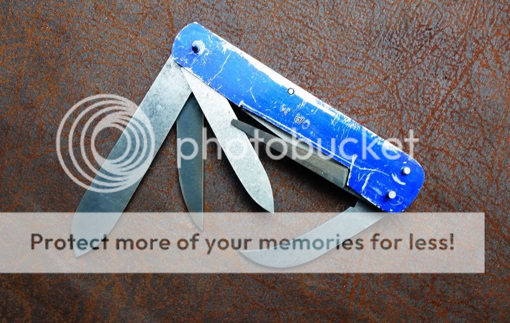

I did have a chance to get a bit more accomplished. I have all the hinged blades/implements roughed out. I still have the lancet and tweezers to make yet.
This picture shows the location of all hinged implements. The corkscrew is just roughed out at this point. I cut the blank from a thick piece of CPM154, then turn the round section on my Unimat lathe. The rest is hand formed using rat-tail files etc.
This picture shows how the pen blade will nest along with the leather punch.
