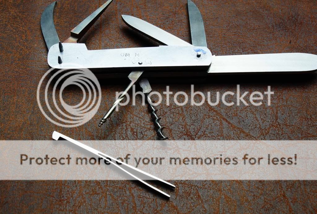

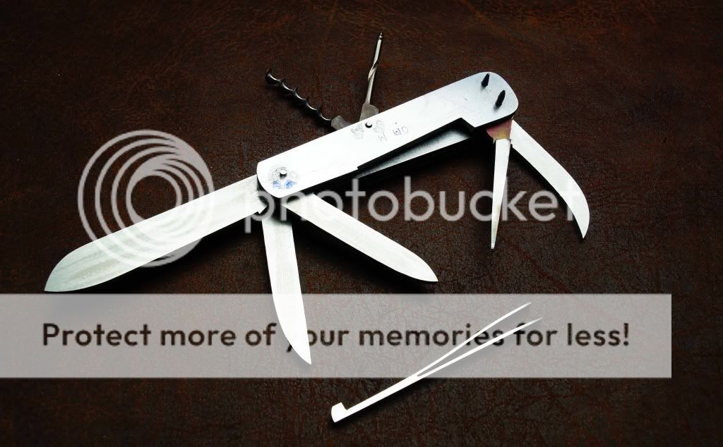

I had a chance to get a few things done on the knife today.

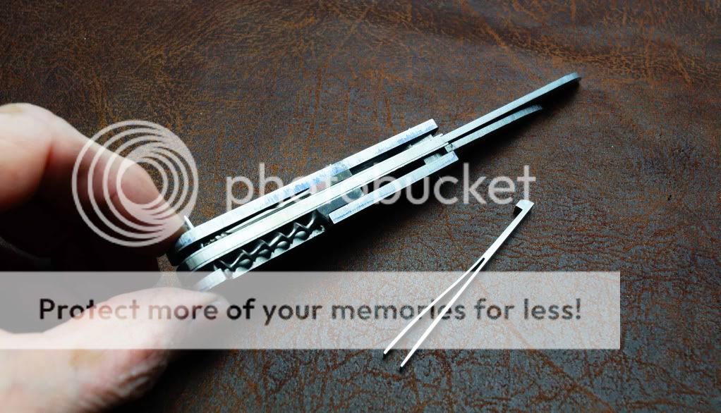

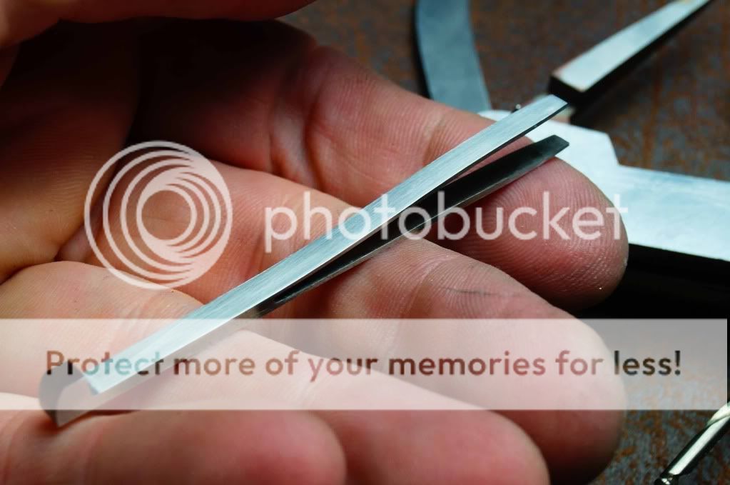

I made a slide-out tweezers , a first for me. I am happy with the results for the most part but I may make another one. I made this tweezers from a solid piece of CPM154 and while they work great they are just a hair on the large size for this knife. If I end up making another set at least I will have a cool tweezers for my shaving kit! Jury is still out on this one.
I also made the awl and the backspring for the master. Normally I would do all the heat treat at the same time, but in this case I really needed to fine tune the tang of the master and make a working spring before tuning the tangs of the pen and Wharncliffe blades.

Thank you for taking the time to show this work. Everything looks like it is coming together well. How in the heck do you grind those tweezers? The tips look like they will get the tweezing done. ;)
Even that does not look like much of a piece of cake to me.

They will grab ahold of the finest hair and yank it out, so I felt good about the function. I exchanged a email with Richard Rogers and he was kind enough to tell me how he does his. He uses spring stock and silver solders two pieces together and also solders on the stainless lug. I chose to try and make mine out of one piece of Cpm154 and heat treat to spring hardness. When I make another tweezers I think I will go this route but incorporate the things I learned on this set.
Grinding them was a challenge!
