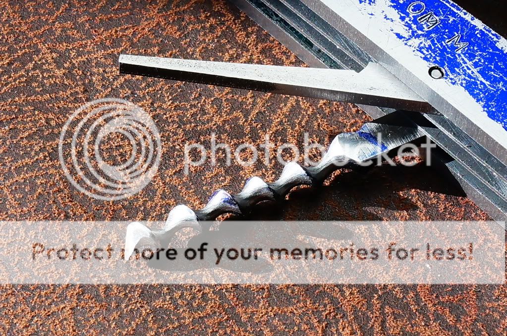

Fantastic to watch, thanks as always. I've always been curious to see how you do those corkscrews.

I did have a chance to rough out the corkscrew yesterday. It needs to be thinned perhaps 10% or so in the valleys yet.

Do you have any more pics of you doing the corkscrew? I'd love to see how it was done.
Thanks!
Sorry! These are the only ones that I took of the screw construction.

I'd be happy to achieve that corkscrew, let alone the entire knife!
Hand-filed and finished!! Must be magic!!
