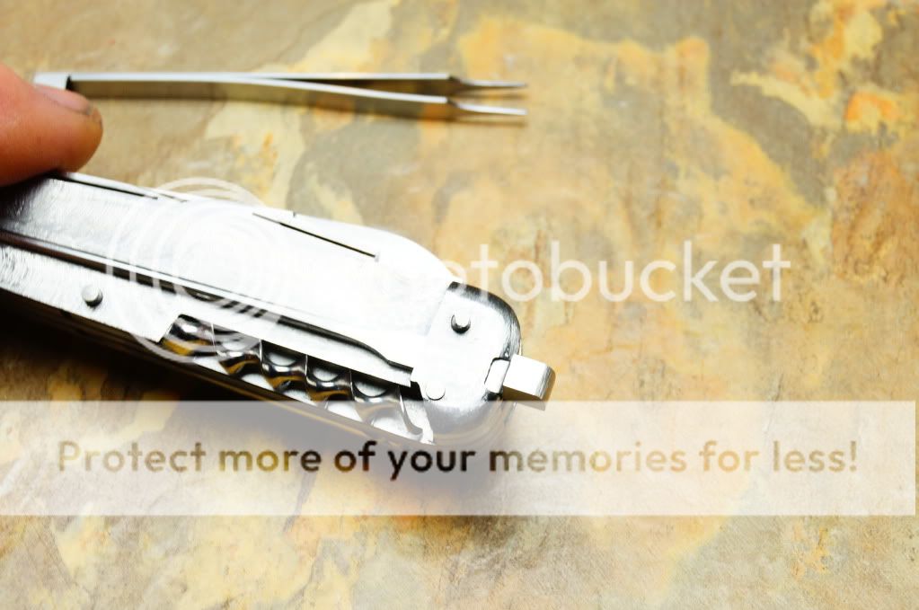

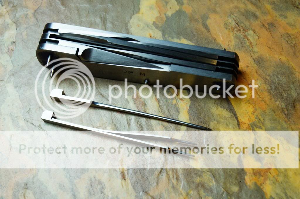

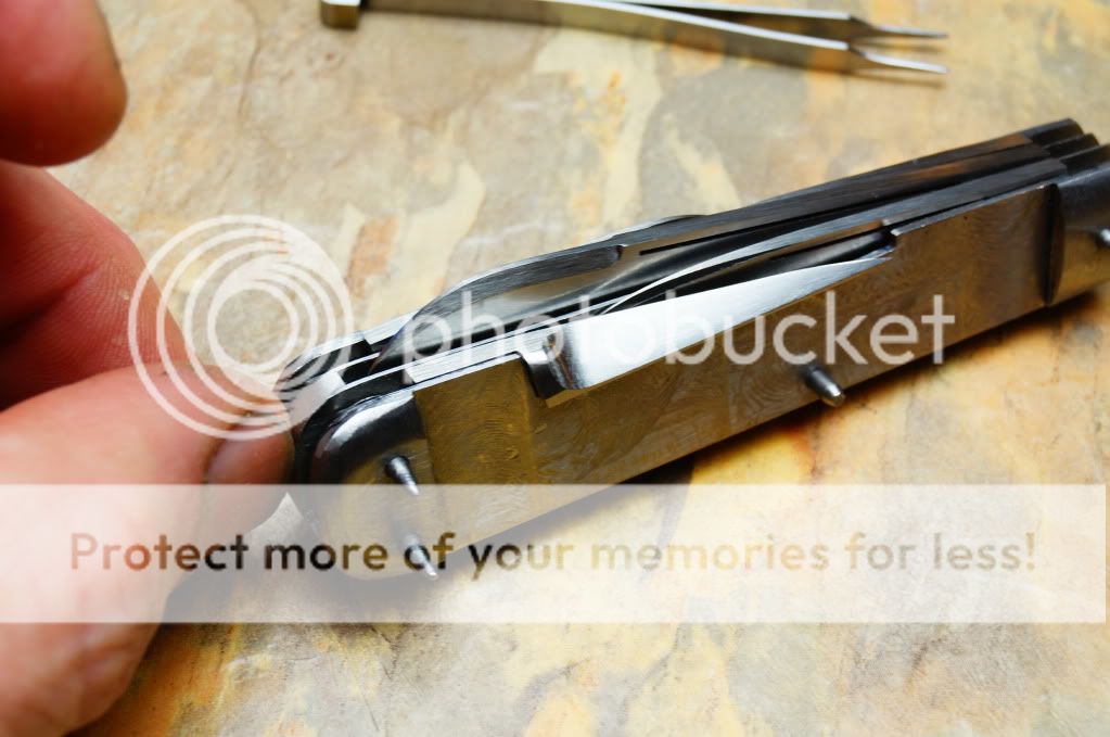

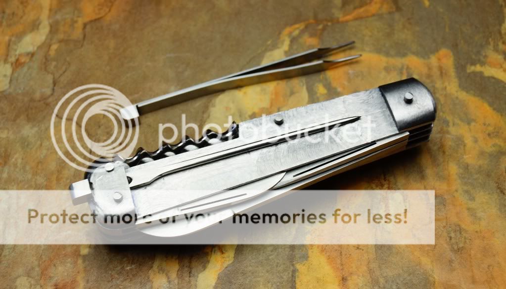

Made some progress on the knife. I was not happy with the mark side frame/bolster to leather punch fit. I had too large of gap toward the rear of the punch, so I re-made the side. I also milled the frame/bolsters for the covers. Elliott had asked were I was on weight. Before milling the frame/bolsters I was at 5 7/8oz, after 4 oz. I would imagine that with the covers I will come in around 4 1/2 to 4 3/4 oz total weight.
I also started to fit the one side for the lancet. I knew going in that this was going to be a time consuming operation as I still have a integral cap bolster. Had I planned on soldering on the bolster I could mill the back side first to form the trough that the slide-out implement needs. What I had to do was drill a 1/16 hole , then enlarge with a tiny dental burr and finish up with some needle files I ground for this job.
If you compare the gap at the rear of the punch in the two pictures I think you will agree that a new mark side bolster/frame was warranted.
My next steps will be to finish the other cap bolster for the slide-out and then start to refine the bolsters, blades and springs. I want to have things 80 to 90% completed before I install the covers. Milling the frame/bolsters really is a big step forward as far as feeling, looking like the finished knife will.

Ken,
What process are going to use to have the toothpick and tweezers nest into the bolster, appears to be a daunting task?
Jeff
Jeff,
I just about have the cut-outs finished on both bolsters now for the slide-outs. Keep in mind that there is extra material at the end of the slide-outs that will be ground away to match the height, length and radius of the bolsters. I should be able to follow up with a picture tomorrow that shows how they will nest with the bolsters.
Ken,
Another question for you is why is there a cut near the base of the tweezers? Sorry I don't know terminology. I remember reading you made the tweezers out of one piece as opposed to how Richard Rogers solders them together?
Kevin
Kevin,
This set of tweezers is the second that I have made. The first set was one piece. This set is two pieces pinned together. I still think I will be making a third set using Richard's method to decide which way I prefer.
Beautiful work, Ken. I'm enjoying the photos. That tweezer is great. The profile of the tweezer reminds me of Dumont No. 5 http://shopping.roboz.com/micro-sci...er-5-forceps/No-5-Dumont-Carbon-Steel-RS-5035
A very nice choice, in my opinion. All the tools/blades look exceptional!
Jake,
Good eye! Ed had requested a "number 5 medical" profile when discussing the tweezers. On the final version, which ever method I end up using, the tips will even be more needle like than what I have on this version, to closely match the number 5 profile.
