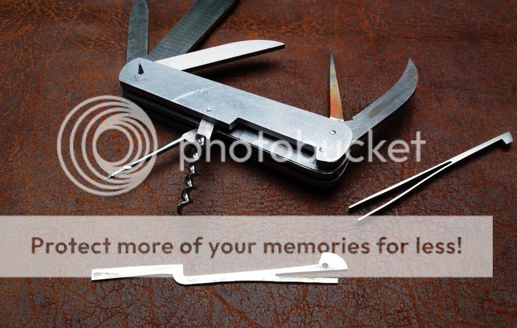

I made some slow progress on the knife yesterday. Refined the corkscrew and the awl. Both are heat treated and close to finished size. If I can find my small tripod:eek: later today I will take a short video of how I test my corkscrews.

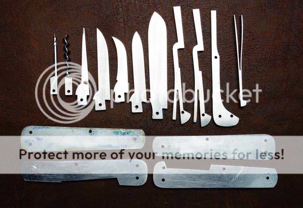

The picture shows my pattern for the two outside springs that work the small blades along with either the corkscrew or awl. I make the pattern out of nickel silver sheet. I have found that the nickel silver has just enough resiliency to act as a light spring. On a spring such as this, this gives me a much better idea of my spring before cutting it out of CPM154. I can eliminate some waste of the more expensive CPM154 and time by doing it this way.

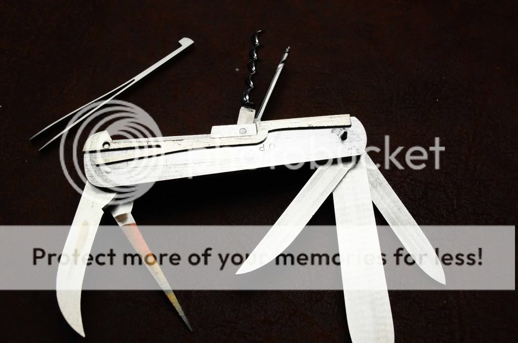

Talked with Ed this morning and worked out a few more details. Still no hard decision on the covers but narrowing it down a bit.
We talked at length about the tweezers and Ed wants to go with a tweezers that is much more pointed. I had figured on making a new set as this one is a tad thick.
We also chatted about the hawkbill blade. I mentioned to Ed that I was going to be reducing the profile to allow a better fit in the frame. Ed was on-board with this as he prefers a smaller hawkbill blade. You may notice that in this group picture the blade is smaller than the previous posts. I have the two outside springs roughed out and ready for heat treat. My next step will be to cut the long pulls on the four blades and get things ready for HT. I still have the lancet to make yet, which may yield a surprise.

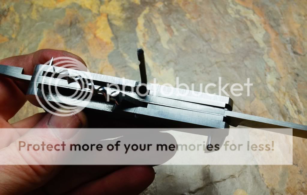

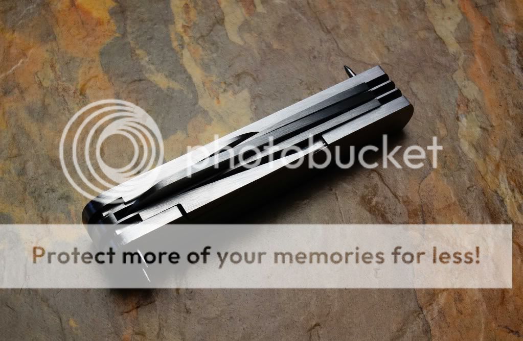

I had a chance to fit up my tangs and springs. Everything is working really nice. I still have a bit of fine tuning of the tangs but very minor at this point.
I did the initial grinding of the blades and they are fitting like they should.
