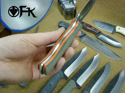

Today was handle day. First I did the rough shaping on the KMG and here's where I started hand filing all of them.
Here's some comparison for you. This is what they look like after rough shaping with the KMG.
And this is what they look like after being shaped with the hand files.
Alright. I didn't take pictures of the sanding part so we're jumping to after sanding was finished
Here they are all together and here are a few goodies that are standing out.
Green canvas micarta over orange G10 and black paper micarta liners
