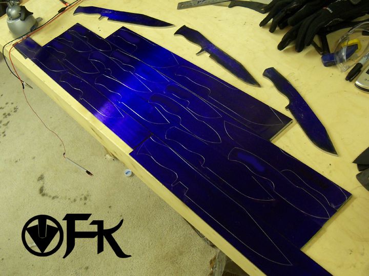

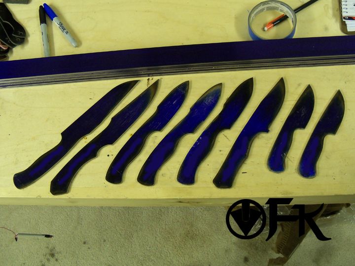

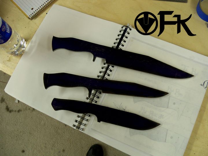

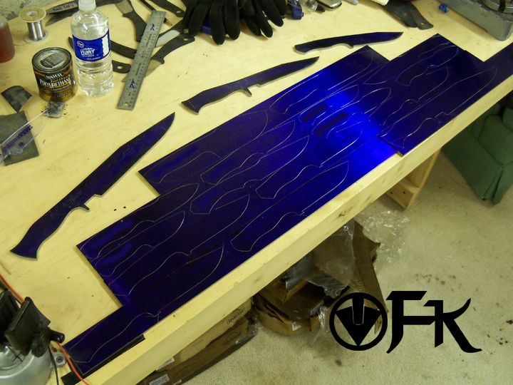

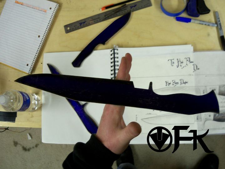

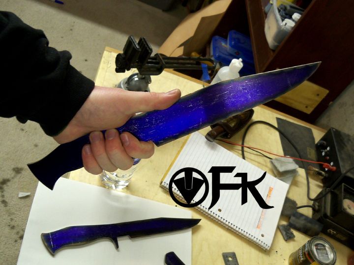

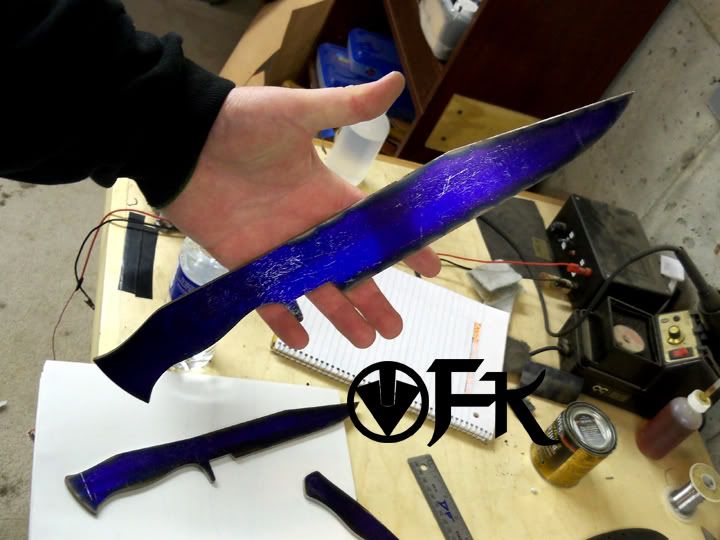

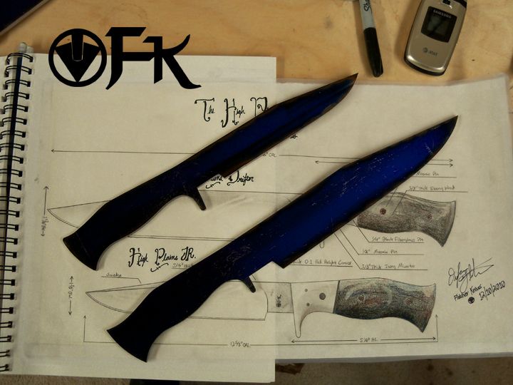

Here is the batch that got profiled today. It has 3 new models in it, The High Plains Drifter, High Plains Jr., and the new and awesome Bush Operator XL.
The Bush Operator XL is SO AWESOME!!!
ETA: Dangit, they are all spoken for? Bummer! Oh, well, got no money anyway! Can't wait to see how they progress!

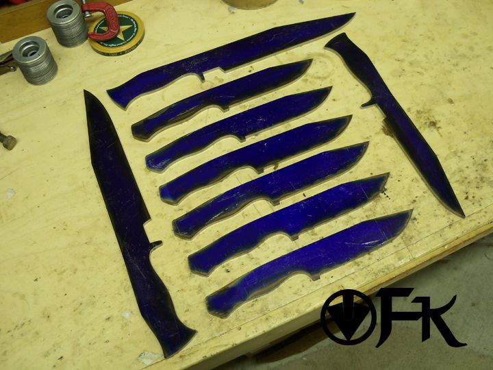

Whatcha gonna do with all that extra steel, Dylan?
I didn't end up with any extra steel of mine. All of mine got scribed and profiled. The extra bars you see on the table in this picture is Andy's

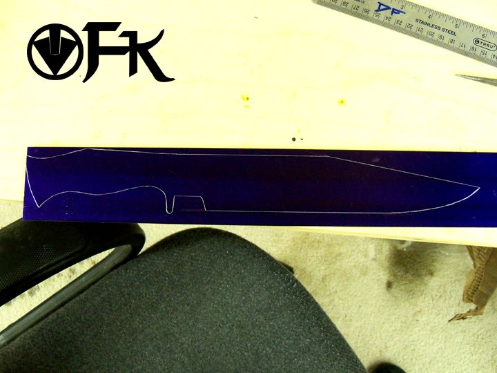

I was also referring to all the beautiful stuff between your knives in this picture:
Ahhhh. Now I got ya. Actually, I'm saving all those leftover pieces. I have something in mind for all of them. Not telling yet though.
Damn! That is a lot of profiling. Are you using a bandsaw?
Nope. KMG. I can do a mid/large size knife every 6 minutes, and a big big chopper every 8 minutes. I think my record is like 45 blades in one afternoon.

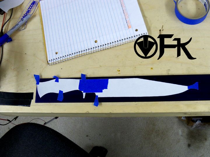

Obviously I'm missing something here, but if you grind down those bars to the right shape with a belt grinder, how do you have pieces left over?
