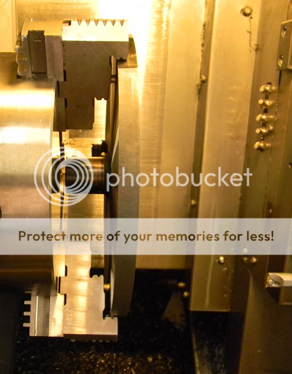

The next step is the most important one. I'm setting up to cut the working face, OD, and then single point bore the ID all in the same setup. Making these cuts without moving anything virtually eliminates any runout on the important surfaces. This is the key to this disk.
Here's the setup, holding it by the outer edge:
13-1.jpg~original
And the finished cut:
14-1.jpg~original

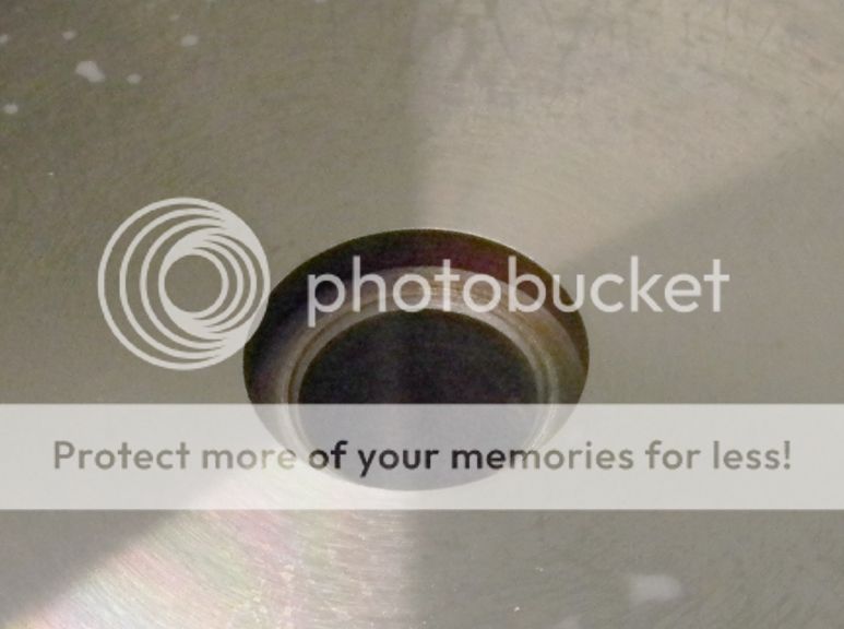

The bore is .6252 nominal with a total tolerance of about half a thou.
15.jpg~original

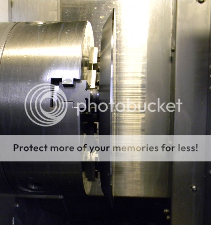

At this point all the precision machining is complete, but I still need to cut the back bevel. I'll need to hold onto the stub to do this, and as you'll recall that stub is just welded onto the disk. Although the bore was single pointed after welding, the OD of the stub was not. So I held it by the OD of the disk with the finish machined face against the chuck and skimmed the diameter of the stub to have a more accurate surface to hold onto for the final turning op.
16.jpg~original

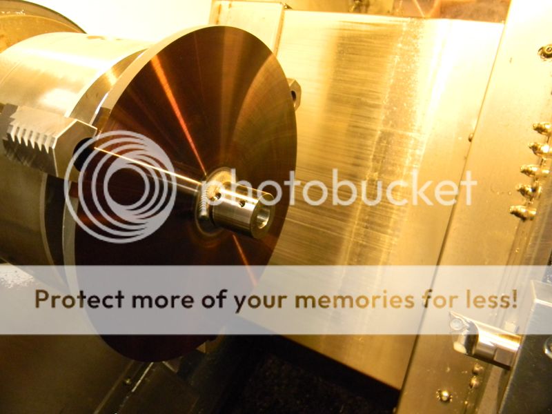

This will allow me to cut the back bevel with better accuracy. Although the accuracy of the bevel is not that important, if it is off by a lot it will effect the balance. I am balancing these, but it needs to be fairly close to start with and accurate geometry helps.
Next I mount a disk by that stub and turn the back bevel:
17.jpg~original
I'm done turning it. All that is left is to balance it, broach the keyway and test in on a motor.

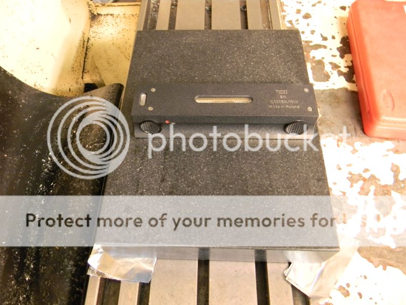

Being a disk rather than something like a shaft it is pretty straight forward to balance. There are a number of different approaches to this, the technique I'm using is commonly used for balancing things like grinding wheels. It is slow but accurate.
This is a technique that any of you can use to balance things like contact wheels, grinding wheels etc. If it is fundamentally a disk shape, this will work.

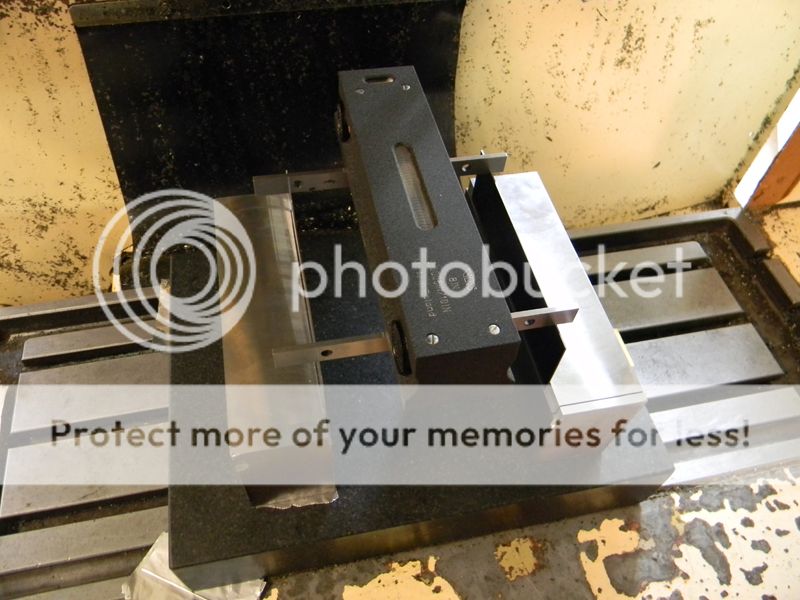

To start I need a flat level surface. I'm sitting a small granite surface plate onto the table of an old small bed mill that is stable and already relatively level. The level is a master precision level with graduations of 50 millionths per inch. They're not too spendy and most machine shops keep one around for measuring and straightening bow and twist from things like lathes. (aside: a "level" lathe isn't necessarily level, it is straight, and you can measure that with a few measurements from a precision level). A sheet of aluminum foil is about half a thou and can be used as a shim to get the plate good and level. With practice this only takes a few minutes.
18.jpg~original

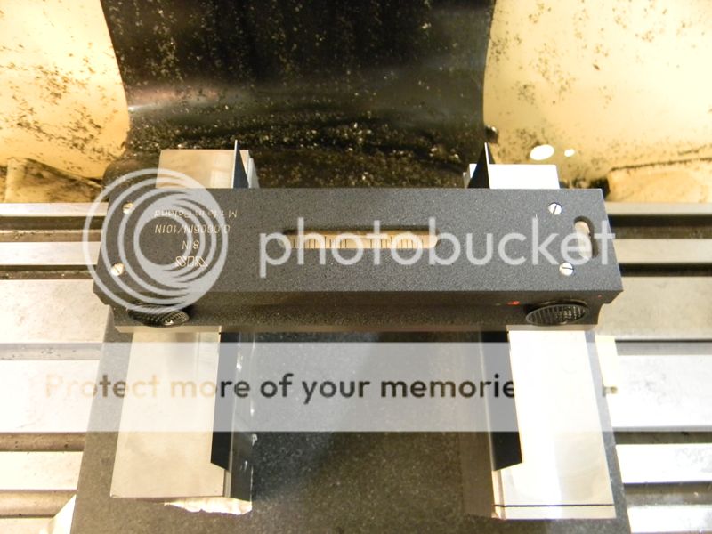

Once the plate is level you need to level a set of blades. I'm using ground precision thin parallels here, but anything that is thin, smooth and precision ground flat will work. First I shim out any twist by measuring level from one end to the other in a series of measurements designed to find the low corners and shim them up.
19.jpg~original
Then I get the "blades" extremely level front to back.
20.jpg~original
My balancing setup is level within a couple tenths. With practice you can set this up to this degree of accuracy in about 30 min.

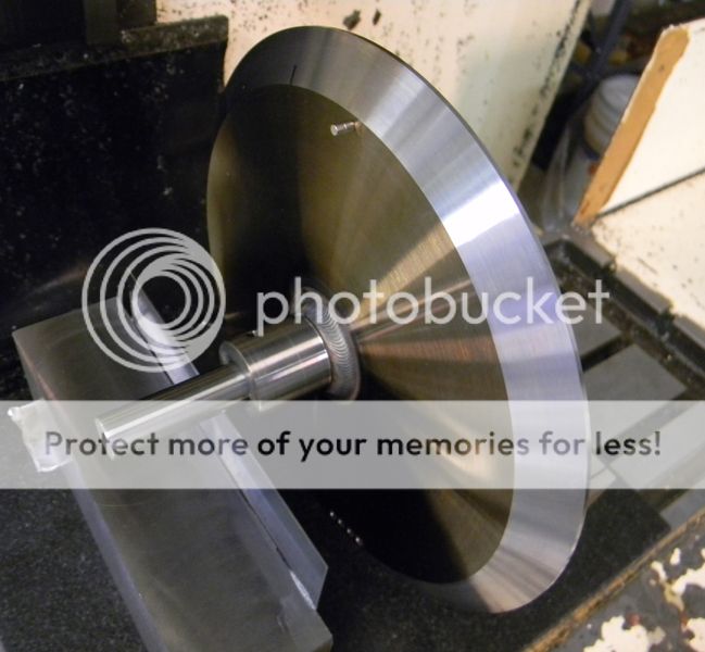

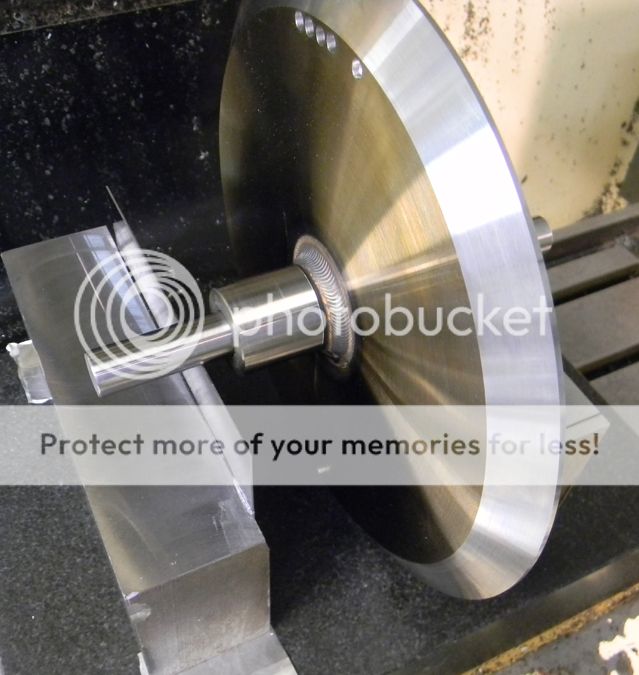

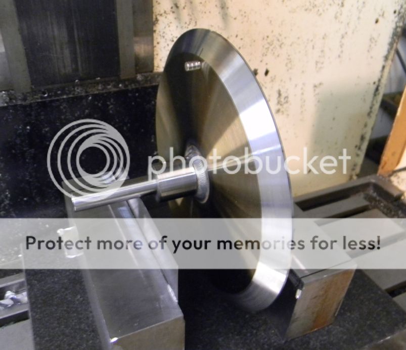

This works on the principle that the heaviest side wants to be on the bottom. It's that simple. However, this is not like hanging a lawnmower blade on a nail to balance it after sharpening, you want much greater accuracy than that. So simply putting the disk on a nail or shaft and letting the heavy side find bottom is far too insensitive, as is mounting it onto bearings or something similar, there's simply too much drag.
This is done by running an extremely straight, hardened and finely ground shaft through the bore and letting things rest on the very level, very smooth thin ground parallels. There is very little drag or friction or bias of any type and the heavy side will repeatably find the bottom with this setup to within a few thousandths of a ounce. In order for this to work your setup needs to be finely finished and everything needs to be straight and level with no dirt, dents or other imperfections that would cause things to hang up.
So I let everything sit until it stops moving. This takes a few minutes. Once it has settled down I mark the high side with a sharpy. Then I start adding weights to it. I start with my "large" weights which weigh 3/4 of a gram until I find the mass that flips the disk around.
21.jpg~original
I have a drill mounted in a Bridgeport and I've set the stop on the quill so it drills a hole that removes an equivalent amount of steel as the weight of one weight. So, if a disk needed 5 weights to come around I drill four holes. Then it goes back onto the balancing setup for a finer adjustment. This time with weights that weigh .19 grams.
22.jpg~original
I repeat the process until it is level enough that a .19 gram weight will pull it around to the bottom regardless of where that weight is added which tells me I'm balanced within 30 thousandths of an ounce inch.
23.jpg~original
The balancing could be taken finer still, but let's be honest, most folks aren't going to be running these on ABEC7 super precision bearings, and any little amount of runout you have on the spindle in your motor that shifts the axis of the disk away from the axis of rotation is going to affect your balance more than this.

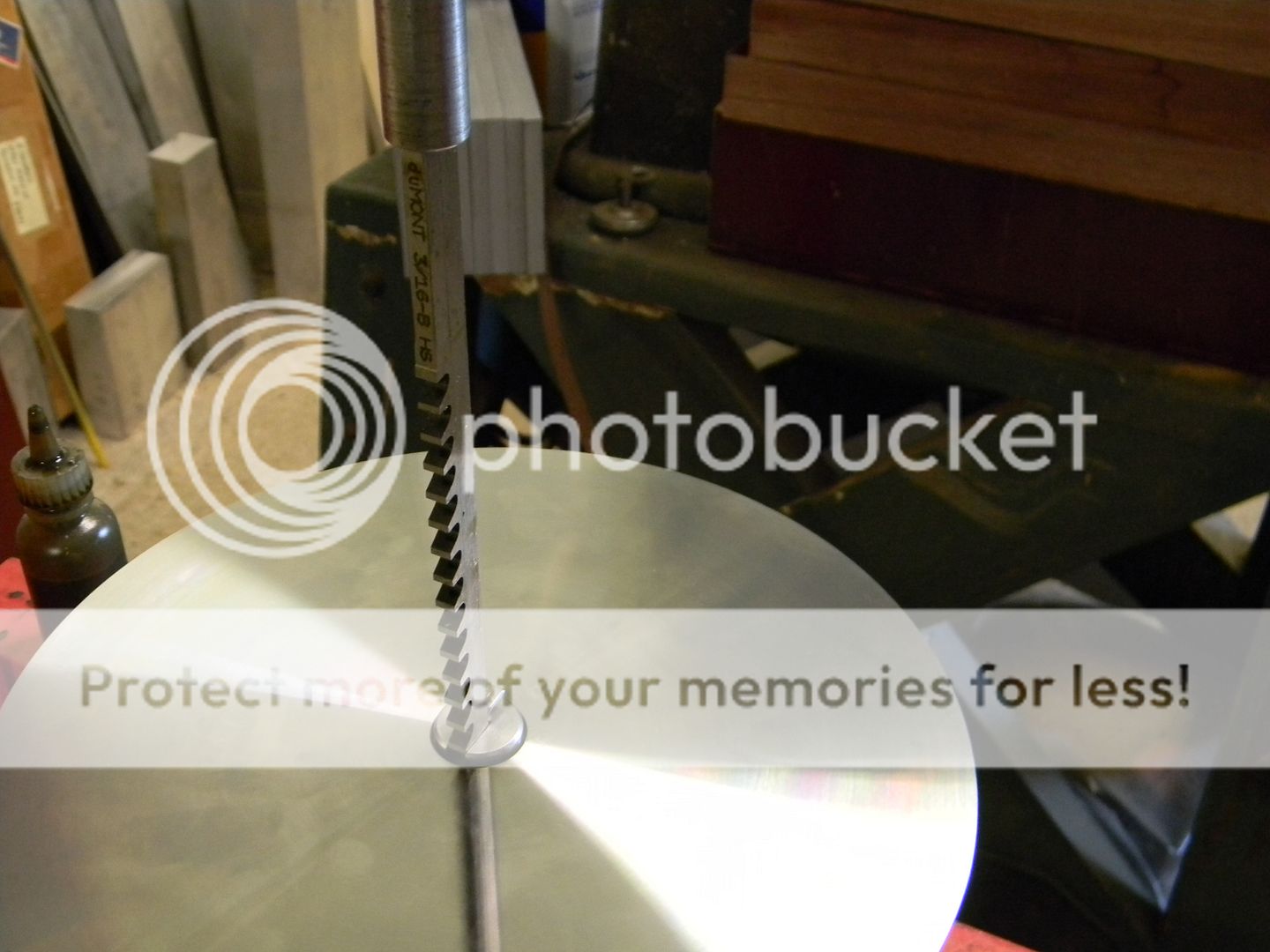

The next step is broaching
24.jpg~original
Broaching is not rocket science.
I'm balancing before broaching because the material removed in broaching is similar to the material added by the key. The key is generally slightly less, but there is also the added weight of the little set screws, which I think makes it a wash given the small random variations there will be from one person's setup to the next. Given how close these are to the center of rotation the effect is not that great regardless. I tried it both ways and experimented with adding small weights on the same side of and opposite to the key and found that balancing before broach worked a little better.

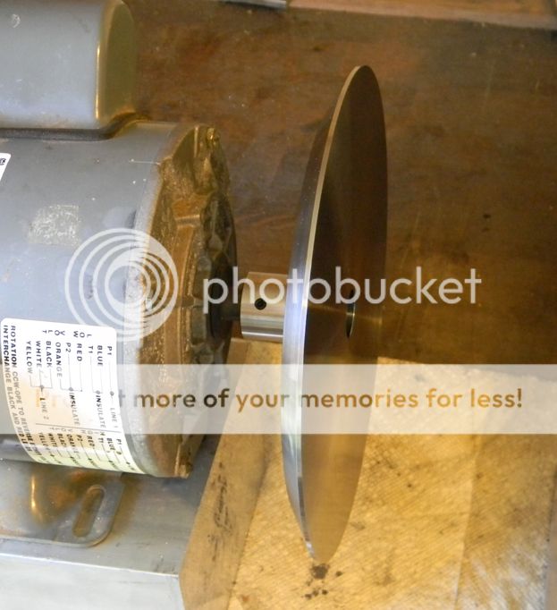

Nathan, or whomever can contribute, what would be the ideal setup for this disk in order to achieve its maximum potential and reduce the chance for runout? From what has been posted, removing the motor and using an arbor such as the AR17 that Bladsmth posted, would decrease/ eliminate runout. But, how would one set up the motor and arbor? Are there any examples (pictures) of the ideal setup for those of us who are not as "mechanically," inclined.
I know this is asking for a lot but after attempting quite a few google searches, I've come empty handed and thought it more prudent to ask a real machinist anyway. :) Thanks in advance.
here are mine, I use the horizontal one with a lapping compound applied directly to the disk. they run smooth as silk.
