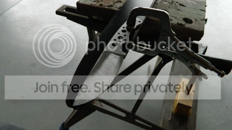

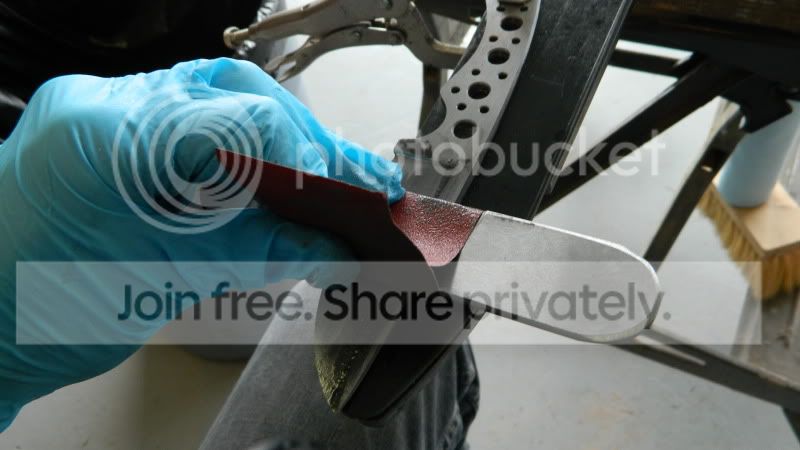

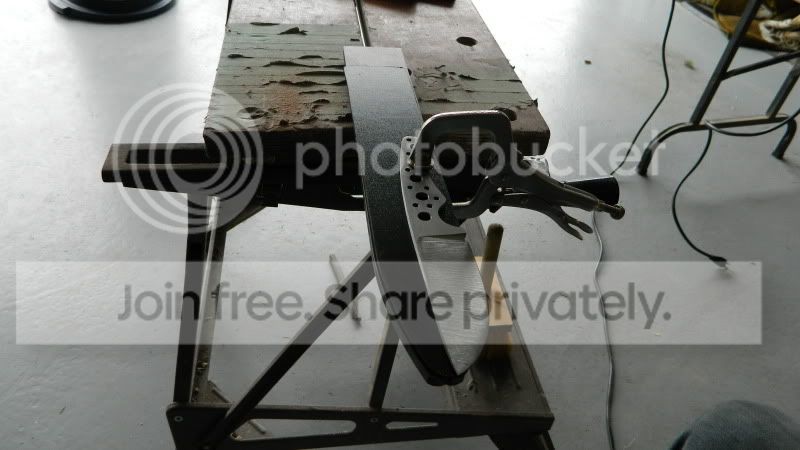

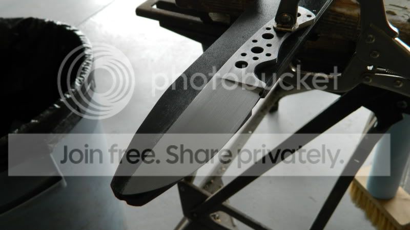

Here is my current set up, thanks to a Nick-Wheeler type sanding jig from Carl!
I have a piece of kydex laid over top to prevent scratching of the blank when it it clamped down to the jig.

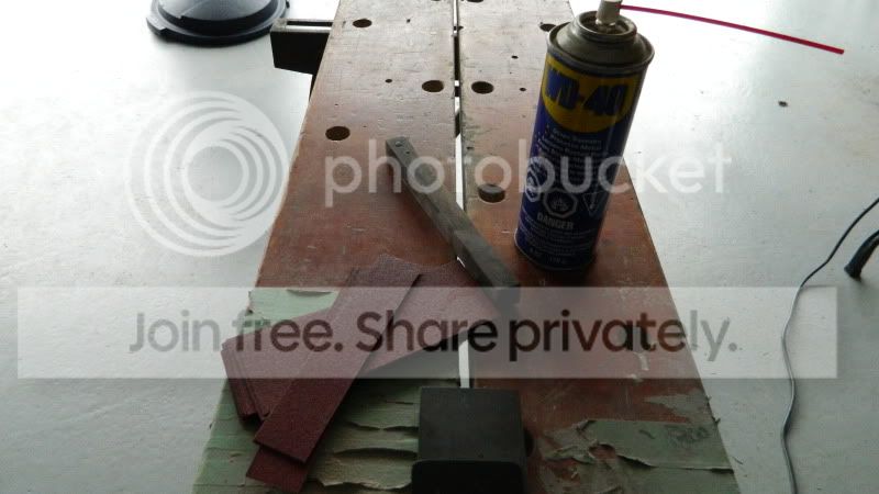

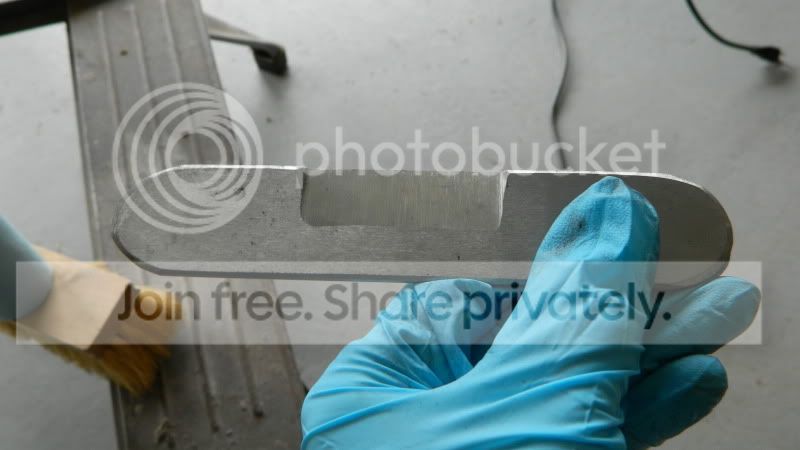

And here is some 120g Rhynowet, trusty sanding stick, and some good old vitamin-WD.
About 20 minutes later we have the majority of the grinder scratches out, with mostly work on the plunge left
I thought it was time I switched from my wooden sanding stick to something a little more square and rigid. I had some scrap PG-O1 barstock, so I decided to grind up a new sanding stick for myself.
This thing worked wonders, getting into the plunges and keeping them sharper than they have ever been. Always improving :thumbup:

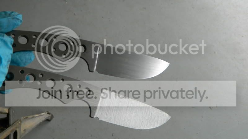

About 45 minutes later and we have this! The whole blade finished to 120grit
Here is a little "before and after", showing one sanded and one not-sanded for comparison.

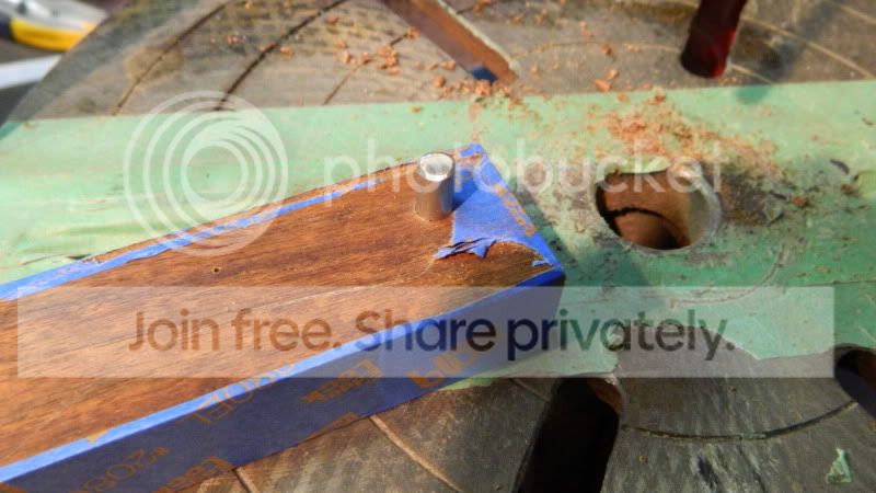

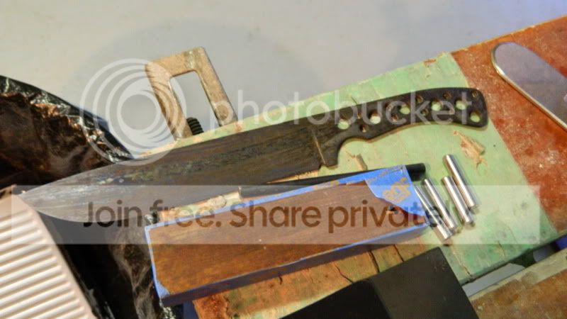

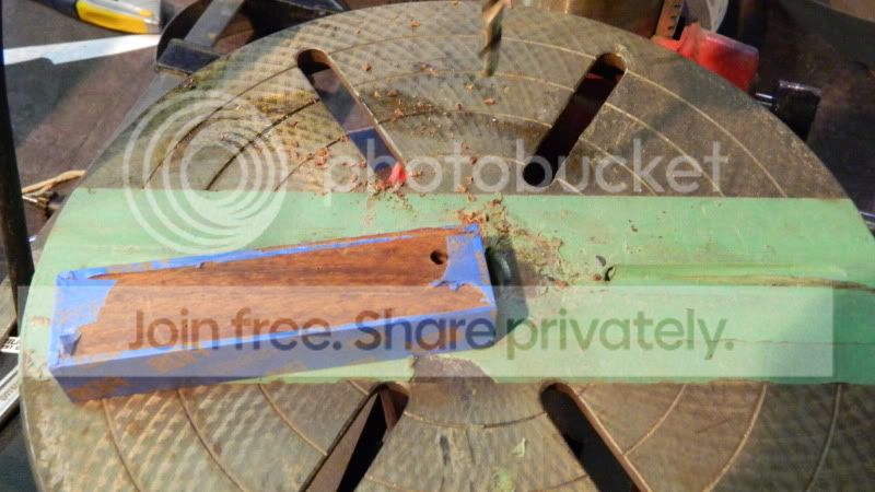

So here is how I like to do my slabs (I don't know if there is a better way... probably is... but this is how I figured it out ;))

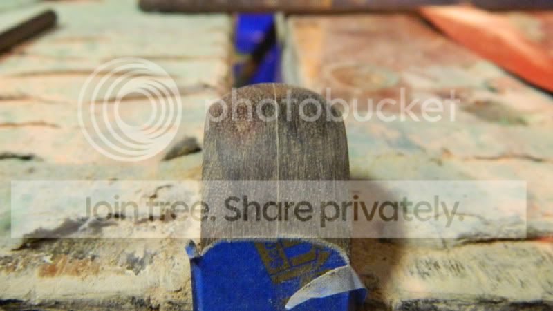

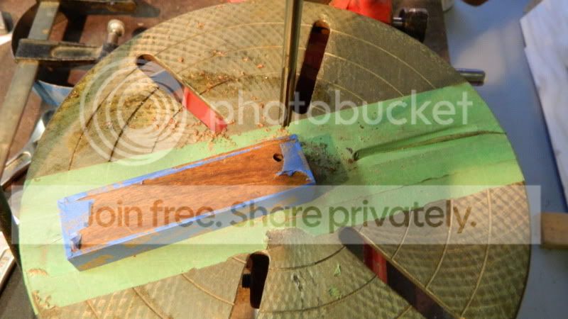

I get them precut into scales by Mark at Burlsales, and end up with a really nice bookmatched set. So to keep the grain all lined up, I throw some blue painters tape around the outside so it is like a block once again. Then I lay my blank over the scales and position it so the grain flows how I like, and then take a centre-punch and mark out where my holes will go.
I drill the first hole undersize with a 7/32" drill bit.
Then ream the hole to 1/4".
Check the pin for fit... and it is perfect. Needs a little tapping with a rubber mallet to go in, just the way I like it!
At this point, I double check the alignment of the other holes. There is NOTHING worse than drilling a second hole, going to check the fit, and finding out that you were just the tiniest bit out of wack... and the scales are junked.
I also always do the front and back holes first. I find it much easier to make sure things stay lined up when I'm doing the middle hole. Doing 3 in a line seems to have a tendency to screw up a lot more easily, and you get much less margin for error.
Thankfully, since I went slow, I didn't foul anything up this time. This is why I always drill tang holes for 1/4" pins at 5/32" ;)

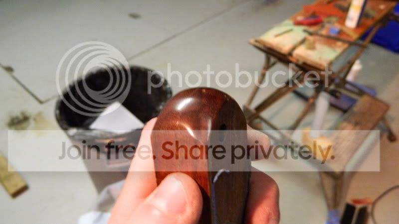

Now to round the front of the scales... all the way up to 400g (120g in the picture I think) Then a quick buff with pink scratchless. This wood has some very 3d characteristics... I'm loving it!

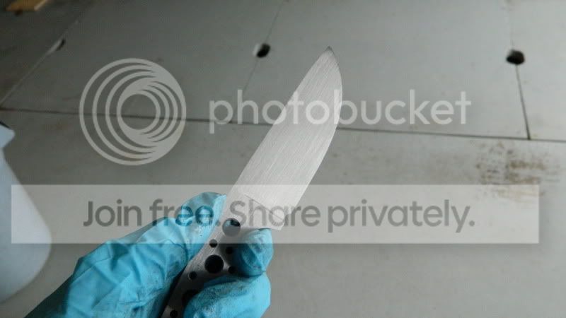

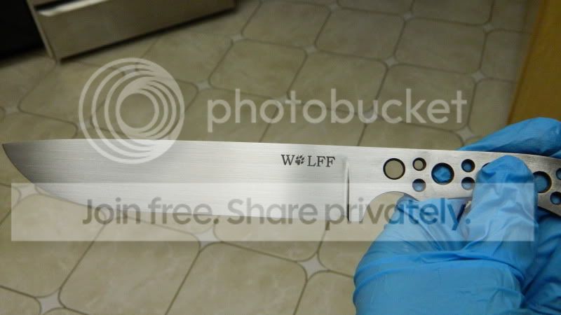

And now finally... cleaning the blade up post-ht. Cleaned up very easily as I left a nice and clean 400g finish pre-ht. This one went up to 800g, then back down to a clean 400g satin.

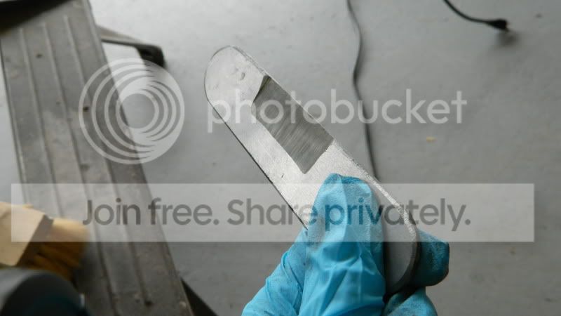

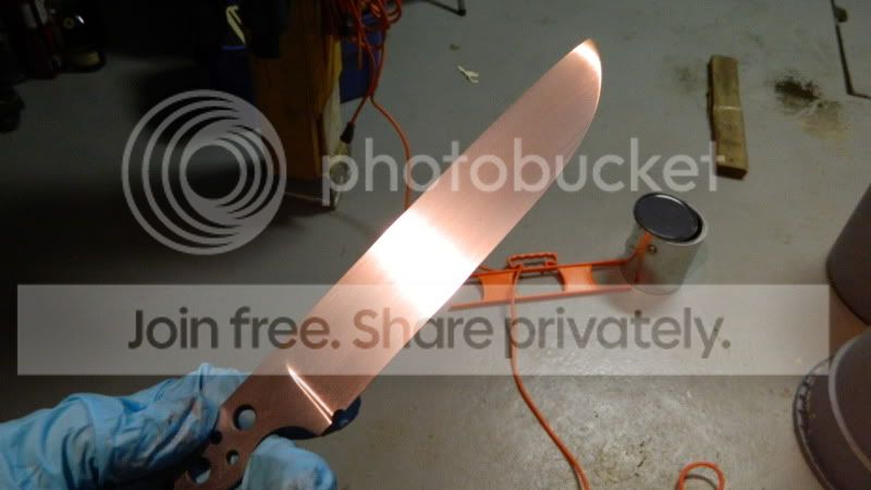

So I did the logo etch today. I seem to be getting better at it, this one is particularly crisp!

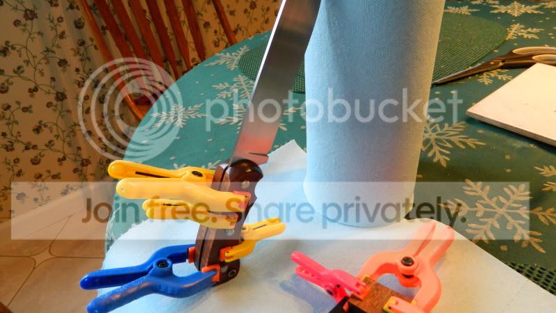

So to attach the scales, I use a 24 hour slow cure epoxy from kmstools. It seems to have plenty of strength, so I will use it all up and then probably go for some west-systems like most of you guys do.

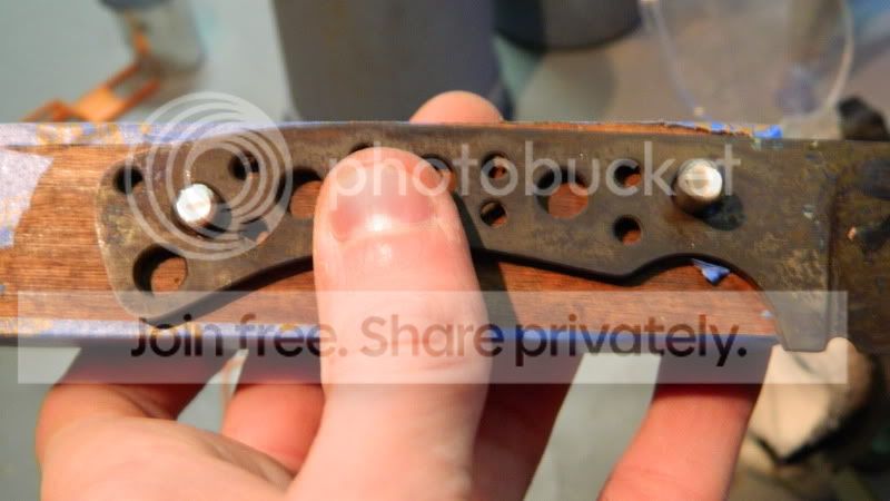

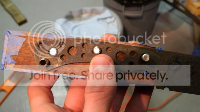

With the intent to make my handles even stronger, I decided to cut slots into my pins with the bandsaw, to give everything a little more surface area to grab onto.

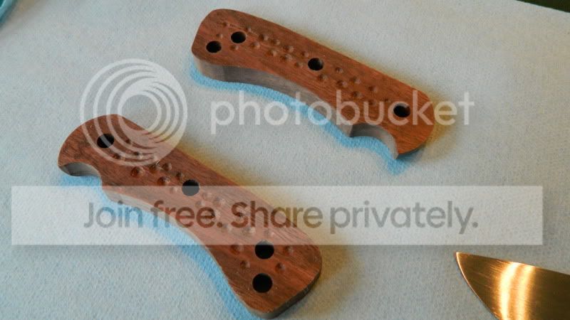

I also drilled out some divots down the middle of the scales like I usually do, more surface area again.
And here we are all epoxied up. Always keeping plenty of acetone around to clean up seepage near the ricasso. I do a major cleaning, then come back in a few minutes to make sure no more has squeezed out (there almost always is some more clean up to do) and repeat a couple of times until I'm satisfied with no epoxy line.
