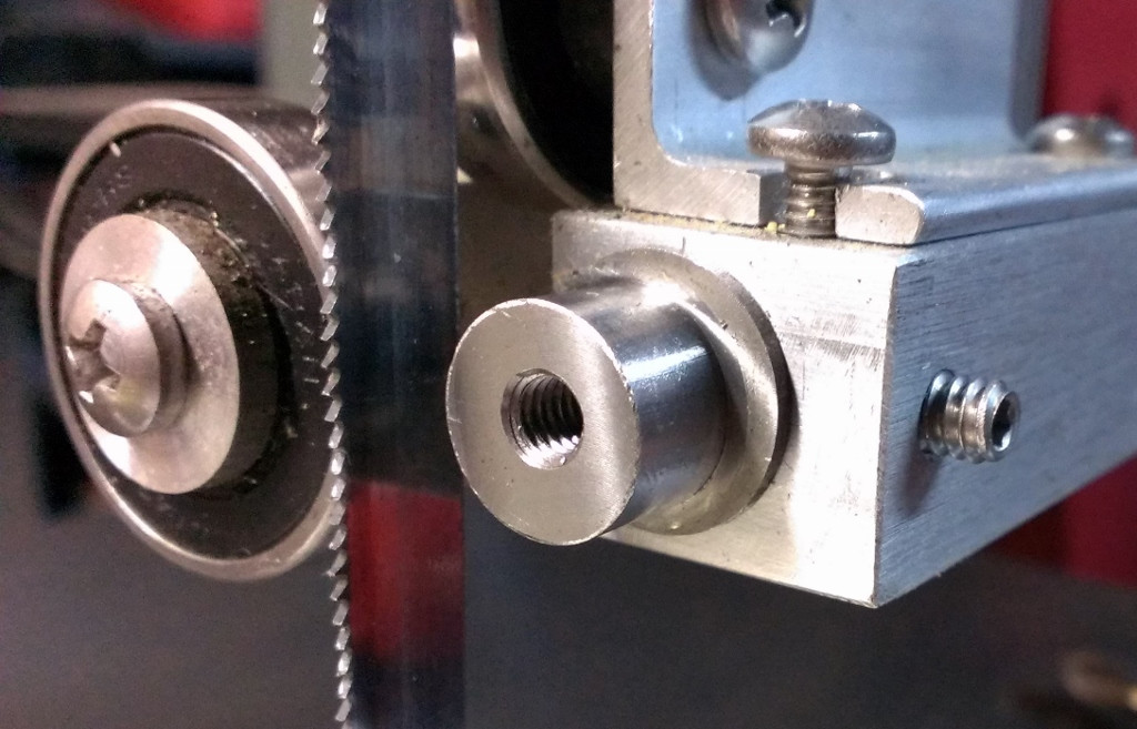

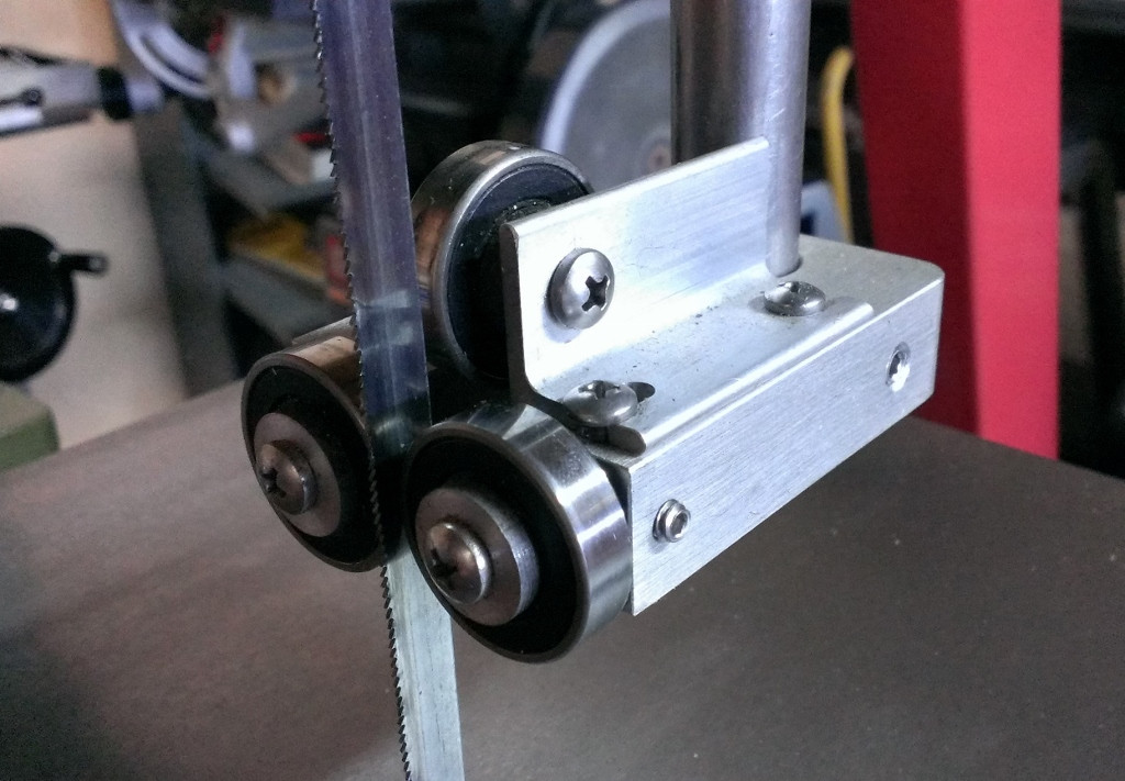

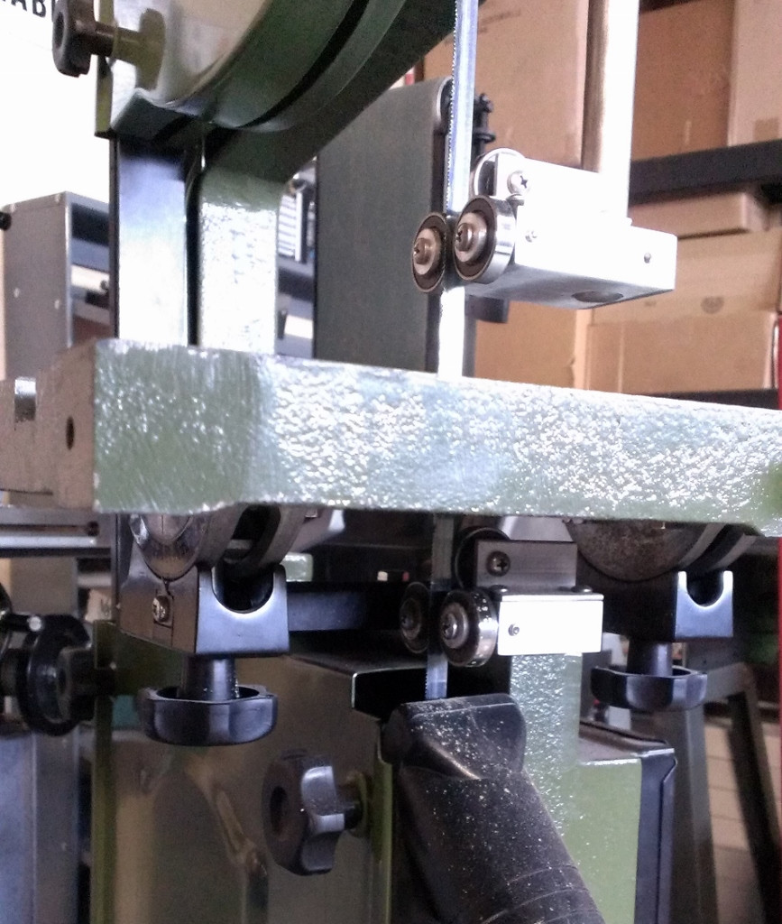

I refitted my 14" harbor freight bandsaw with home made ball bearing guides for metal-cutting. It's passable on the slowest speed (still on the high side for ferrous metals), so I need to source a gear motor for it as shown in the OP, or at least change a pulley. It works well as long as you keep the limited ability in mind. The guides are fairly easy, you just need access to a rotary table on a mill or a four-jaw chuck on a lathe to make the offset pivots for the side bearings.

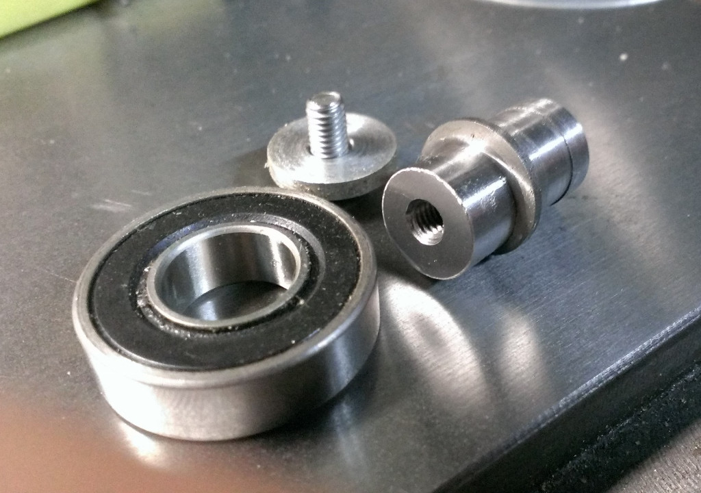

I had some spare time waiting on UPS today, so I took apart the bearing/pin assembly and took a couple pics for you, in case you're feeling adventurous.
I'm pretty sure the pin is 304SS. The shallow groove in the rear of the pin makes sure that the pin doesn't get stuck if the metal gets marred by the set screw, and it also retains the bearing/pin assembly when the set screw is loosened for adjustment.
The lip on the pin spaces the bearing from the guide body and locates the pin within the socket.

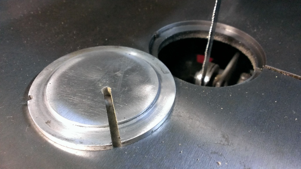

This is another modification I had to make but forgot to mention... the stock blade insert was a (very poorly) molded piece of plastic, it was absolutely abysmal. I machined this out of some aluminum plate scrap. A solid blade insert will increase blade life, reduce chances of breakage due to pinch, and generally make life much easier.
Thanks for the additional pic, I really appreciate. I will do the bearing conversion. And the insert on mine is missing so I will make a similar one. Of course it will surely not look as good as your does.
