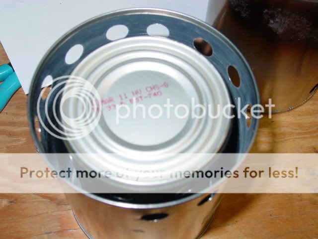

could you post the pics of the cans before you assy them? I wonder how those stoves considered by the ranger when you use them backpacking
Sasha
I will have to wait until I build another this wekend.
Very cool! This type of stove is new to me. This may be a stupid question but can you describe the process of starting the initial fire inside the stove? Do you just build a small fire in the bottom of the inner can? Im guessing up to pencil thickness pieces of wood? I think I might try to make one of these. :)
Hi Valcast1, That pic you posted for Bushman5 Is all i needed, Thanks. How long does the wood burn in there before you need to add to continue cooking??? I watched some you tube and the ones that have the fan installed burn like a torch.

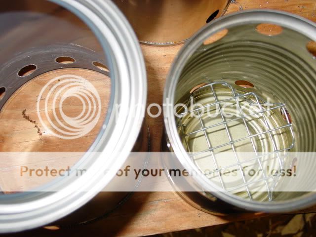

Hi Valcas1. You motivated me to try to build this one, another based on this design but smaller, and a few alchy stoves.
The alchy stoves failed. I used the penny design based on the heniken cans. I just couldnt get them to seal properly. I could get them to stay lite, but they never blossomed.

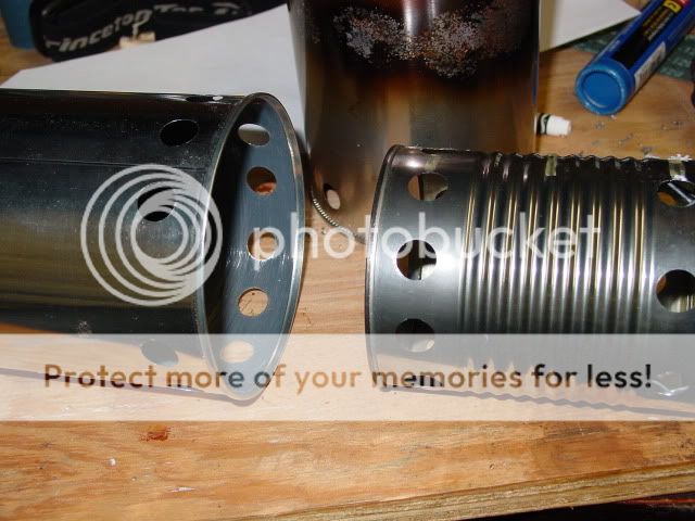

With your stove, I had to get a can and hammer it down into the 1 pint can. But after seeing yours, I have a question. Is the can that is inside the 1 quart can have the bottom cut off? Cause I didnt do that and while my stove will keep the coals smoldering, it wont stay lit.

The inner can is not cut out on the bottom. Just the outer qt. paint can is. Maybe the following pictures might help.
I would say that the problem you are having has more to do with the amount of holes in the cans. It doesn't look like you are getting the proper airflow. Just a thought. Hope this helps.
How's your stove working so far ?? Have you figured out how many half inch holes you needed for it to operate properly ???
Tuxdad, all my test burns have been done with just the four half inch holes and I have been very happy with them.
