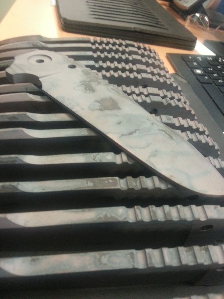

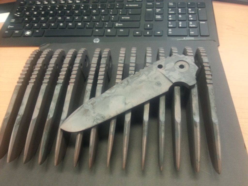

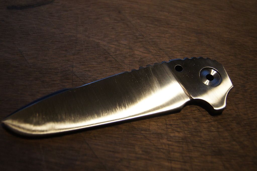

OK that magical time has come! The blades are back from heat treat! Over the next few days I will be hand sanding these bad boys to perfection. I'll keep you updated on my progress.
Here they are fresh out of the oven. Some scale and a slight pink tint. RC 61 verified.

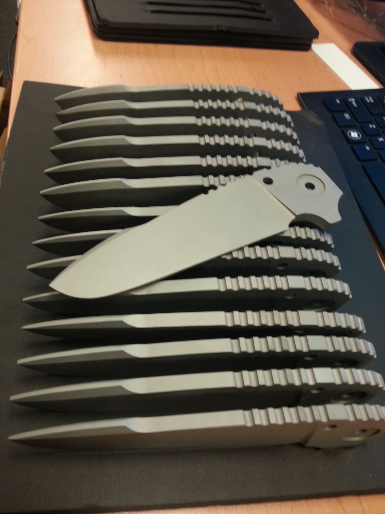

Here I sand blasted them and they look BEAUTIFUL!

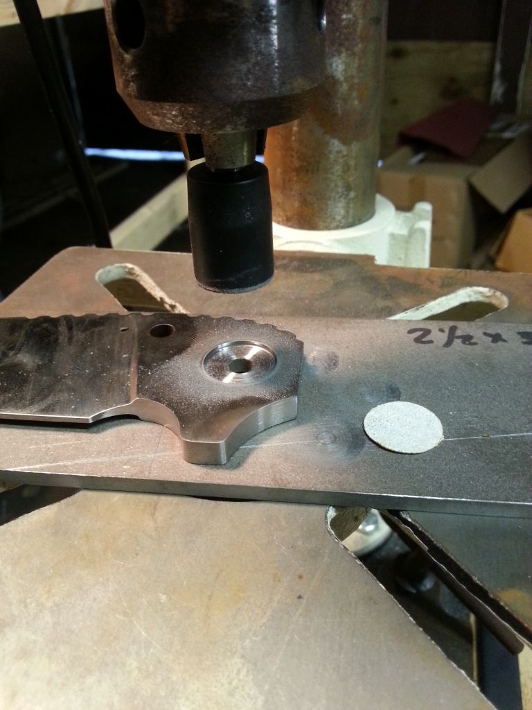

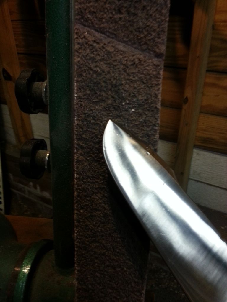

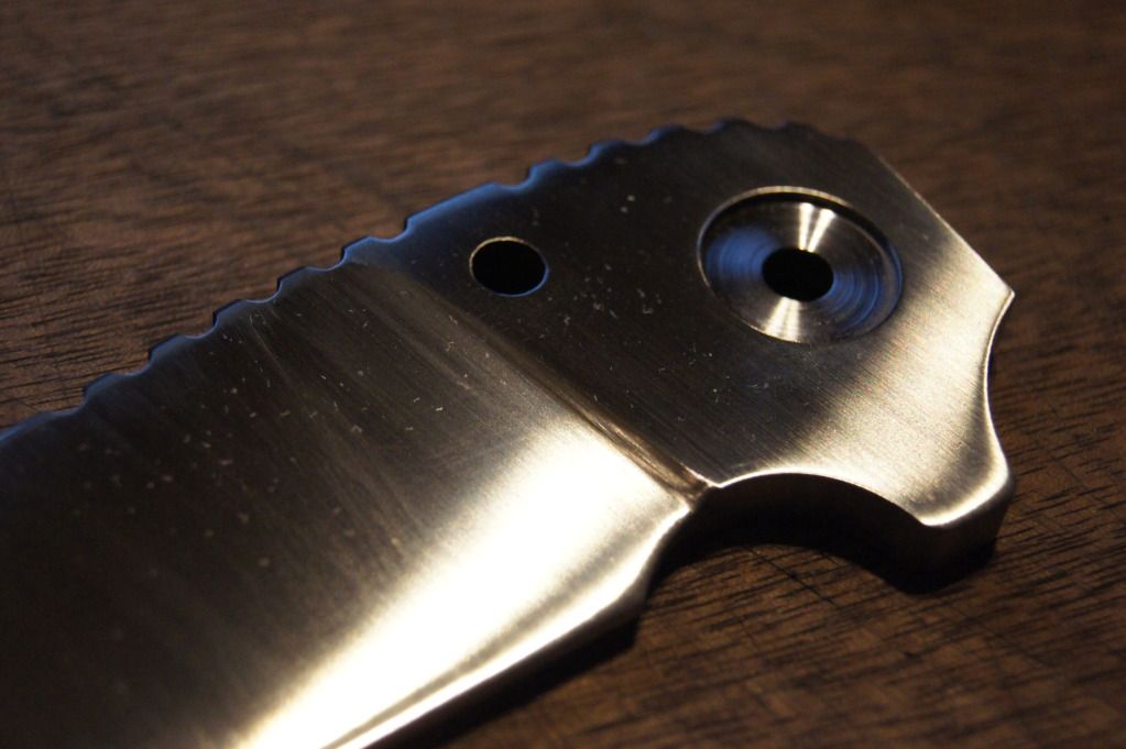

Afters last nights 36 grit frustrations I melted away all my problems with my favorite tool, the Non-Woven Norton Bear-Tex belt. The medium belt is about a 120-150grit and it makes everything so smooooth, no burrs and no random gouges. I also polished up the bearing pockets to make the flipping even better.

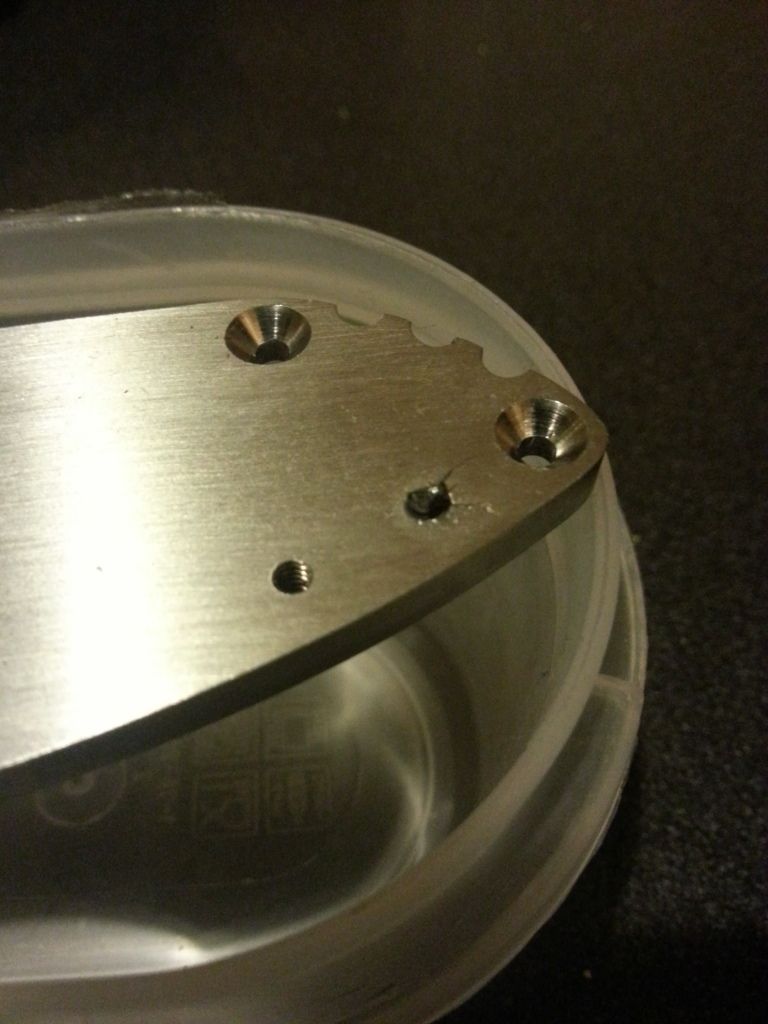

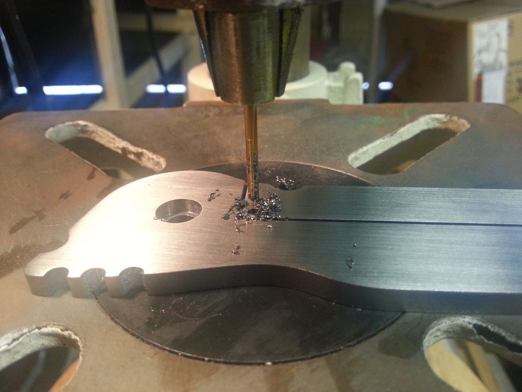

Well today was a lovely mix of accomplishment and me cursing. Got a ton of reaming done to get the pivots just perfect, no slop, just a silky interference fit. I also drilled out the ball detent holes to spec. I set up my tapping station to tap the titanium to accept the 4-40 flat head screws that fit the standoffs and pocket clip in place. All holes are drilled with a #43 single fluted carbide bit, to spec. Added a little tapping lube aaaaaaand SNAP!
:grumpy::mad::miserable::livid:

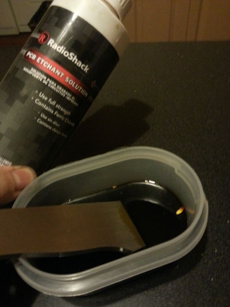

Broke the damn tap. I took a breath got out my extra rainy day 4-40 taps aaaaand SNAP. Broke 3 before I gave up. Thank GOD this is titanium and all I have to do is soak the handles in FeCl overnight to dissolve those little bastards out.
I jumped on McMaster-Carr and rush ordered 3 Cobalt Steel Spiral Flute Taps (I better not break these they cost $35 a piece:eek:) I also ordered solid carbide #42 and #41 drill bits to open up the tapping hole a tiny bit and stop breaking my damn taps. Now all I have to do is re drill 60 holes. Well some days are better than others.
I have a feeling these fancy taps and a larger hole will conquer this problem ASAP.
